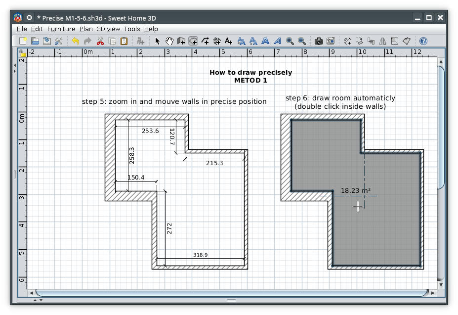

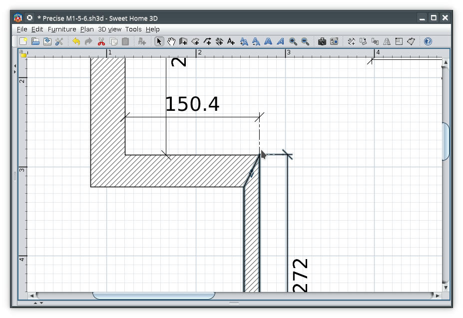

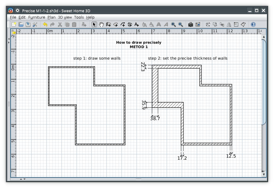

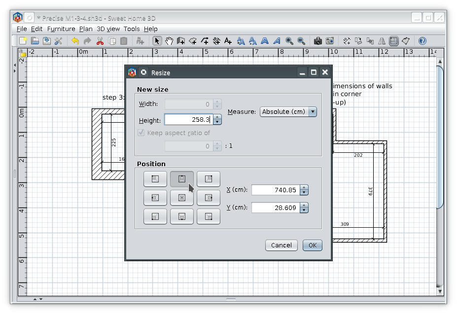

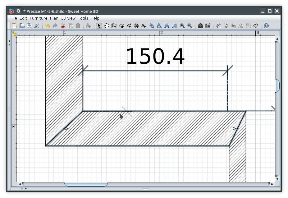

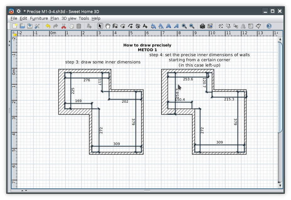

I want to share my method to draw precisely.
I use it mainly for existing buildings where surrounding rooms with walls are not an option wile walls could have different thickness.
Set the precise dimensions
Zoom in and mouve walls in precise position
I use Advanced Editing plugin.
Note 1: For high accuracy use high zoom
Note 2: The accuracy is at least 1mm with this program which is enough for any one who want to build a house and not a space shuttle.

these screen shots are out of the Advancing Editing Plugin, right?
[Aug 20, 2022, 2:20:55 PM] Show Printable Version of Post    View Member Profile    Send Private Message [Link] Report threatening or abusive post: please login first  Go to top
dorin
Romania
Joined: Apr 24, 2014
Post Count: 676
Re: How to draw precisely -mini tip
You got me!
