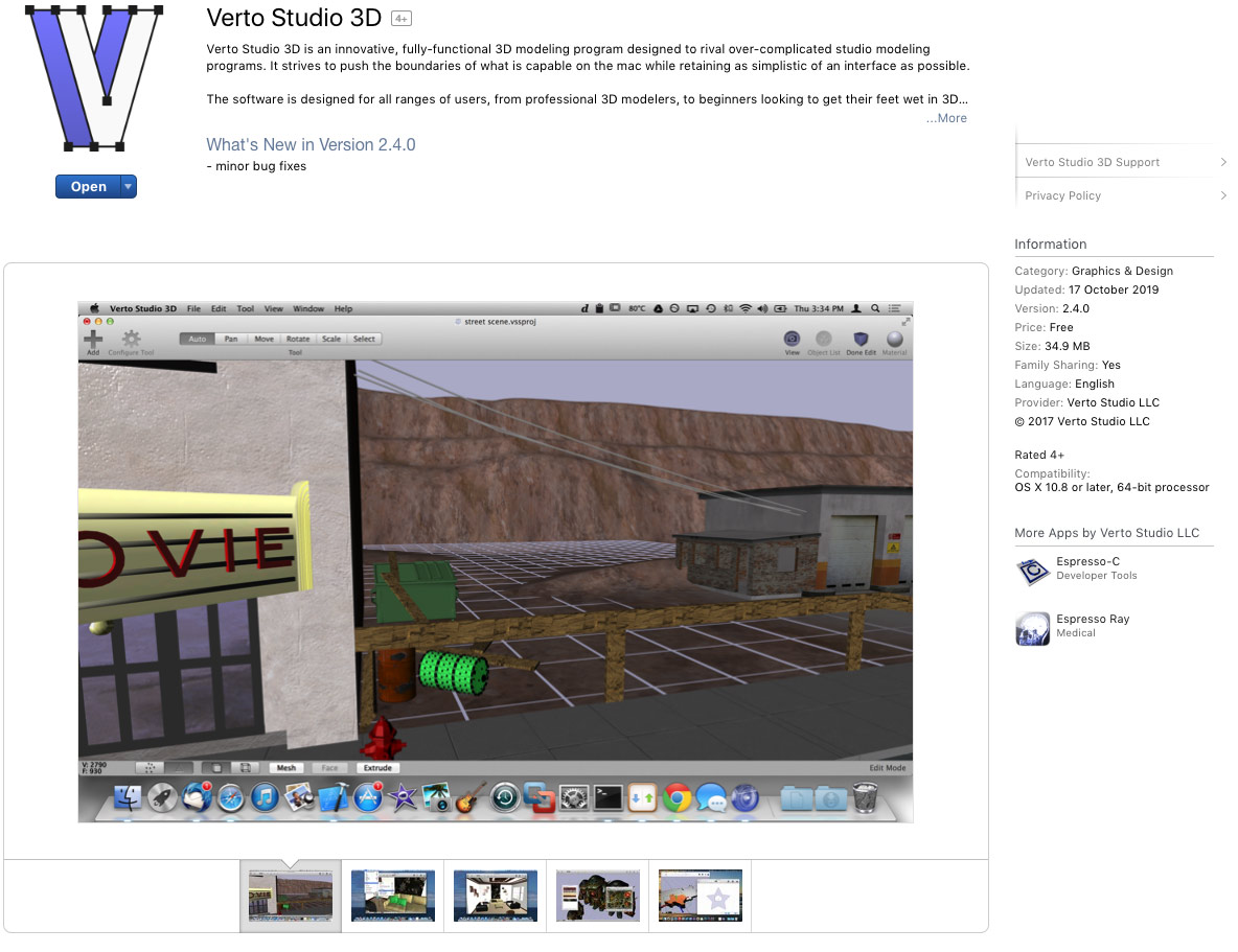

Import to Verto Studio 3d ( free program) and export obj. file.
Problem solved.
You can probably do the same with Blender, also free.

If you are working on a Mac or iPad, Verto Studio is still free.
The Windows version is no longer free. Sorry.

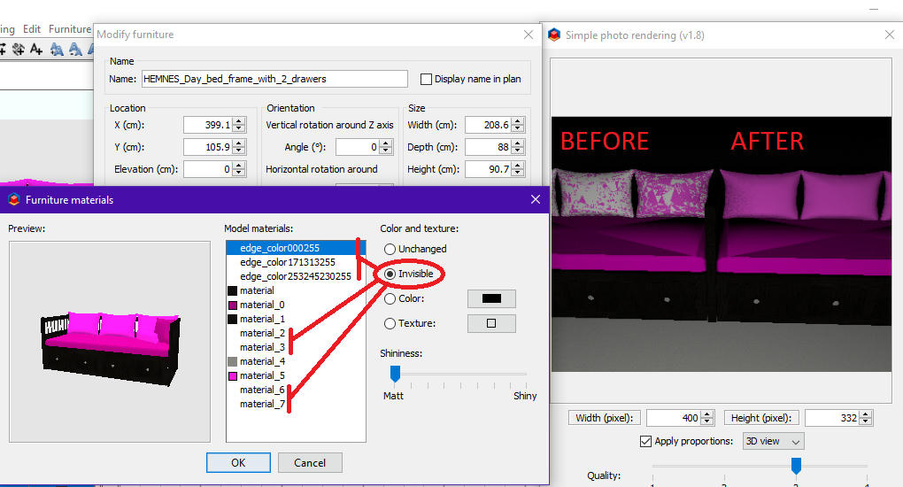

Make material on back faces of your model invisible.

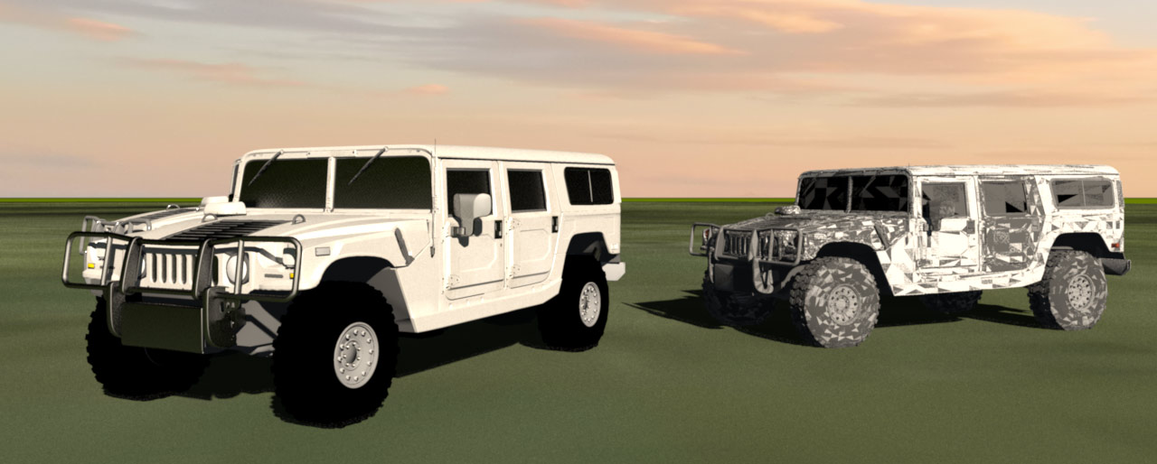

Works sometimes.
See if you can make it work on this: Hummer-no-black.zip

Re: Graphic issue - any hints?
https://vertostudio.com/desktop.php
This link takes you to the download page. For Mac it points to Appstore, where the app is free, for Windows( Linux/others, I don't know, since the website obviously sees what platform is making the request, and leads me to Appstore.
The tip with making surface invisble doesn't worked.
Blender is an idea, I will test it in the next few days. Thanks.
