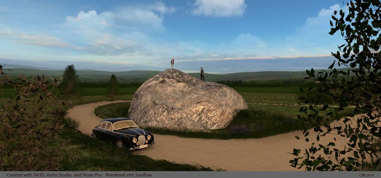

When I grew up, we used to have a fairly big erratic at the bottom of our garden. It reached about one meter twenty above the ground.
No one ever bothered to investigate how deep in the ground it was buried, so theoretically it might be even bigger than Damestenen, since all we could see was just the tip of the ice berg.
I loved sitting on top of it and listen to my fathers old cassettes on my Sony Walkman.

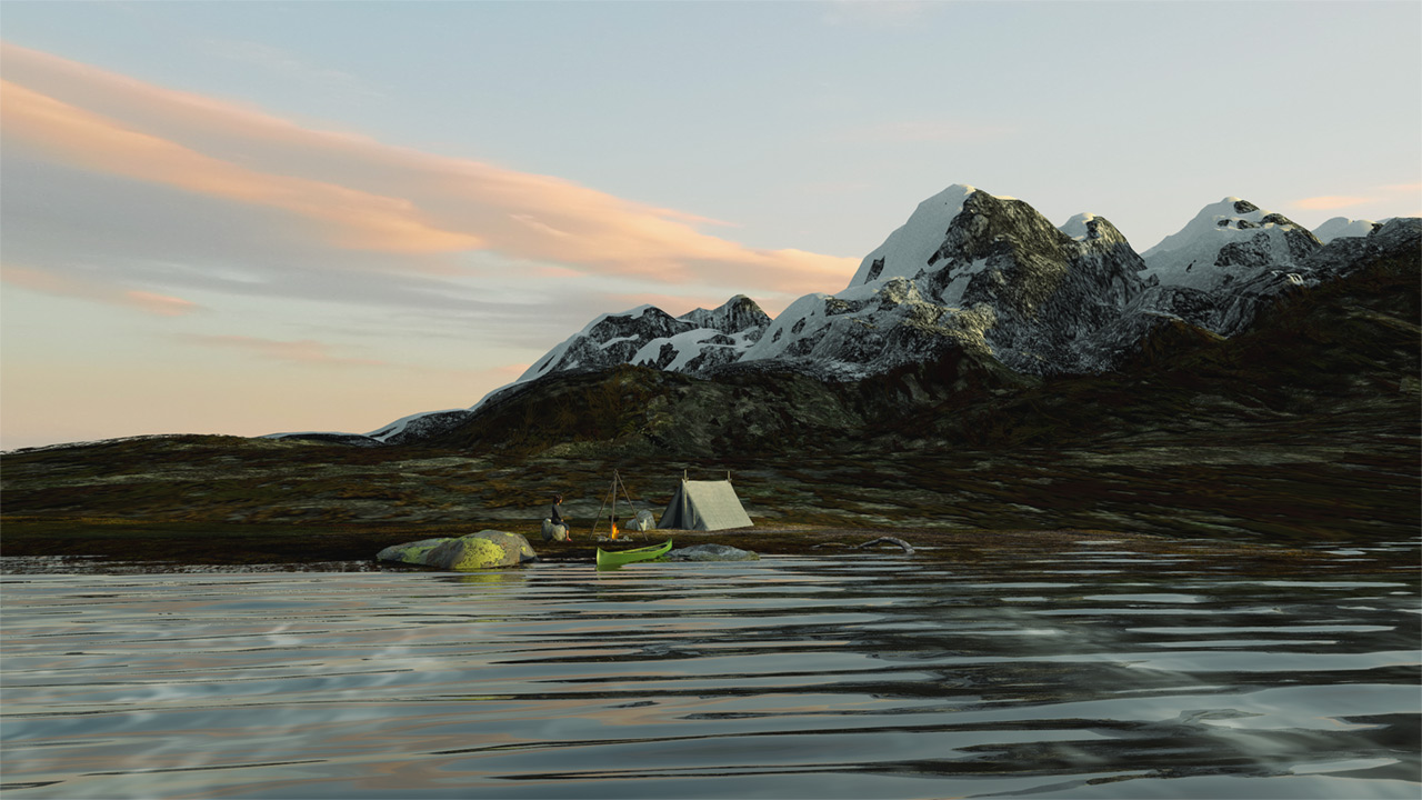

I this thread I’m showing some results of using advanced lighting techniques, presenting SH3D/Sunflow renderings as they come, without any digital postproduction ( except resizing).
Project one - East of the sun and west of the moon.
Dog Bay.
«Langt, langt borte saa han noget lyse og glitre»
Norway is a most beautiful country – a wild country, with snow covered mountains surrounded by deep, dark forests, and black, bottomless ponds – a country where tales of elves and trolls and magical places come naturally.
Norwegian folk tales play an essential part in upbringing in Norway. For me, being half Norwegian, there was no exception.
My mother read from Asbjørnsen and Moe's collection of Norwegian fairy tales to me every night.
And afterwards we talked about what we had read.
What was there to learn from these tales?
Did these tales have anything in common with the Bible?
What was the right and what was the wrong way to behave as a human?
What was real, and what was a fantasy … or an illusion?
Does it really matter, as long as we can learn something from it?

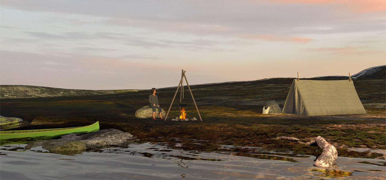

Dog Bay at night
And when the next morning breaks, the magic is gone.
___________________________
Dog Bay is a creation – an illustration with the purpose of explaining to my girls how illusions can be created.

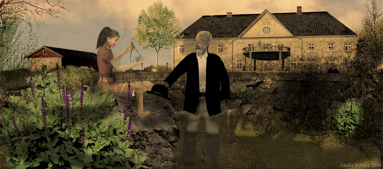

Next project; an illustration of an old Danish country house, inspired by the old traditional timber-framed houses with thatched roofs.

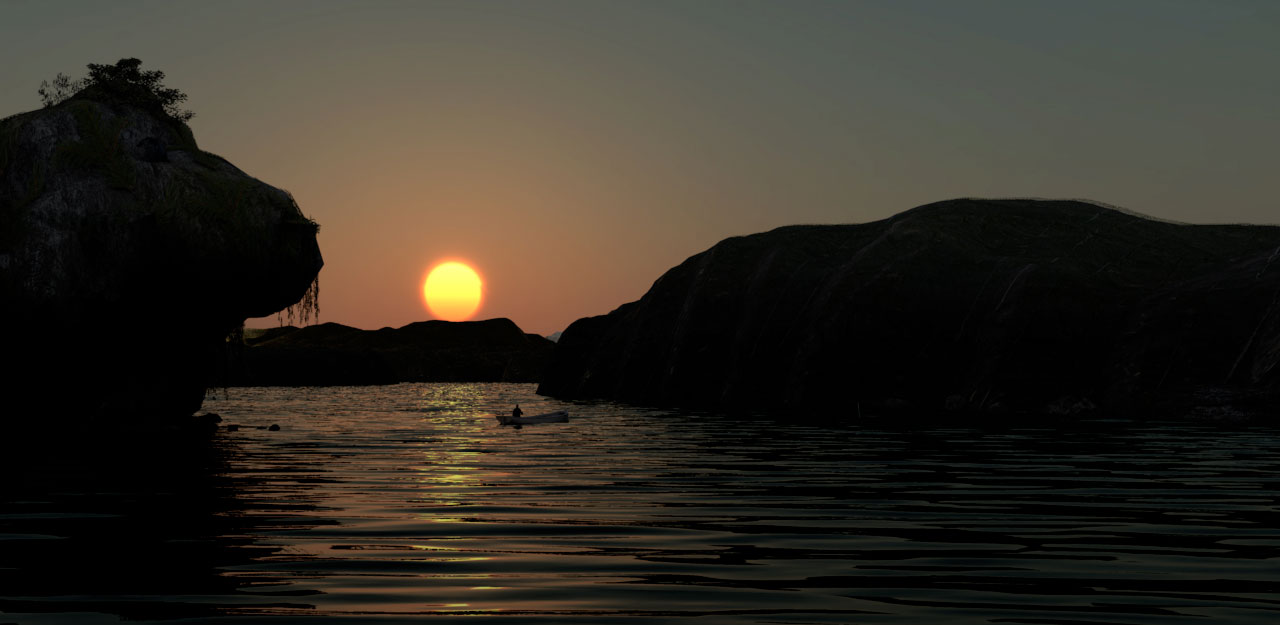

Interesting! And great images. I love especially the Dog Bay at night. What sort of texture do you use for the lake? How do you obtain this very realistic colors?
[Oct 8, 2019, 7:26:40 PM] Show Printable Version of Post    View Member Profile    Send Private Message [Link] Report threatening or abusive post: please login first  Go to top
maureenowaters
Joined: Sep 30, 2019
Post Count: 15
Re: Off the beating track
Wow!! So beautiful story. I love all the pics so much but the dog image really awesome.
[Oct 9, 2019, 6:13:10 AM] Show Printable Version of Post    View Member Profile    Send Private Message [Link] Report threatening or abusive post: please login first  Go to top
Hi VeroniQ,
Thanks for your nice comment!
The water is in fact not a texture, it's a 3D model of water generated from a height-field map. The water reflections are quite natural, and are created by applying a glass surface in the .mtl -file:
newmtl sea
Ka 0.0 0.0 0.0
Kd 1.0 1.0 1.0
Ks 0.33 0.33 0.33
Ns 10.0
d 0.86
illum 2
I have tried to explain it here
And there's also a link to a water model ( and some other things I have created ), that can be downloaded HERE
I have had some time to experiment for a couple of weeks ( no children), and I have spent some time looking at ways of using Enko's panel lights, applying different colours and intensity. I have also experimented with layering slightly displaced copies of my models on top of each other, using transparent textures to create depth and colour variations ( like faking displacement/bump maps).
The colour of the water is determined by an underlying layer ( a box) that I have textured with different shades of blue and green.
I'm abroad at the moment, without my SH3D-files, so I cannot give you any examples now, but I can come back with a more in-depth explanation ( and some more examples) when I get back to my workstation at the end of the week.
