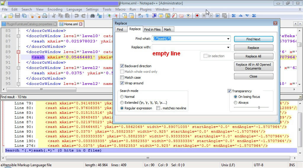

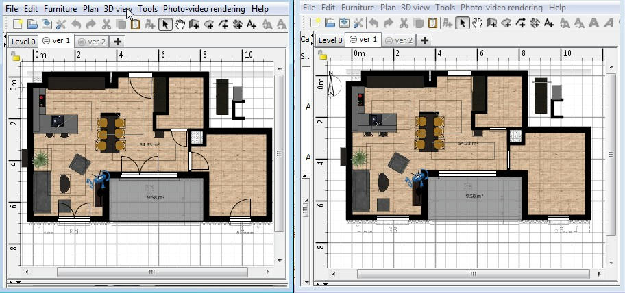

Copy your project, open in winrar, extract Home.xml. Open Home.xml in text editor, find all lines with word "sash" and delete them, save and add to your project.
Before and after

instead of deleting the hole line with "sash" I just changed the endAngle from "-1,5707964" to "-0,01" for all Windows.
I did that with the search and replace command of the editor. Now I can open/close Doors with "replace" in seconds, because all Doors still have -1,5707964 in and all windows -0,01.
