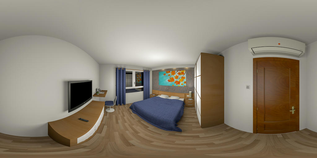

Here's the version 1.1 of the YafaRay rendering plug-in which allows to compute equirectangular images.
It's based on the version 3.4.2 of YafaRay that David Bluecame very gently accepted to release with the missing camera used to compute this kind of images.
Equirectangular image of example 12 of the gallery (4000x2000 image)
These images require to be displayed by a special viewer like this one. You may also try on Facebook using Anh Ðinh tutorial.
Kudos to David and YafaRay team! smile

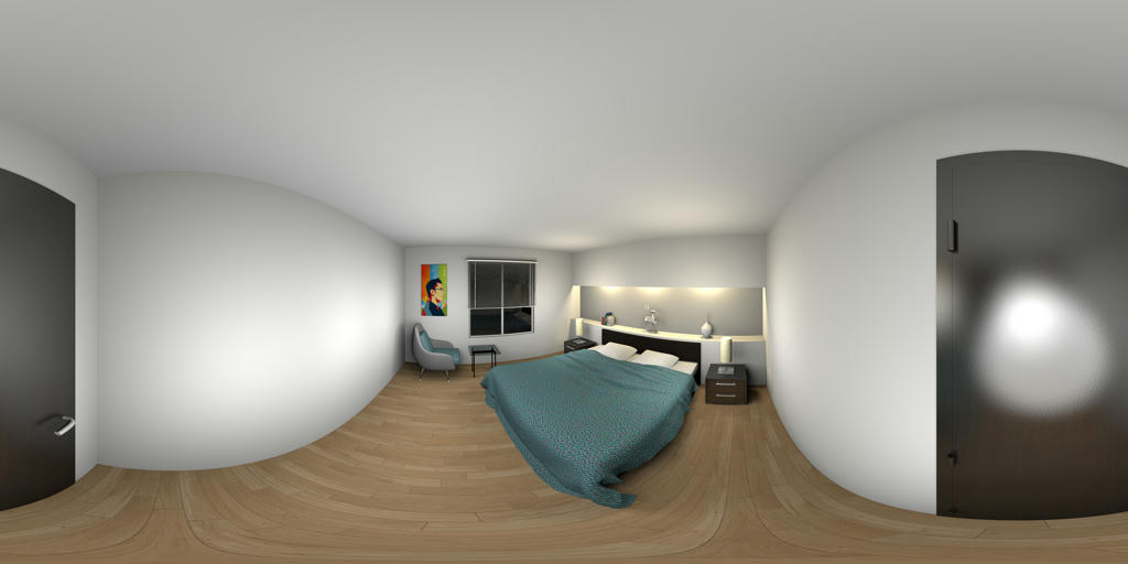

That's amazing Puybaret. Now I can render a spherical photo with best quality really fast. biggrin
4000x2000, best quality, spherical:
Sunflow: 15 minutes
Yafaray: 3 minutes
Sunflow: 15 minutes
Yafaray: 3 minutes
Thank you, Puybaret and the developers. You are the best.
