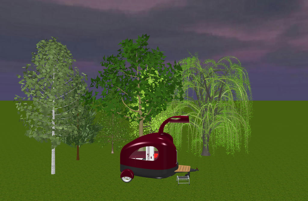

Still not what I expected, but it's getting better (Beta 4):
Screenshot of the 3D-view:

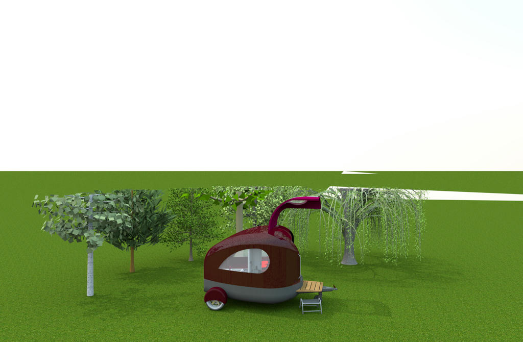

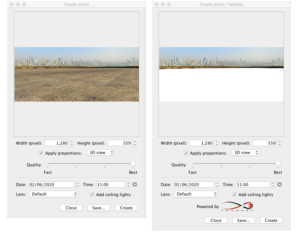

I also noticed another oddity:
This is a larger image, rendered by YafaRay:

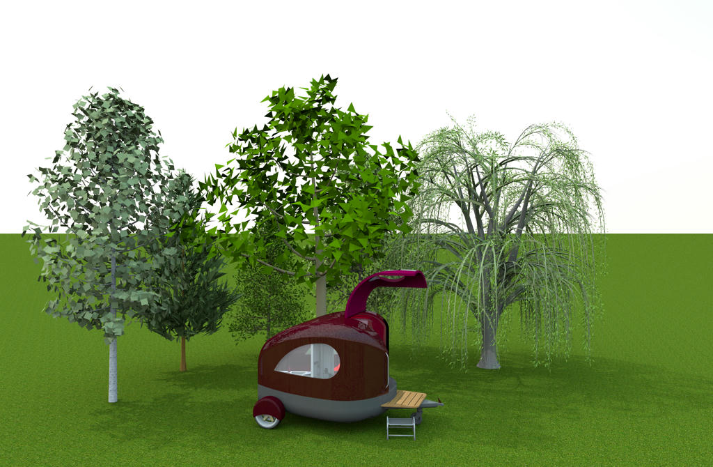

Rendered by Sunflow:
And to make an unjust comparison; here's a rendering made with Enko's SPR v1.8:
___________________
In case you want to have a look at the terrain that YafaRay failed to render:
YafaTestTerrain.sh3d
[Jan 15, 2020, 9:01:02 PM] Show Printable Version of Post    View Member Profile    Send Private Message [Link] Report threatening or abusive post: please login first  Go to top

Many thanks for your tests. It looks like we get closer to a working solution smile
The version 1.0 Beta 6 published today brings support for BMP, WBMP and GIF images (that will fix Cecilia's issue) and improves the cache of texture images to speed up YafaRay launch during subsequent times.
Cecilia, I tried your file and noted a similar CPU usage on my computer, even if it wasn't as low as in your case. As I wondered if it could be because of the very large images you use as textures, I created another version with much smaller images, but this gave the same results! Could you try with some files of the gallery (like the Alps hotel that you seem to like ;-), and report how rendering works with them?
Among the remaining issues, I noted that the default sky used in aerial view still gives some images a little bluer than with SunFlow. After some investigations, I didn't find any solution yet.
Before releasing a version 1.0, I shall add the support for Windows and Linux 32 bit and a Depth of field lens option. As YafaRay doesn't seem to be able to generate some equirectangular images, I fear there won't be any Spherical lens option at the moment. Any other ideas in mind?

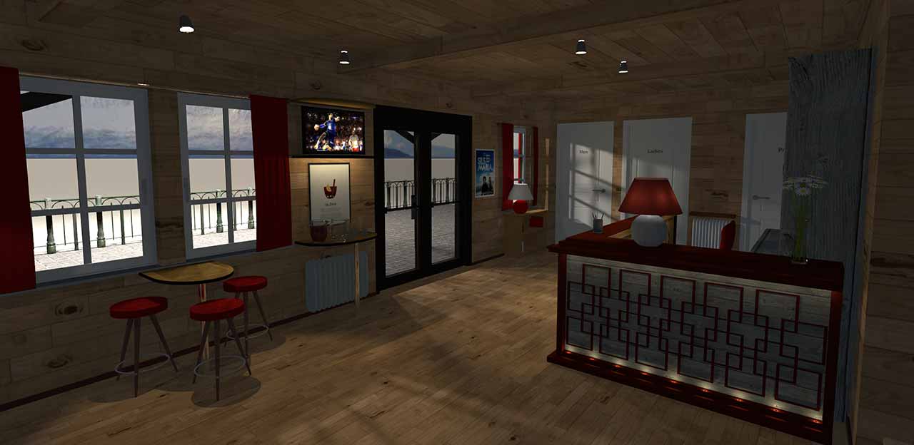

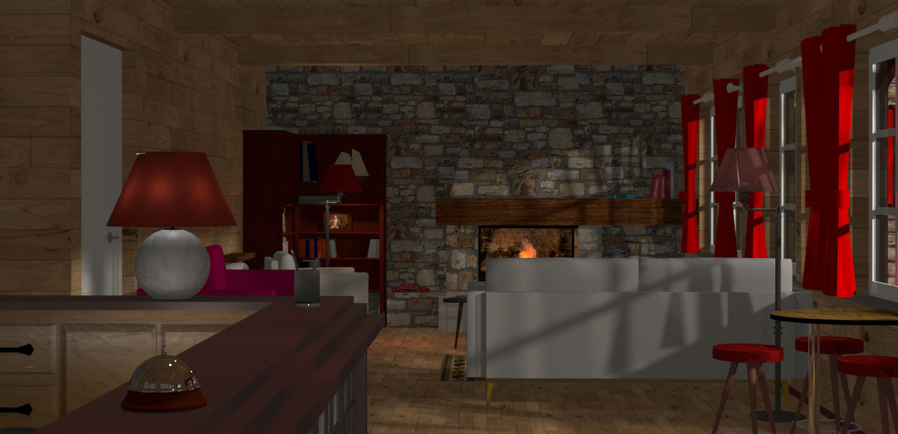

I have made some more tests with the YafaRay renderer, using an abused version of the Alps Hotel.
The abuse was necessary because I wanted to test how YafaRay responded to lighting. Since YafaRay is not yet ( at least not in the current version) able to handle Enko’s “Other Light Sources”, I had to see what could be done without using them – only using a multitude of the original light sources – like I used to do in the “old days”.
Result: The YafaRay renderer v1.6 beta works surprisingly well.
Here are some YafaRay renderings of the abused Alps Hotelreception and front desk:
The CPU-issues from the last version are gone.
YafaRay is now using all my 24 threads, as well as 92% of my CPU-capacity, and it’s performing quite fast – almost 50% faster than Sunflow.
It’s also producing some nice results – as long as have the patience to work with my light-settings.
