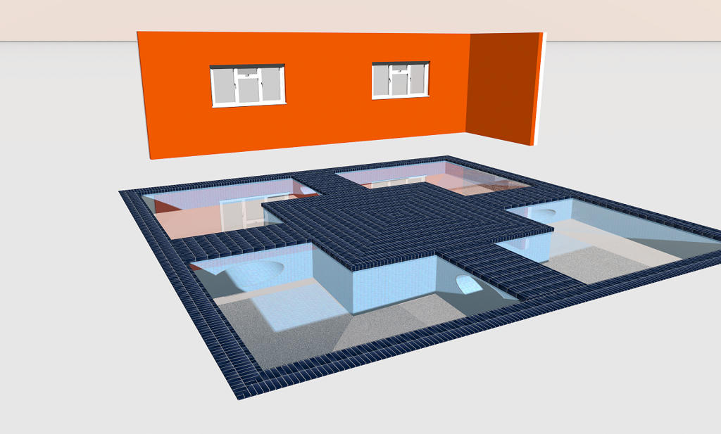

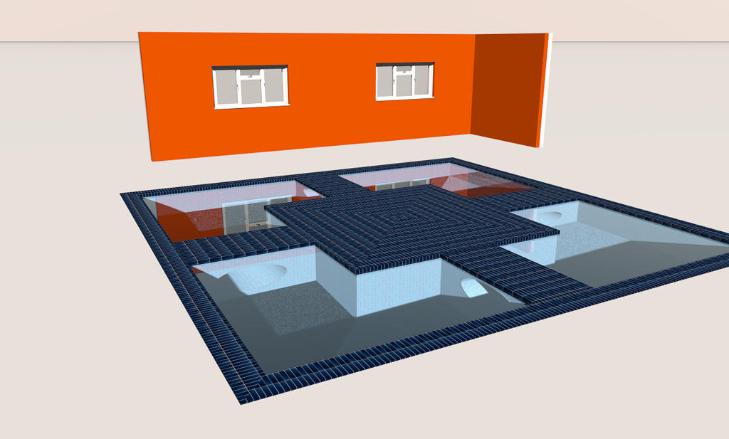

I like the softness of the shadows in ibl true, the sky and reflections in the glass also look better in the ibl randers, is it ibl Or background or can they be combined?
Further test to compare sun and yar, here are 2 images of a pool with a wall and windows reflected, there is quite a bit of difference in the way the reflections have turned out.
Sunflow all default settings
An Yarafray

Is it the more advanced ray-tracing in Sunflow that makes it perform slower than YafaRay in your test?
YafaRay is primarily optimized to work with Blender but offers a lot of nice features as shown here.
The purpose of my contribution to this new plug-in is to help find general settings for a rendering approaching or equivalent to that of Sunflow. Duration is an additional indication.
To return to your question, it is the YafaRay "Path Tracing" global illumination settings that make a similar rendering (regardless of shininess) faster than Sunflow.
