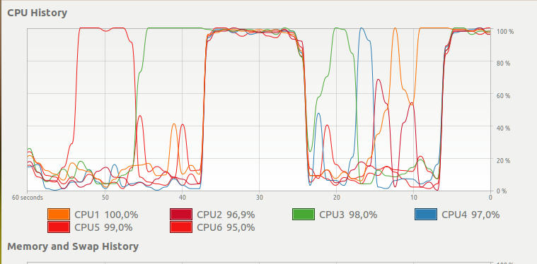

A further test under Ubuntu shows that YafaRay uses only one (1) core during the preparation of the rendering (approx 35 seconds).
Once that is done, it uses all 6 cores of my computer for the full 100% during the actual rendering (13-14 minutes).

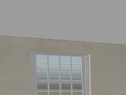

Testing Cecilia's file, I decided to do a Q1 test run to see if I had the same image as in the other tests. YafaRay behaves VERY STRANGE and shows me a more or less random part of the room in close-up, not the center of the room where the virtual visitor is looking at. Q2 gives the same result.

Interestingly, the processor usage during the preparation phase can be very different when you do two consecutive renders of the same image.

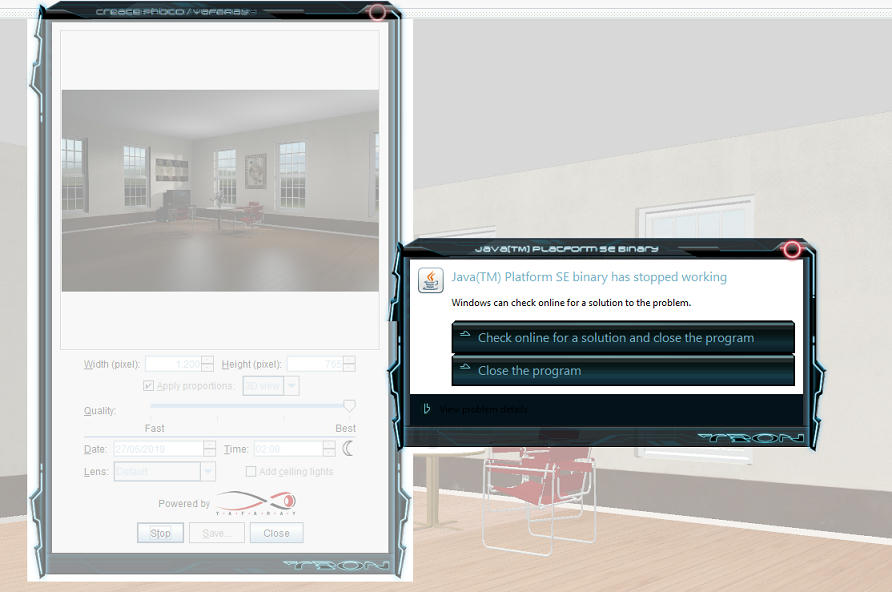

Now, SH3D crashes at every rendering whatever the scene. (Windows 10 64-bit)
I imported the source code of the plug-in into Eclipse (Projects from Folder or Archive) and added the necessary libraries except for the import javax.jnlp .
I found that SH3D crashes when accessing the createMaterial, createBackground, createTexture, and createLight functions.

YafaRay is not using more than 32% of my CPU capacity, whereas Sunflow is using 98%.
It's strange, it's not what I see on my iMac, where YafaRay and SunFlow use as much CPU power as possible. I wonder where it could come from...
