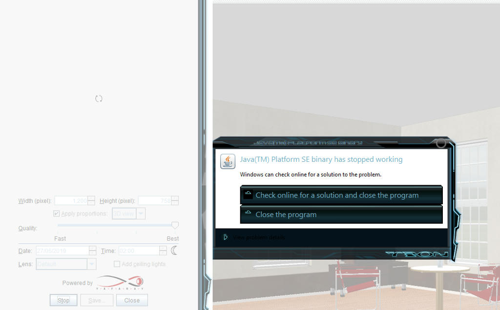

Under Windows
After reading Enko's message, I tried two homes from the gallery. In both cases the program stops after a little thingy spins for a few seconds.

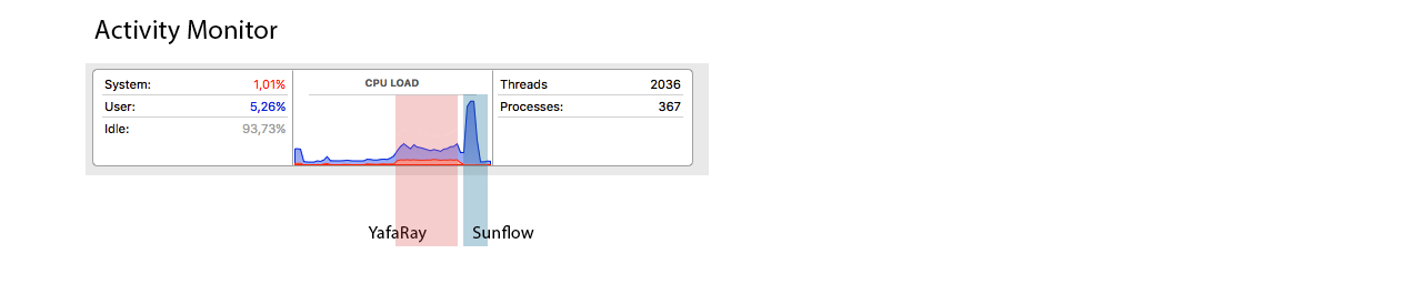

Anyway, I have made a new video, en suite, with a stop watch and a CPU-monitor running:
YafaRay-Test-2
Maybe this can be the reason why YafaRay is slower than Sunflow?
YafaRay is not using more than 32% of my CPU capacity, whereas Sunflow is using 98%.
Just out of curiosity: Why go for another CPU-renderer and not a CPU/GPU-renderer?

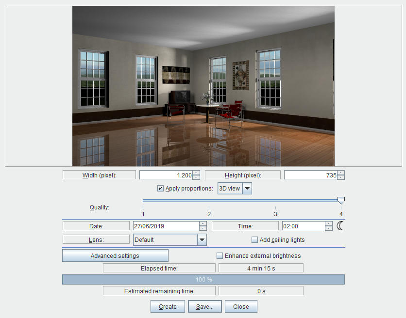

Thought i would give this a try.
Ver. 1.6, set to gloss, all other settings default
and with Yafaray
3 x it crashed when it started the render, 1 it crashed when it completed the render but before it could be saved.
Windows 7 64 bit
