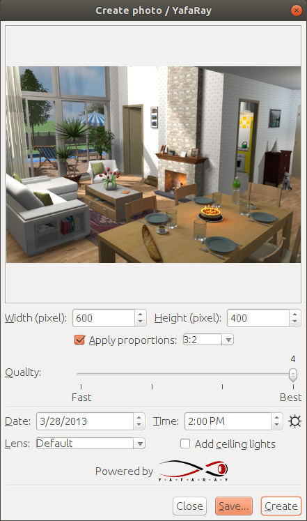

I'm happy to present you the YafaRay Rendering plug-in able to render images with Yafaray engine, thanks to the new Tools > Create photo with YafaRay menu item (see the end of this message for download links).
After the rendering engines performance test made last year, YafaRay library looked like a good candidate to improve the rendering speed at two best quality levels in Sweet Home 3D.
Thus, this plug-in mostly replaces SunFlow engine by YafaRay engine, reusing the same features and look as the existing Create photo dialog box at the moment (both dialog boxes even share the same parameters).
It's able to run under Windows 32 / 64 bit, macOS 64 bit and Linux 32 / 64 bit. Spherical lens was missing in the version 1.0. You'll probably notice also that, compared to SunFlow, the default sky produces a slightly bluer color when a sky texture is not used.
From my tests, this new rendering engine runs twice faster. Not as much faster as the performance test let me hoped, but it's still a good improvement.

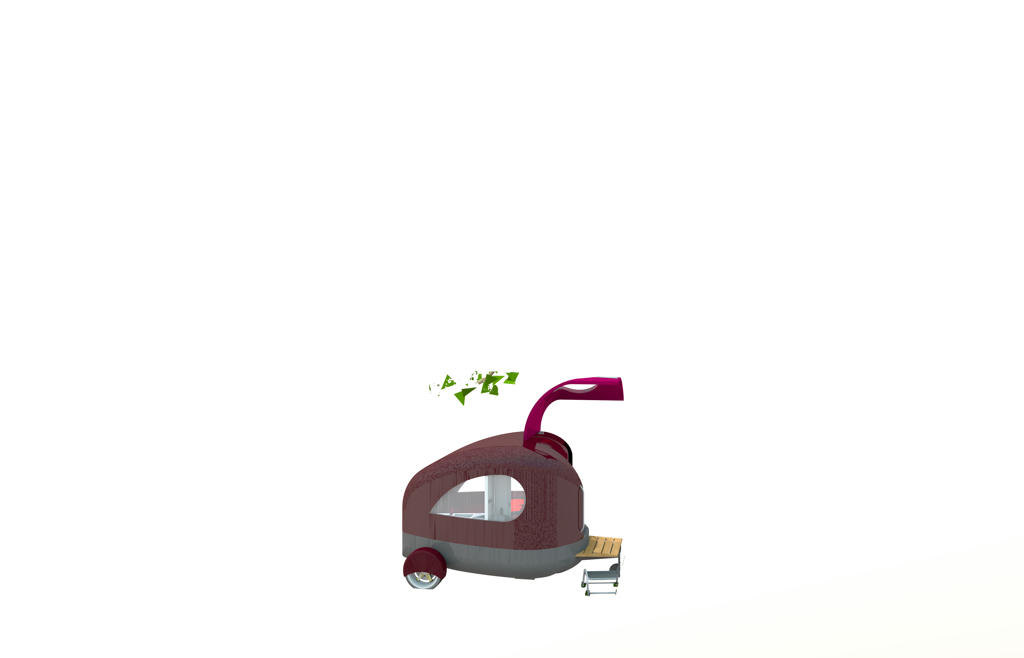

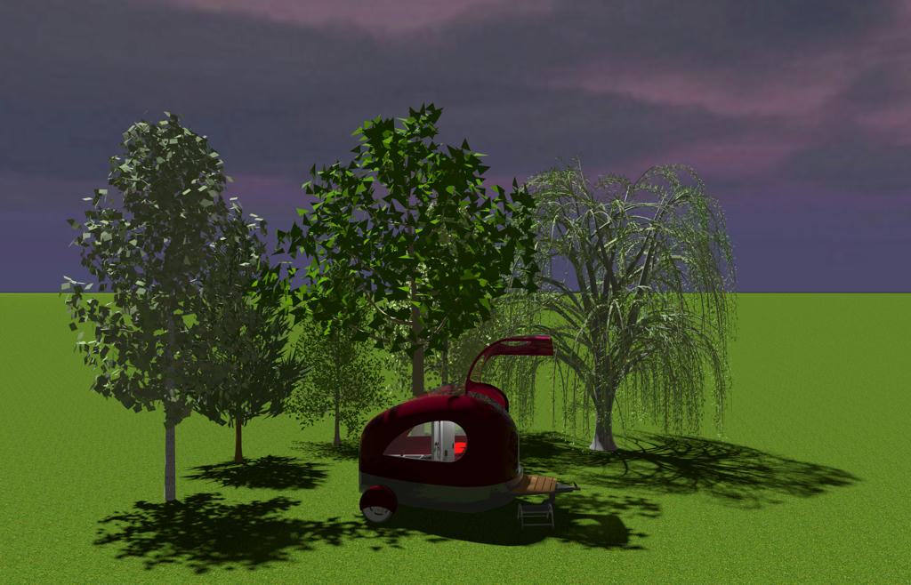

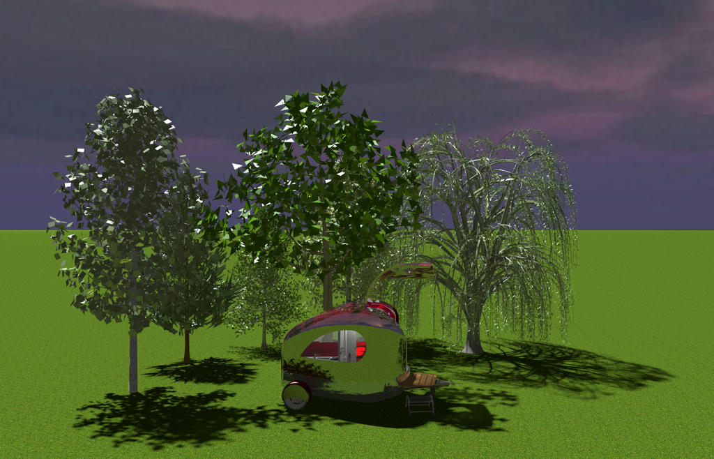

@Ceciliabr: Here works on a MacBook Pro 13 (2017, the one with usb-c) with Mojave
It seems also quite fast.
@Pubayet
I made a test with PVR 1.7 (SweetHome 6.2) Q4 (ambient occlusion)
And one with YafaRay plugin
PVR 1.7
YafaRay Plugin
I like a lot how Yafaray light goes to the "left" side of the picture, it is really close to what happens in real life, and ambient light is very nice.
On the other side lights allaround seem way better with enkyo plugin, I don't know if it depends with the usage of PVR light panels or it is something other.
In top right the cube light is very nice with enkyo plugin, but behaves bad on YafaRay.
It's very exciting as a new plugin and maybe enkyo can make a PVR-YafaRay plugin that is fast and nice!!!
