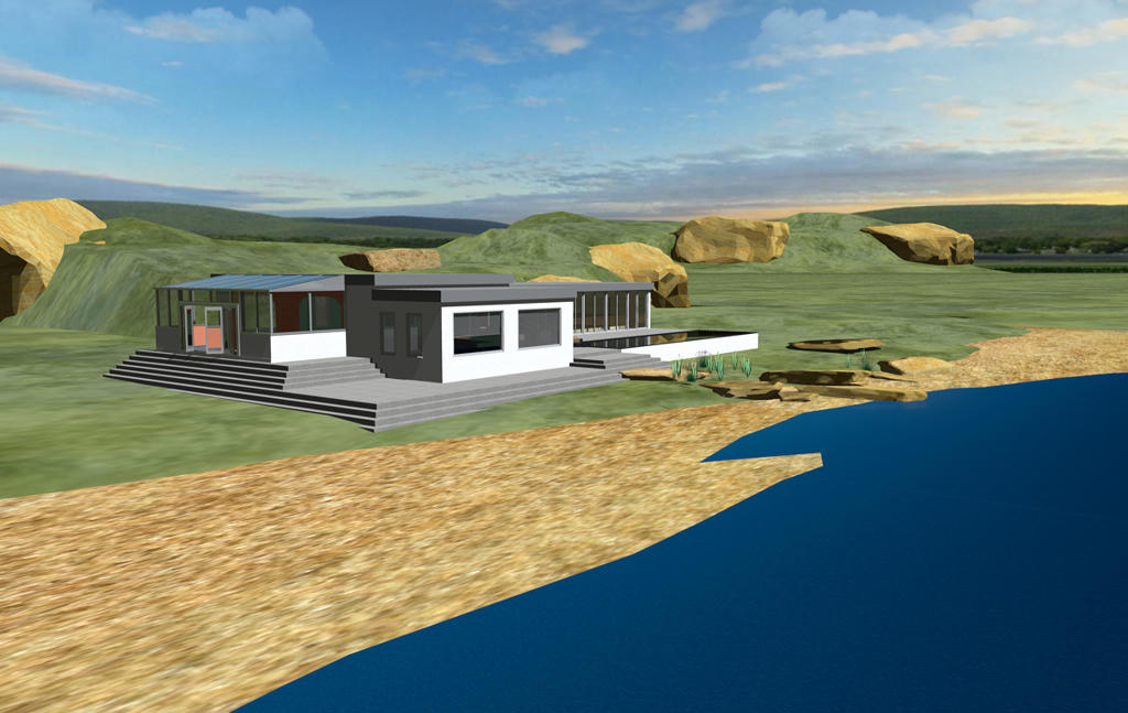

I like a lot the nice terrain around the house. Could you explain how you designed it (or just point to the Cec's posts if it's enough)?
Status:
Offline
Re: Small holiday home

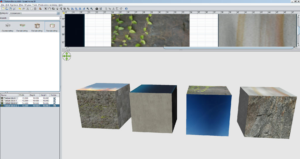

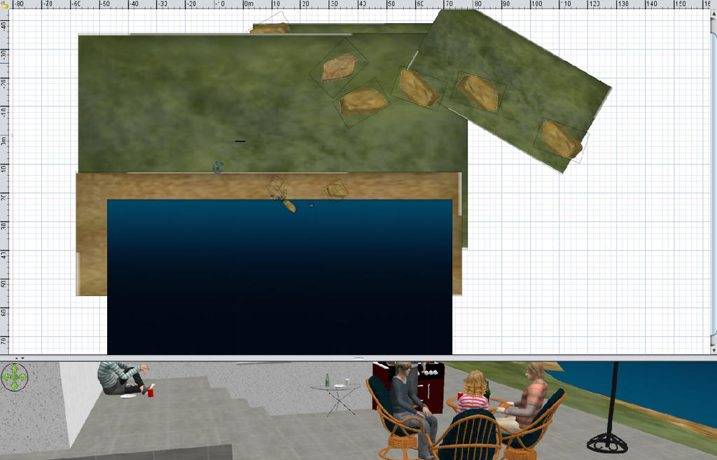

LINK to Cecs post, the terrain used in her files, Day, morning and night, was enormous, used as a background and to break up the horizon. I have reduced it size here and also in a recent natural pond, brought to the foreground, effectively hiding a lot of the horizon. The textures i do not know the correct way to save them, what i have is a file i keep, which, at the moment, contains 3 boxes from the library, each are 100m square, i copy a texture i like, apply it to a face of a box, then save it for future use.
