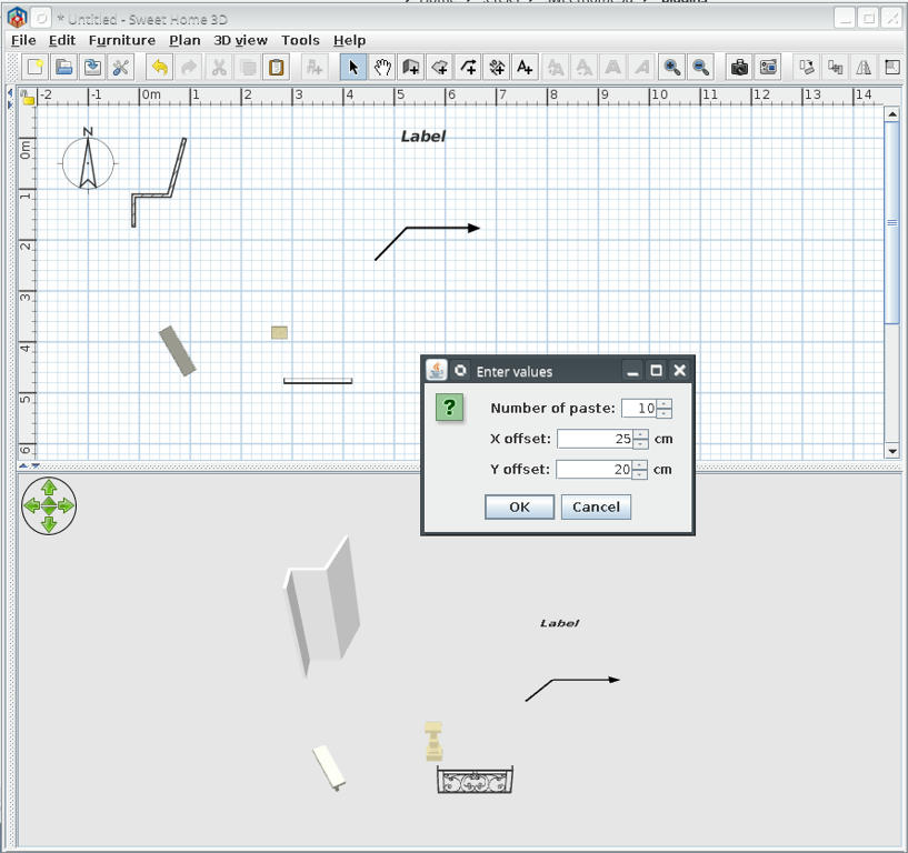

Few screen shoot:

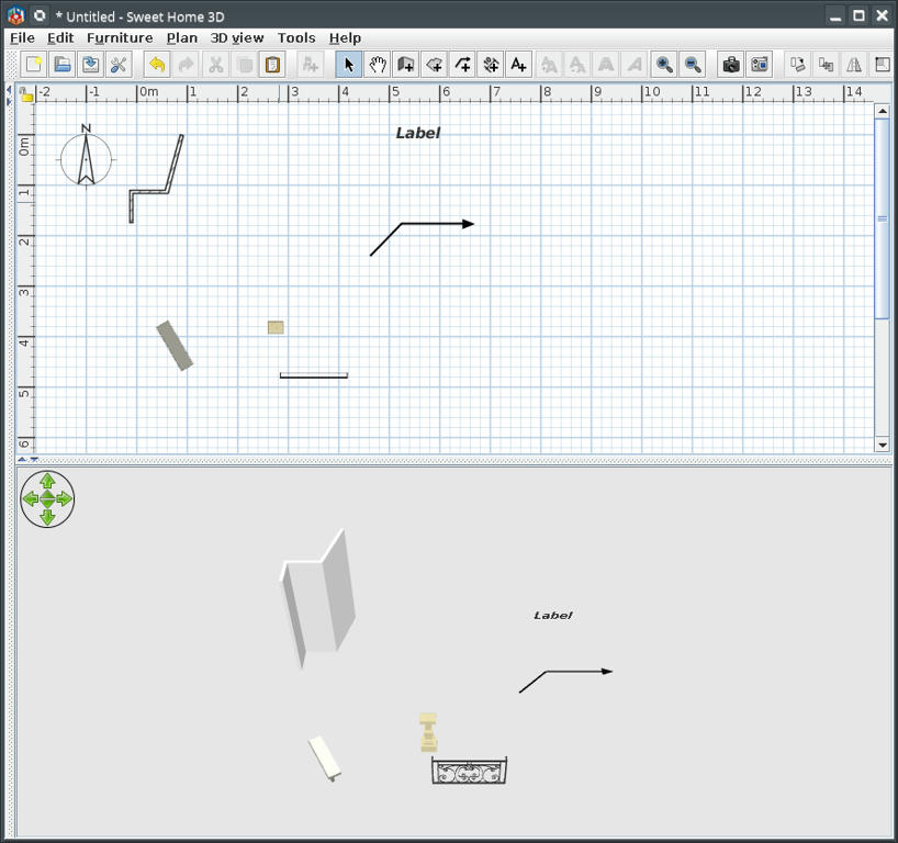

Insert objects in plan then select and copy (Ctrl+C) the desired object(s) then deselect them

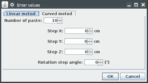

Edit->Paste special... and insert values

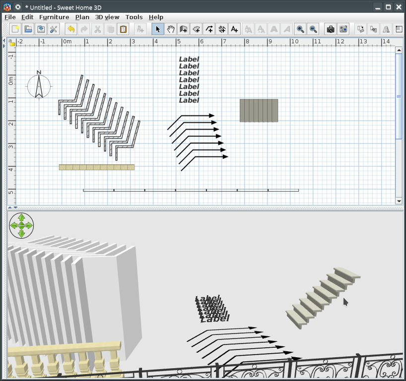

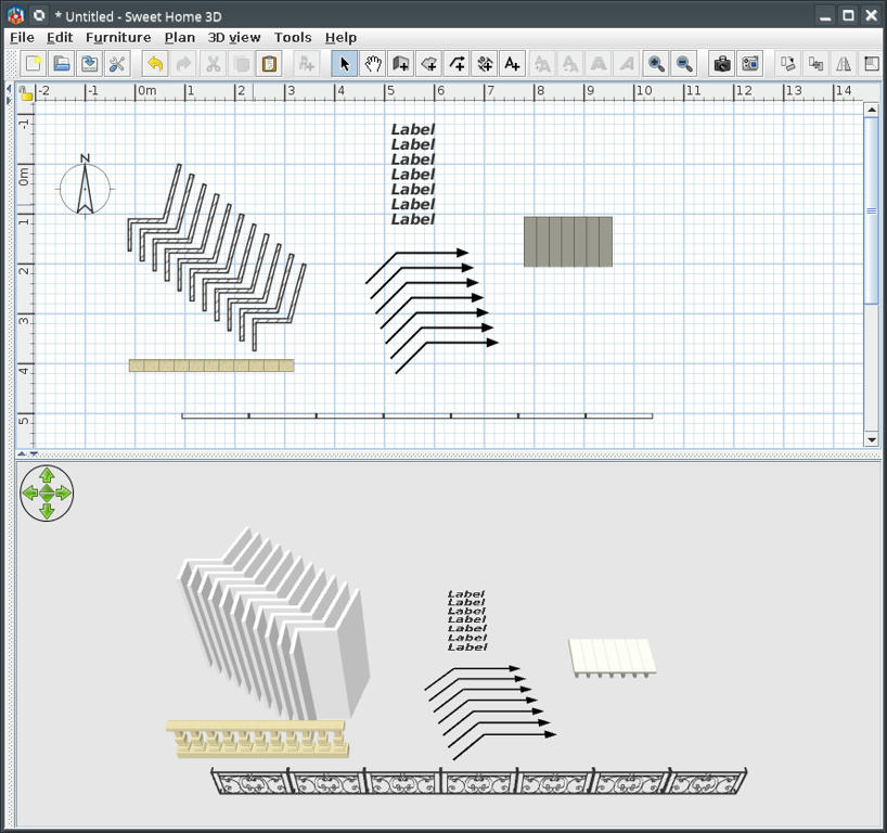

This could be the results for different values and objects

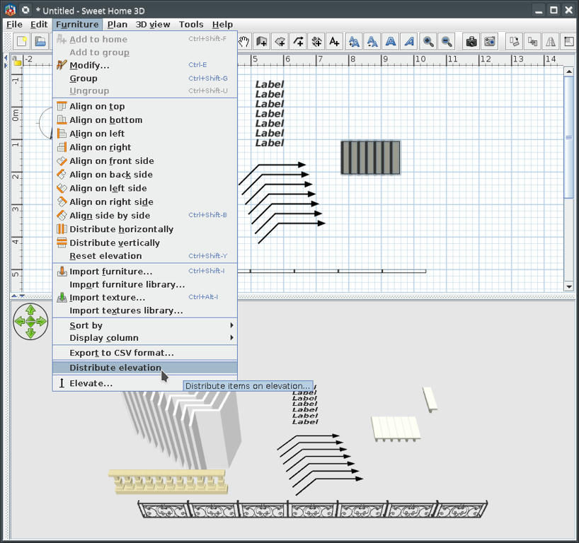

Example of use distribute elevation to make stairs
Elevate one step to maximum necessary; select all steps and...

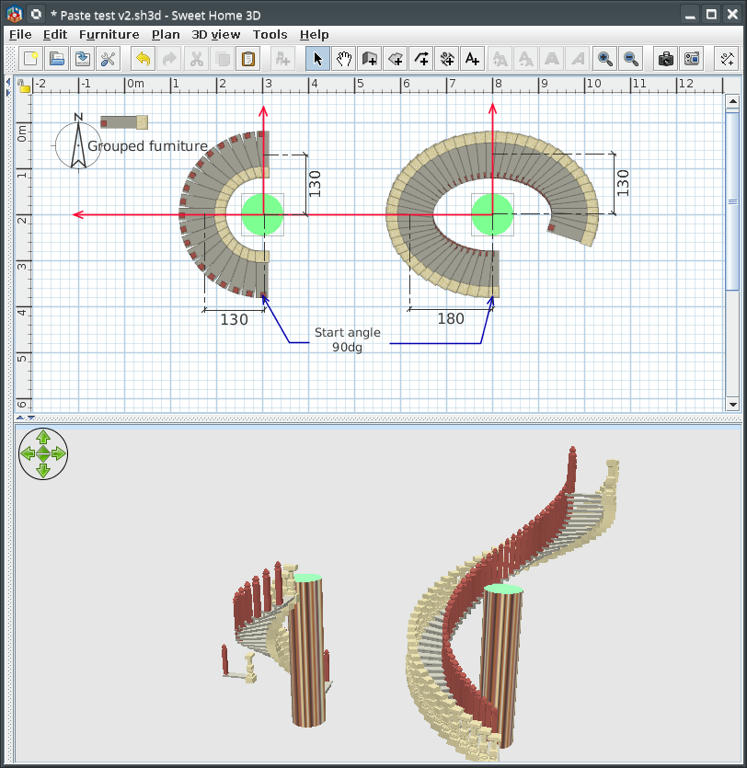

-change interface
-add a curve method
-add elevation and rotation in both method

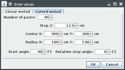

The second image have the input used for ellipse
You can use undo for delete one-by-one latest objects.
