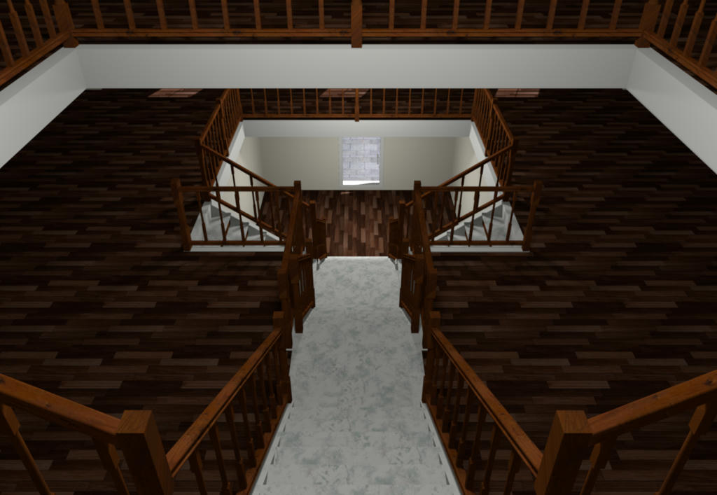

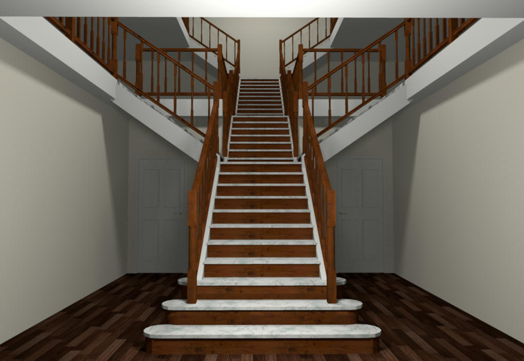

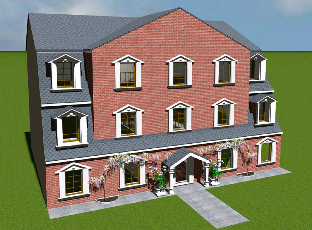

I wanted to do a building, which, as the topic says, has curb appeal, something you might just pause to look as as you passed. not sure i have managed to achieve that, it has ended up looking more like a town hall, but maybe as it develops. Anyway here are a few images.

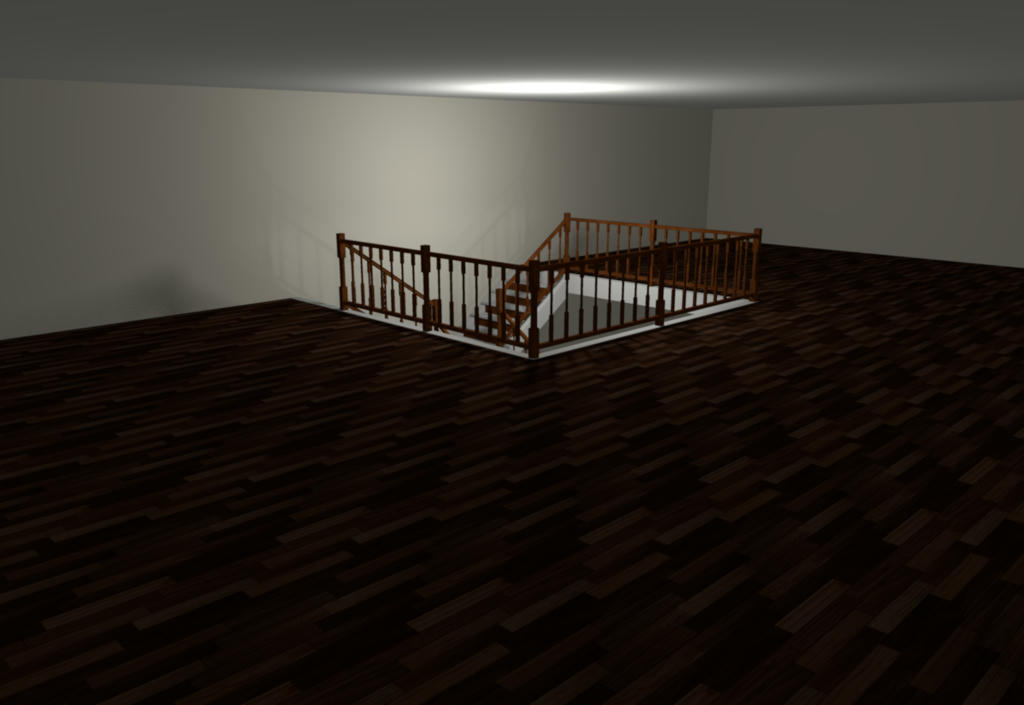

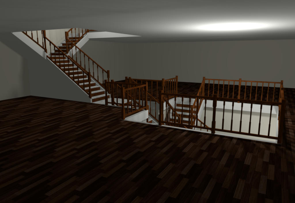

Inside all that has been done is the floors and a staircase, i say all, but it took a while.
The handrail i made separately everything else is components straight from the library

The levels between the main floors have on them various walls, for instance, level 7 has walls which form the risers for the middle section of stairs, they are roughly triangular, but to avoid using 2 boxes and a triangle, which would not texture evenly, i prefer to use a wall, also these levels have the floor depth set to 1 mm so the minimum wall height does not include a floor depth. smile

Just watched your 3D model, and I must say that your roof construction is very nice.
Solid work!
