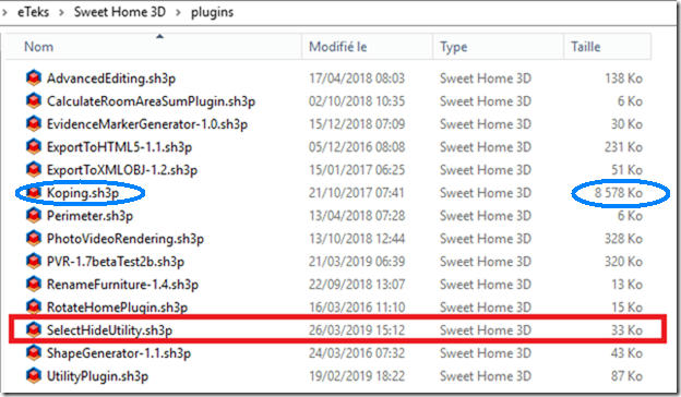

1. I see an very huge plug-in Koping (8.5M). I try to find it on google without success.

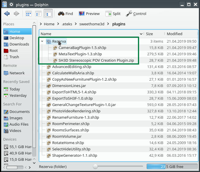

2. In second image I share my plug-ins folder and the way I use when I test something.
I create an folder under plugins (mine are "Rezeva" which mean "backup" ) where I put the files I don't use everyday and I don't want to delete.
Usually I drag-and-drop from an location to another.
SH3D will see and load only those from plugins nothing else.

TY Dorin.
Here are my installing plugins.
My last try : I moved all plugins in a backup directory except your.
I launched sh3d.
Result : no change ! crying
