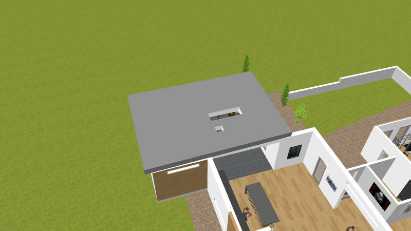

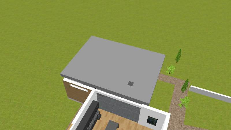

What I Wanted To Achieve
For the sake of example I am only going to do one part of the roof that is why it is incomplete, the two cut outs shown are examples only.

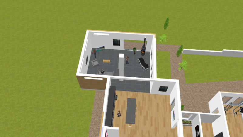

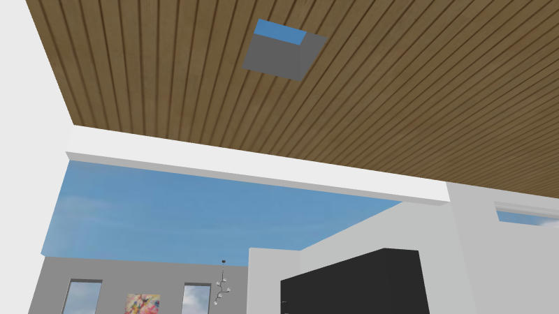

And from below.

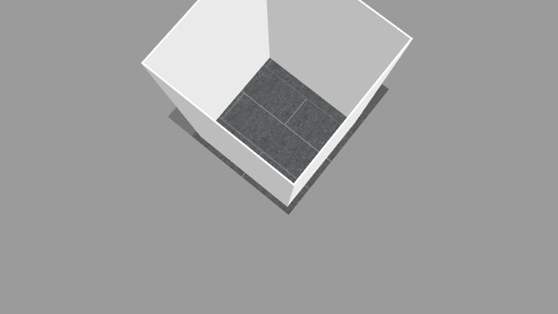

Create a box or block - I will call this the "Skylight Tool" because it will be used to cut holes in the roof.
To make the Skylight tool simply add a BOX which is in the Miscellaneous category of furniture.
I made mine 50cm wide and deep and 500cm high, it can be resized later.

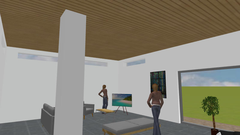

In the second 'photo' it can be seen that I have a wood panel texture on the ceiling and the Skylight tool passes through, the ceiling does not show when viewed from above as you would expect.

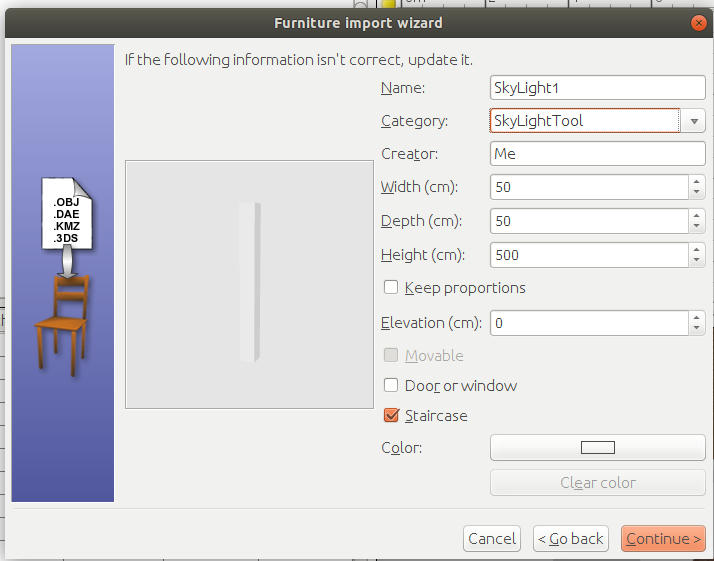

Select the SkyLight tool and save it out in an OBJ file.
[ Menu ] 3D View -> Export to OBJ format.
Make sure you export only the Skylight tool by selecting "Export Selection" when asked, check the export file was saved and then delete the original.
The Skylight can now be imported back in from the OBJ file.
The important step is to make sure that Skylight tool is imported with the same property as a Staircase - namely that it will cut a hole through any ceilings or floors it may pass through - see the ticked orange box in the next image.

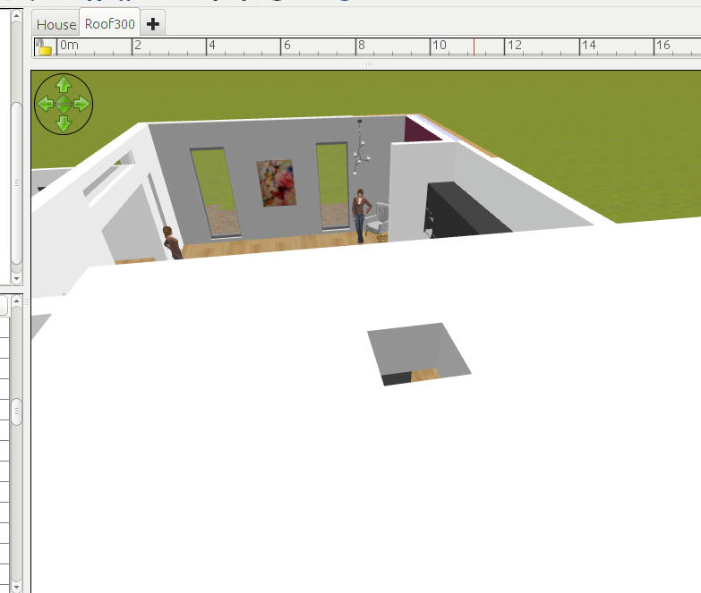

Once the Roof (level) has been added the Skylight tool can actually cut a hole in the ceiling, however we will not see a hole ( viewing from underneath ) until the Skylight tool has been made invisible since it obscures the hole it makes.
Here are the steps
Select the Skylight tool.
[ menu ] Furniture -> Modify ( or right click ) to modify the Skylight tool.
Choose materials -> modify and set all 6 faces of the skylight tool to be invisible. This will not work using the visible 'box' in the home furniture list as that only indicates whether the Skylight tool should be present or absent in the model.
Once this has been done then when viewed from underneath the ceiling should have a hole. If this does not happen check the following.
1. Is the Skylight tool invisible?
2. Was the level added?
3. Is the Skylight tool high enough to cut the ceiling.

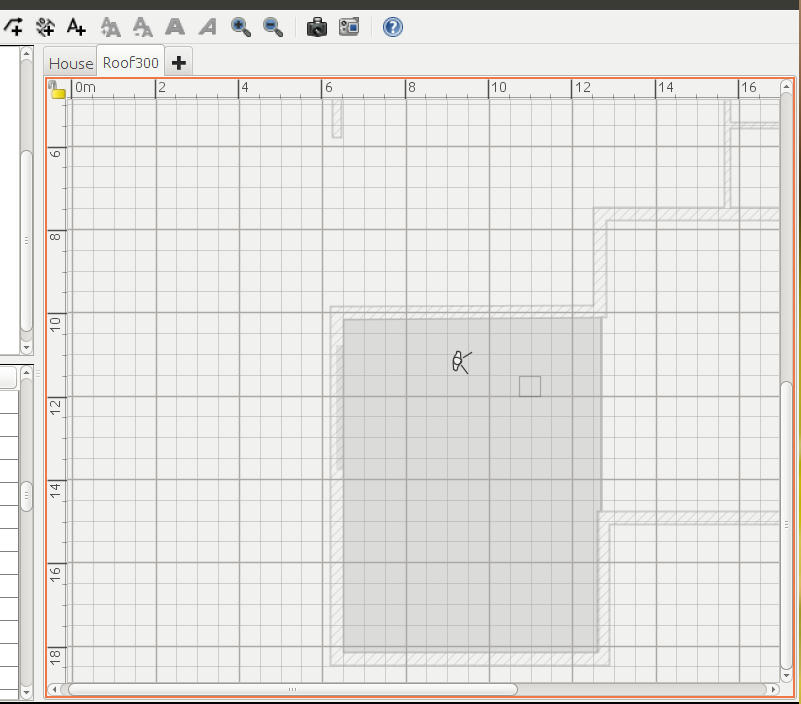

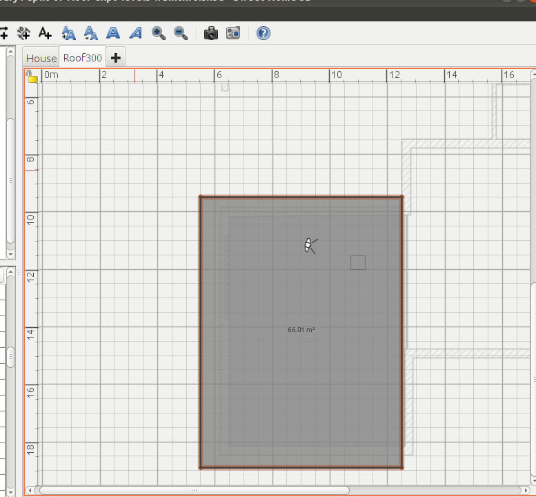

At this stage the plan should look something like this...
We can see the virtual visitor and also the square outline of the Skylight.
There are two levels one called house which contains pretty much everything in this single storey build, the other level called Roof300 is there for our roof which actually DreamHome thinks is a floor.
To make the floor appear we need to define a room, Dreamhome already knows the elevation and thickness because those were set in the creation of the level.
In my design I want a certain amount of overhang, in otherwords the roof is larger than the walls it sits on so I create a room by adding points which sits outside the perimeter of the walls.
The steps are....
1. Make sure that the tab for the second level in my case roof300 is selected.
2. Create a room on it by adding points, the great thing here is that we pick up all the usual alignment cues when moving the pointer around and can define pretty much any shape of perimeter for the roof.
The plan view should now look something like this....
And in the aerial view the roof should be visible with the skylight
in place.

So after adding colour from above....
And from below.
Note that the wood strip texture is still there, this is because it was defined as a texture on the ceiling of the ground floor room, the ceiling is the zero thickness sheet of colour or texture that Sweethome automatically adds (subject to options) when we are viewing from a point lower than the tops of the surounding walls.
