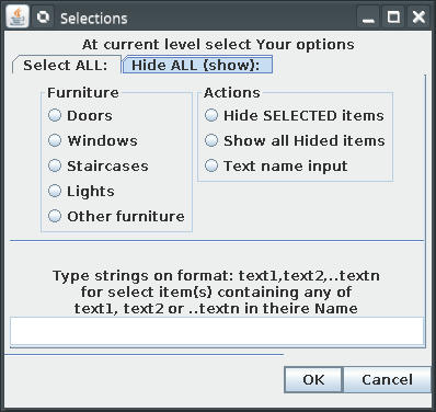

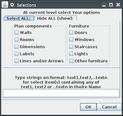

confused Re: Select Hide Utility plug-in
The plug-in with sources and licence GPL included could be find here Select Hide Plugin ...
Hi dorin,
After followed the link and installed the given plugin, I have this :
Why ? biggrin
More, with this version, option 5 doesn't work.
TY for your return.
Regards.

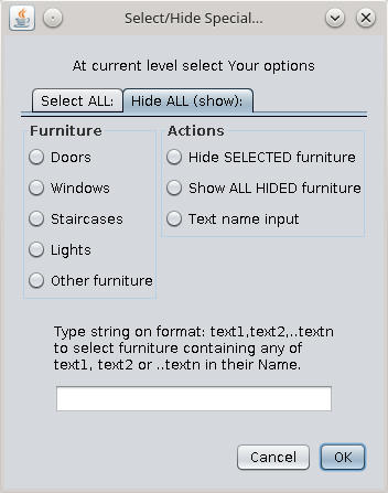

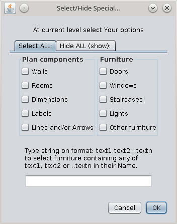

New version 1.5
-fix undo/redo for hide/show action; for select action I consider is useless
-modify a little the icon; I've add an "S" on it; is visible also on toolbar
To remember how should look:
As usual have a kind of translation in french.
