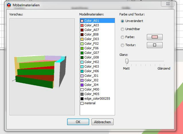

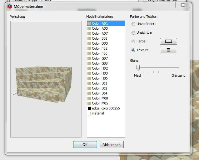

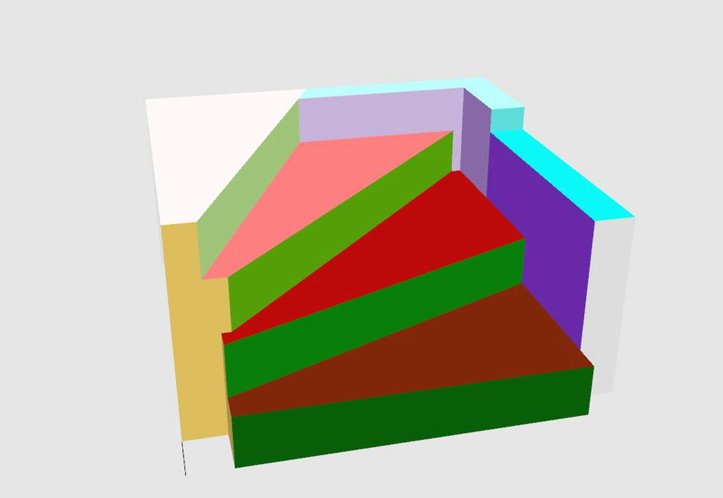

What secondly I don't understand is the following. When I do the object in Sketch up and assigning a color to each of the areas the object should have the texture coordinates. Importing this object as collada file and change (see picture) the texture results still in distorted textures.
This is the object imported from Sketch up as Collada-file:
That's what I get opening the material editor:
then change texture
and I am getting this
Why??? I really would like to understand.

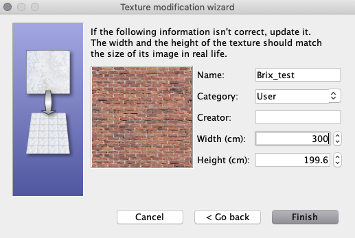

I will try to explain this with an example:
Let say you have a brick wall texture that is 300 x 200 cm.
When you apply this texture to a wall, this texture will cover an area of 300 x 200 cm on that wall. If the wall is higher or longer, the texture will be tiled and repeat itself to cover
the entire wall. If the wall is lower or narrower, the texture will be truncated.
If you just apply this texture to a 100 x 100 cm cube using method 1, the texture will keep its size.
But if you apply this texture using using the material change panel to all sides of a 100 x 100 cm cube, 100% of the 300 x 200 cm texture will by default be squeezed to fit inside each 100 x 100 cm surface of the cube.

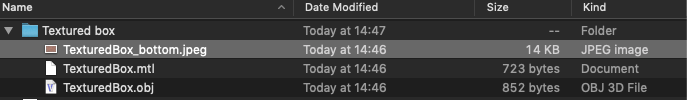

IBut if I want to use textures from the SW3D library I did not find a way how to import them in Sketch up. Do you have any idea?
If you want to use SH3D textures in Sketchup, I assume you can apply f.i. six different textures to a box and then export the box as OBJ-file.
Then the textures will be exported as .jpg or .png files that you should be able to import with Sketchup.

You don't import the OBJ-file, you import the texture:
Apply textures to a box,
create a directory,
export the box to the directory you created.
In the directory you will find the exported textures as image files along with the obj-file and the mtl-file.
Sketchup can import image files as textures.
