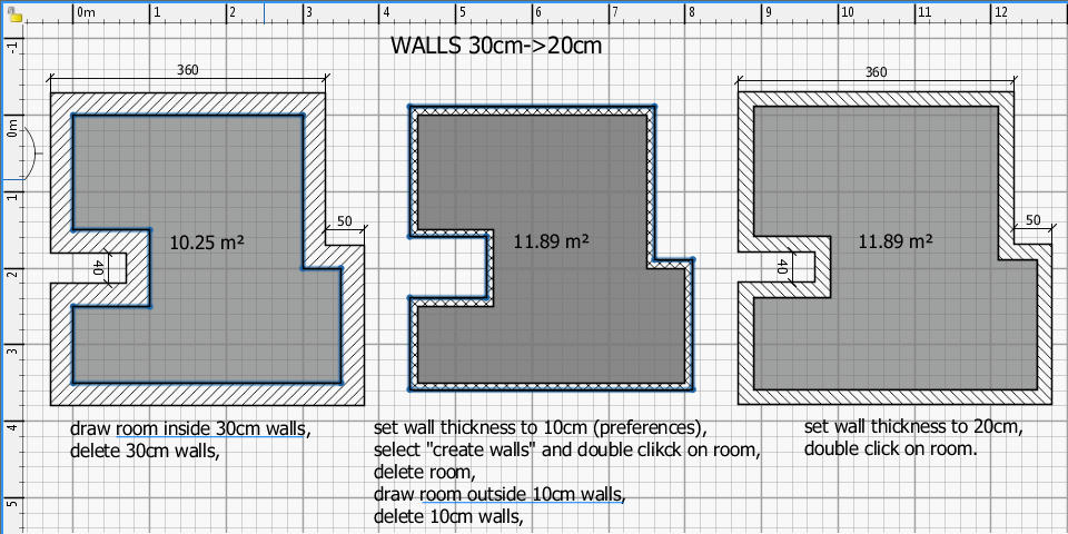

Re: Smart modify all walls function
I don't know how complex is your project but you could try this:
Thanks.
This worked. My project was kind of complex and could not do with the whole floor but it helped make it by room, speeding up the work.
Thanks very much alaX.
