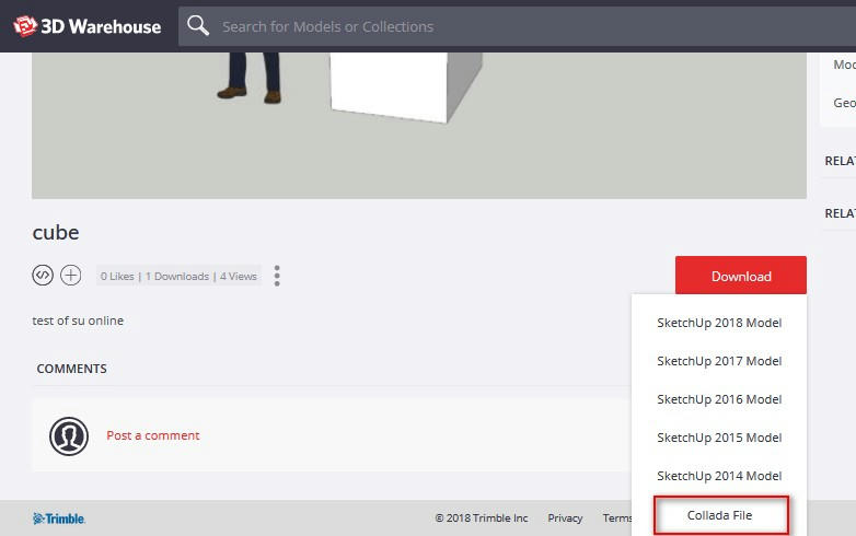

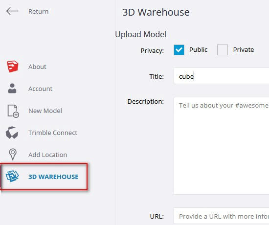

Upload model to 3d warehouse. Download collada(dae) from 3d warehouse.

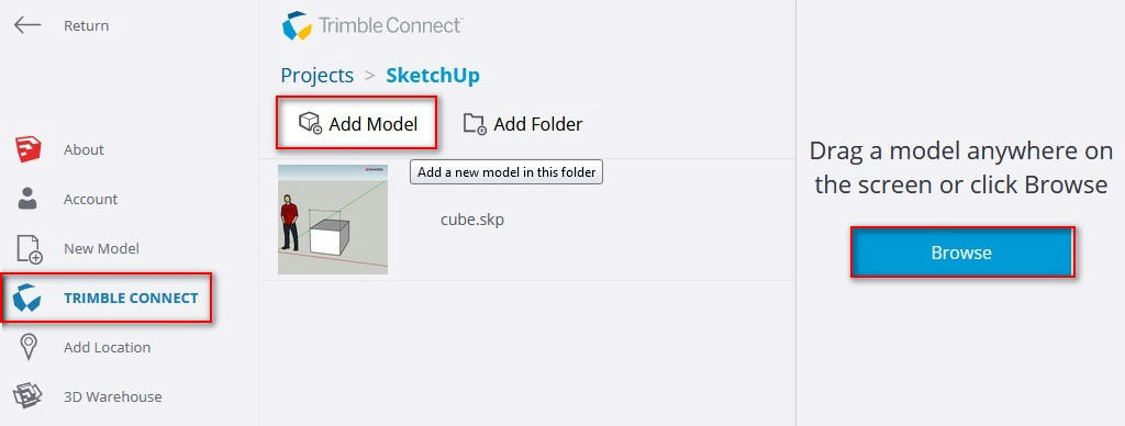

I have installed SketchUp Make 2016 but I tested online version and it worked.
Load .skp
Upload to 3d Warehouse
Go to 3d warehouse site and download
