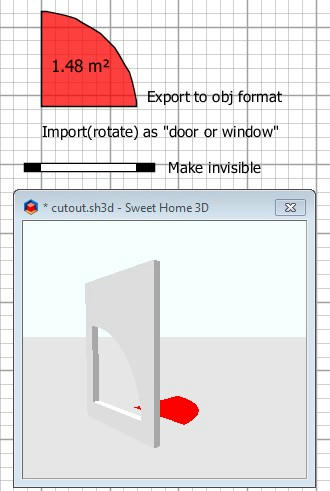

Hello Dear Forum,
im stil using sh3d for a while.
Now i have a problem with the "hole"-visibility from objects.
Using sh3d 5.7, today update to 6.0 - same problem.
1) 1st Hole - with Rounded Door from BuildIn Library
2) 2nd Hole - with WallOpeningInvisible
3) Red Arc - Rounded Door from Build-in-lib export to *.obj
then reimport with door/window
At that moment the object is included in the wall, the hole is going lost? Same when i include it in the "Invisible Wall".
This is happening with every Objects i import.
See the screenshot here:
I spent a couple of hours to find a solution, but i didn't find
helpful informations.
Any ideas what i'm doing wrong, or what's wrong?
Thank you for help.
Peter

Why exporting / reimporting models found in the default catalog? You'll lose their cutout.
You should just use the models in the furniture catalog.

thank you for the reply,
Export/Reimport was for example - when i construct a "special hole" with different objects, export it for use in the library.
But the same problem is when i download this object:
http://www.sweethome3d.com/models/roundDoorFrame.zip
When i import it (door/window option checked) there is no cutout in the wall?
Same with the "arc.zip" i've downloaded from this thread.
http://www.sweethome3d.com/support/forum/viewthread_thread,3747#17527
See my screenshot
Thank you.
Kind Regards Pete

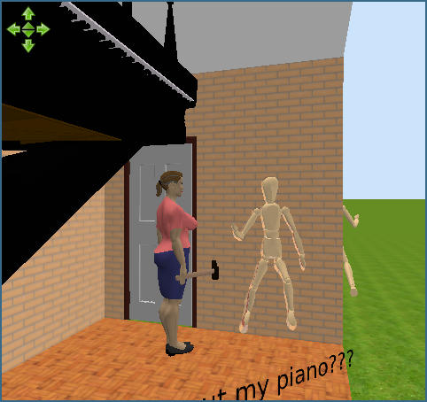

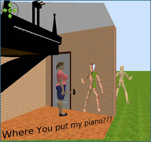

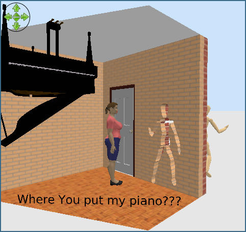

Well, when You have a hammer over head You make a hole instantly.
Now the steeps:
1. Peeve Your wife.
2. Export the mannequin as object; import as door
3. Insert it in a straight single (not splinted) wall. Will make the cut over contour.
4. Modify furniture -> Modify texture -> select all -> Invisible ->OK
NOTE: It don't work on angled or curved walls even for simple forms.
