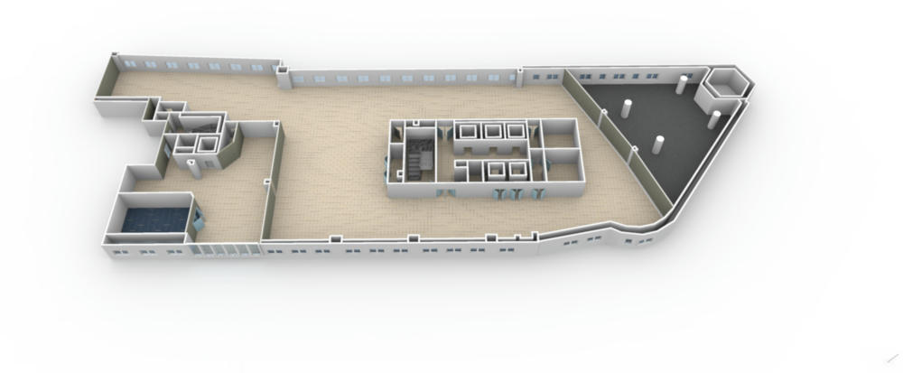

Cec, this is your file, just opened and directly rendered:
...as you said, no problem.

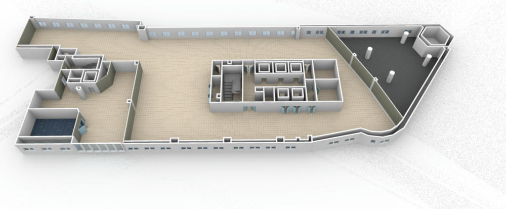

But zoomed in only a little bit:
... the problem reappears.
The biggest floor is a little bit displaced, so I tested if this can be the problem. But neither push it to the right position, nor delete the floor and rebuild it helps.

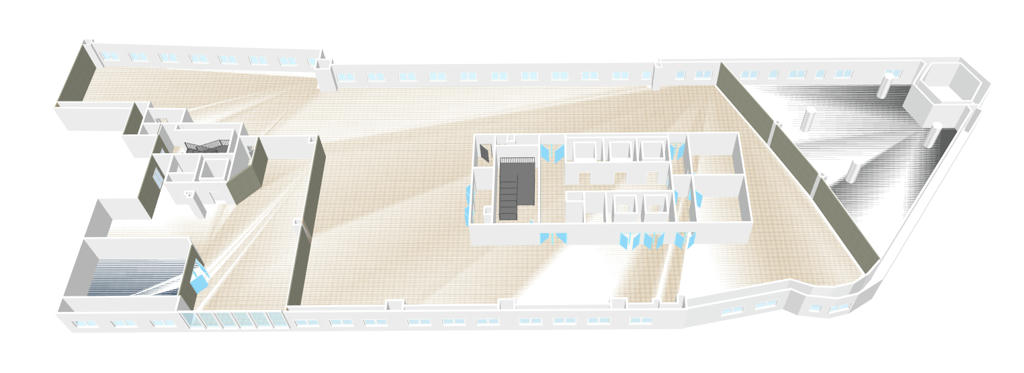

If you create a second level and then increase the original level by 1mm, you can see strange "rays" on the floors in the 3d view:
I suspect this has something to do with the problem, but I still can not figure out what exactly caused it.

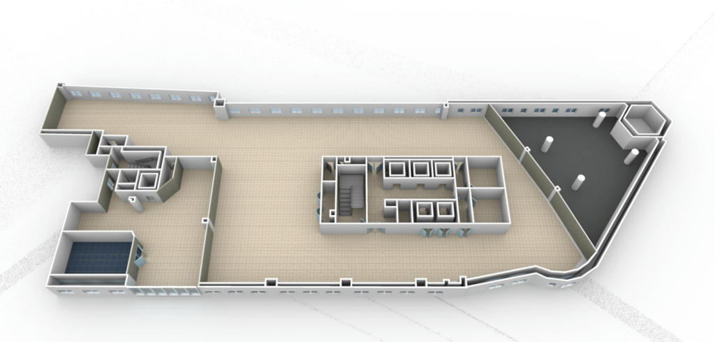

No luck, as before, just opened the file, switched from q3 to q4 and rendered:
Deleting the bg-image does not change anything.
I do not know what else to try, so I have to give up for the moment...

I'm pretty sure that these "noisy rays" come from how the ground is cut around your home with large triangles that goes from the house border to the far away border of the scene.
I noticed that kind of noisy effect in other situations with SunFlow at very high points of view, and it's a reason why I limited the eyes elevation to 100m.
Introducing a rectangle room will produce a much simpler cut out in the ground around that rectangle, with smaller triangles around the house which will remain in that rectangle.
