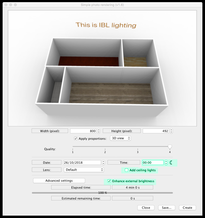

What is IBL lighting and where do you get it?
IBL ( Image Based Lighting) is using an image as a light source, instead of using the sun.
The exact terminology (IBL) is not used here, instead it's called: Enhance external brightness,
and can be selected as an option if you install ( or have installed) THIS plugin,
which also offers some other tools for enhancing the rendering process.
Settings:
The best way to use this for your project is to apply a totally white texture ( not colour!) to your sky and ground.
You could also experiment with panel lights to further enhance your renderings.

Thanks for all your help so far.
I have installed the 'PhotoVideoRendering - 1.6' plugin but it says it isn't compatible with the version of Sweet Home 3D.
I'm running SH3D v5.7
[Oct 29, 2018, 8:27:38 AM] Show Printable Version of Post    View Member Profile    Send Private Message [Link] Report threatening or abusive post: please login first  Go to top
Re: Background Pixelation
There are different versions of EnkoNyito plugin in his thread but you should better upload the new 6 version of Sweet Home 3D...

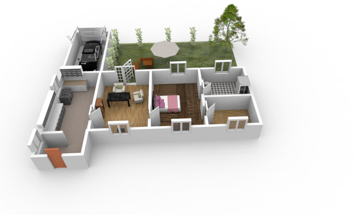

I installed Sweet Home 3D v6.0.
I chose a white texture for the ground and sky as suggested. I used white roughcast.
I checked the 'Enhance external brightness' box and set the time to 00:00 midnight and Q4, which it needs to be. As you can see from the rendered image, it is even worse than before and it took 10 times as long to render...51 minutes 40 seconds to be precise. Why it took that long I have no idea, it's not exactly very detailed.
https://www.dropbox.com/s/nqb2osf0z49uray/KWS_1stFloor%20-%20TEST.png?dl=0
I'm not producing very detailed 3D building layouts.
Where do I go from here?
Would it be easier for me to send the file to one of you guys with the proper expertise, to see if you can get it to render without pixelation?
Thanks.
[Oct 29, 2018, 10:43:21 AM] Show Printable Version of Post    View Member Profile    Send Private Message [Link] Report threatening or abusive post: please login first  Go to top
White is #FFFFFF.
THIS is a white texture
Here is how it should render
