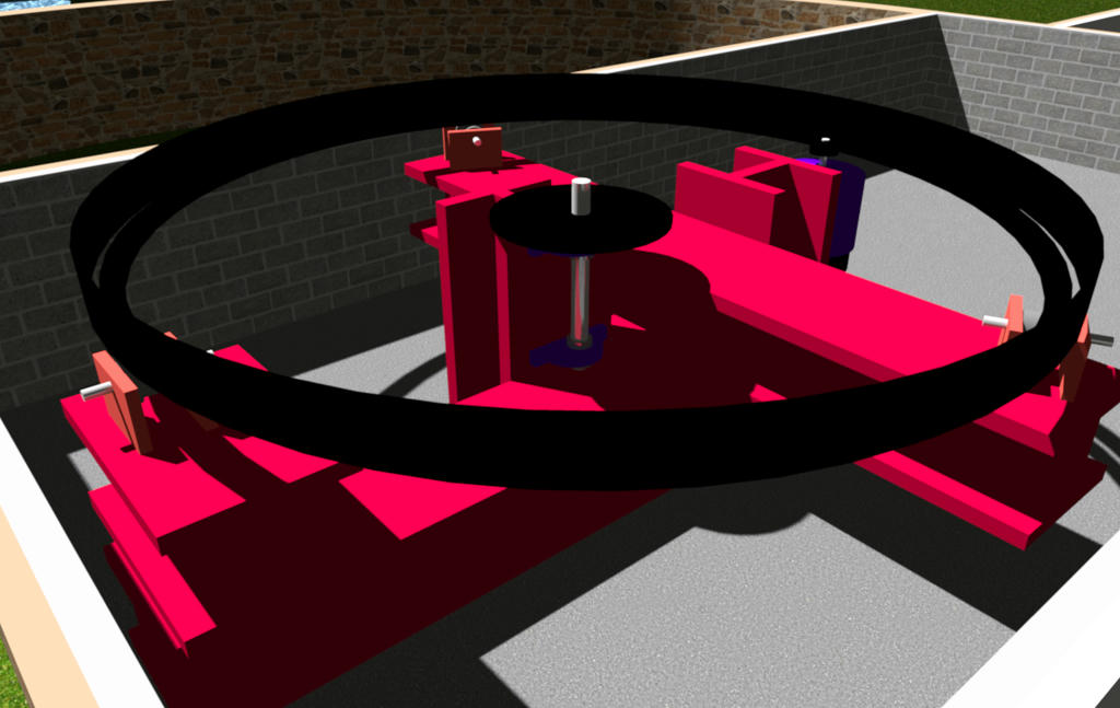

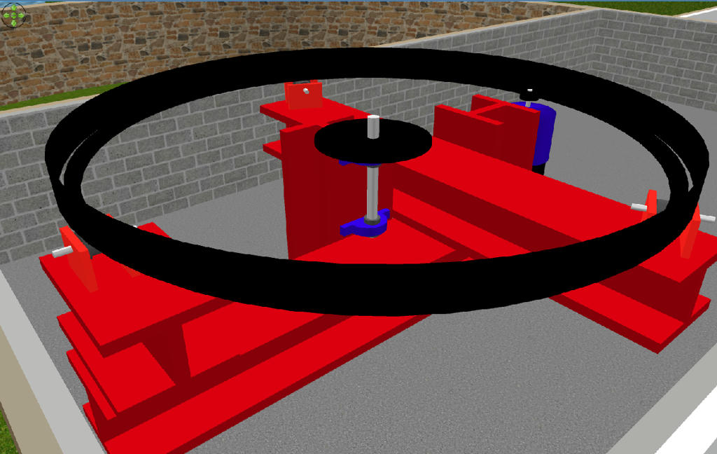

Not so sure this is a new topic, i seem to recall questioning it a couple of years ago, i have found that using textures is far more accurate than colors, here are 2 images, 1 a screenshot the other a render.
and this is a Q4 render
not only does the red change to pink but it also shows how different objects color differently, the I beams are rooms and the roller support brackets are box's, both have the same color applied to them.

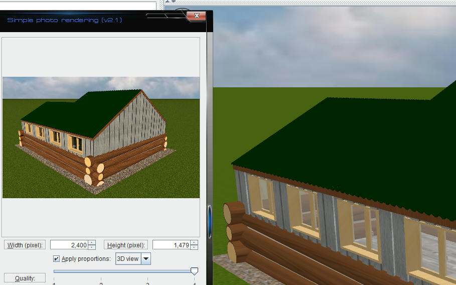

Re: massive color-difference
Not sure if this issue has been attended to but i am still getting the same issue
Roof with colour:-
Roof with texture:-
[Feb 21, 2021, 11:24:25 AM] Show Printable Version of Post    View Member Profile    Send Private Message [Link] Report threatening or abusive post: please login first  Go to top
Post Count: 4000
This is a known "problem". Using an even-coloured texture is the solution, as you already found out.
H
[Feb 21, 2021, 11:40:35 AM] Show Printable Version of Post    View Member Profile    Send Private Message [Link] Report threatening or abusive post: please login first  Go to top

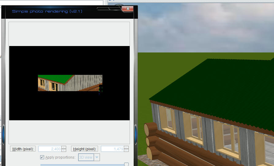

While we are at it, is my issue same as well? All my bright colors become pale when I generate an image. Please see attached.
Any setting I need to change while generating image?
Cannot attach any image host files for some reason. Tried imgur and prnt.sc`
