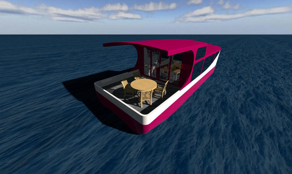

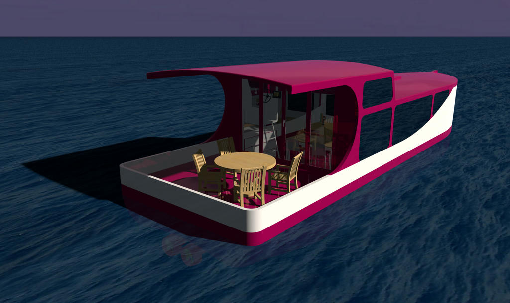

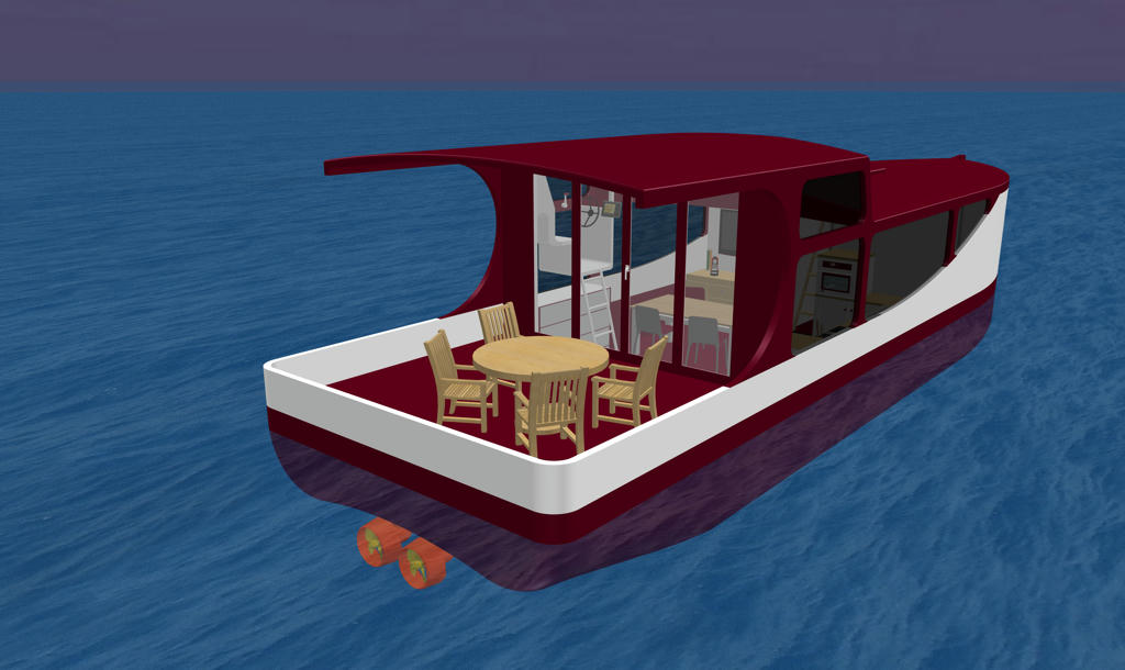

For a long time I have been wondering what the color difference between the two lower (1 & 2) and the two upper (3 & 4) rendering levels is all about.
As in the lower levels, I select the colors, read them from a picture or compare them with a pattern.
When rendering in the upper levels, the colors are too bright and far away from what I chose.
I've tried so much and I do not know how to continue. Is there a workaround?
Level 1 - How I wish it should be (Red)
Level 3 - How it turns out (Red)
I would be so grateful for a solution ...
Pascal

Could it be the material shininess? The ship material seems to be too reflective. Look at the white part at the ship's rear left corner. It's reflecting the illuminated zone of the floor. Look at the floor below the table and chairs too. It's reflecting the leg of the chairs.
I think that's the cause of the color change. Try to adjust the shininess on the material and it should help.

Unfortunately this is not the reason.
In this picture the whole back deck (the upper red part) is set to matt and it's not even a bit better.

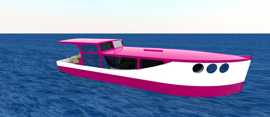

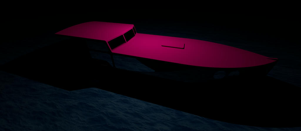

Time is set to noon, but in October.
So, I rendered a picture at 12:07 on 21.06.2018, the highest point of the sun this year:
And one at 23:22 on 21.12.2018, the middle of the longest night this year with a light panel above the boat:
Even in this dark night, you can see, the red colour is not as it should be...
