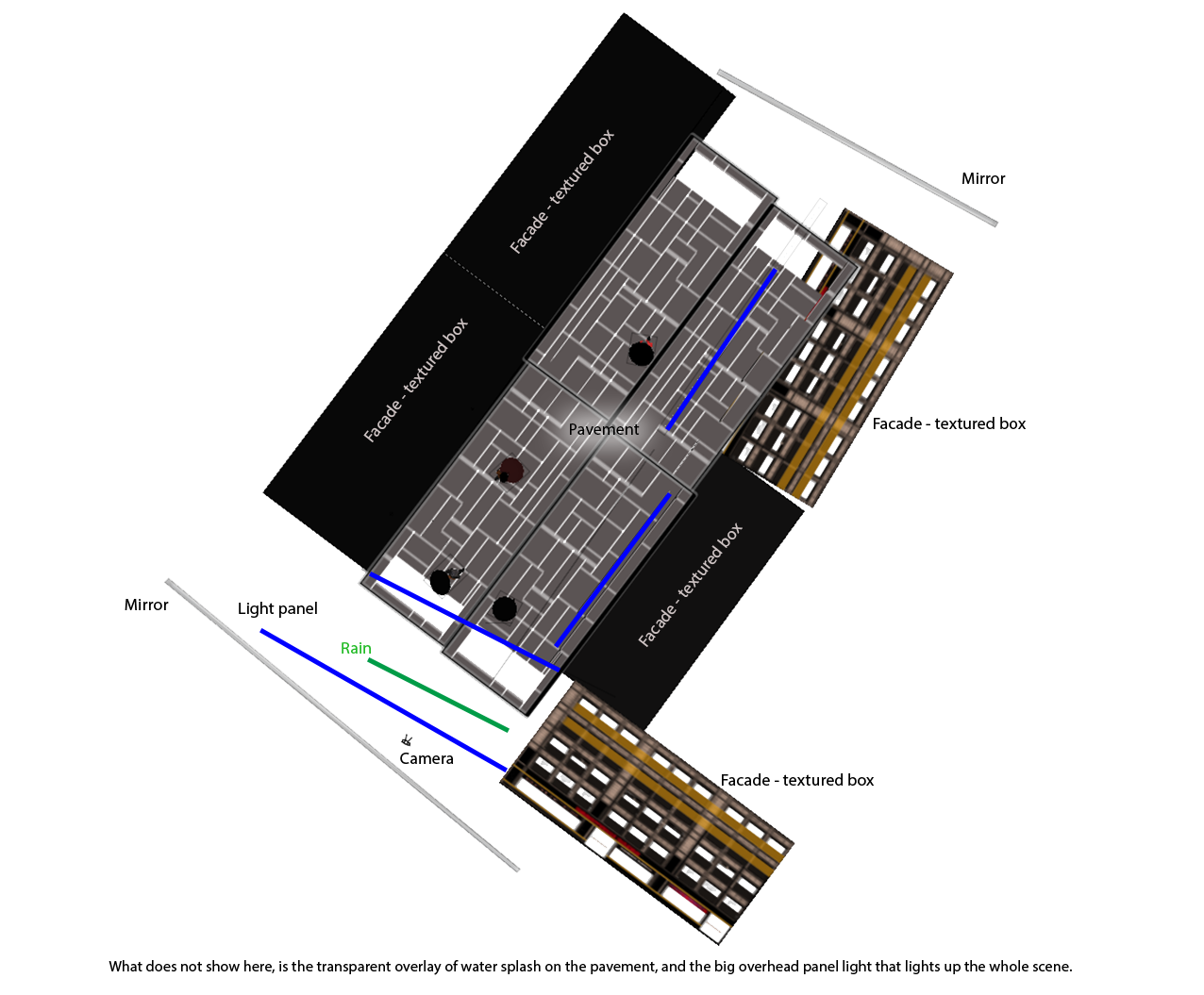

Let me show the layout from the project window:
As you can see, there are two mirrors, one at each end of the "street", facing another at an angle, so that the reflection in one mirror is reflected in the other and the angle creates a curved street.

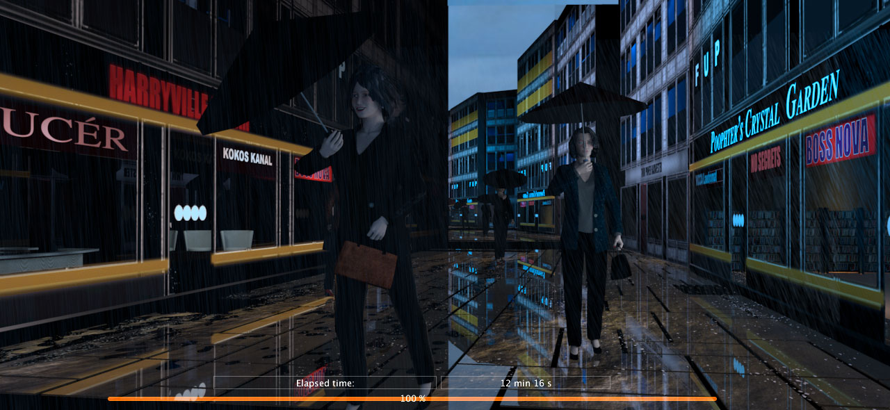

Here is a quick rendering to show the effect of the mirrors. It took 12 minutes on a 12-core Mac with 128GB memory :

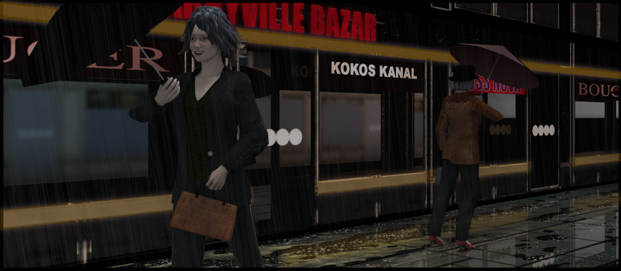

Sorry to have been vague as to what i could not understand in your image, it''s the name KOKOS and the 4 large white dots, these are either side of the figure in red shoes. The name appears almost as a shadow inside the shop, as do the dots, my mind just cannot figure out is, if its reflection, on what? if it's shadow, why color.
Ah, yes, now I see what you mean.
No mystery; It's a double layer of transparent glass that creates the "ghosting".
