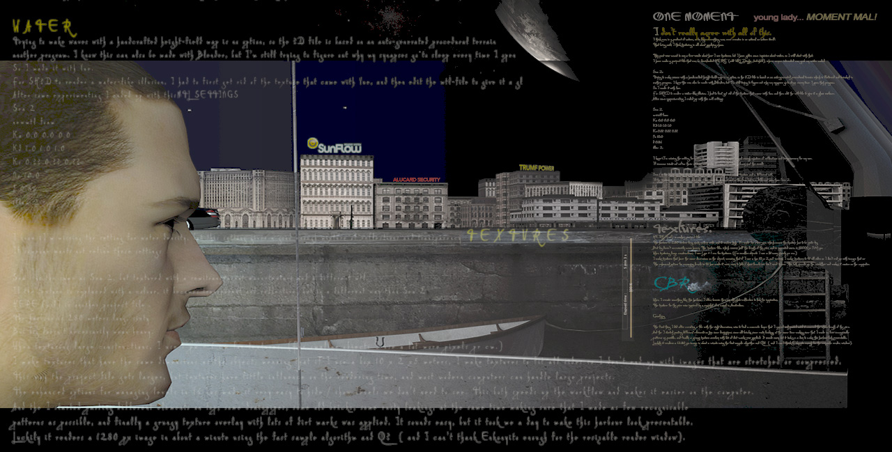

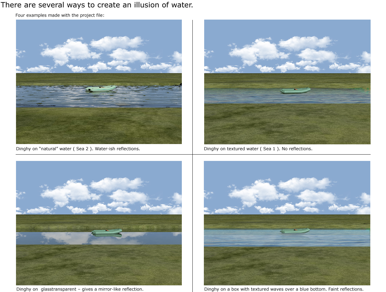

Water: Another 3D illusion:
I have made a project file that can be downloaded HERE.
It includes a downscaled water model ( 14MB) and some textures.
The 3D model is based on an auto-generated procedural terrain which I tweaked in a program called VUE eXtreme,
using some random-generated patterns.
I know this can also be made with Blender, but for me using Blender is no option yet.
(I’m still trying to figure out why my synapses go to sleep every time I open that program.)
Just so it’s mentioned; trying to make waves with a handcrafted height-field map is a waste of time. We can't do random like a computer.
Well, a computer can't really do random either, but it does it better than me.

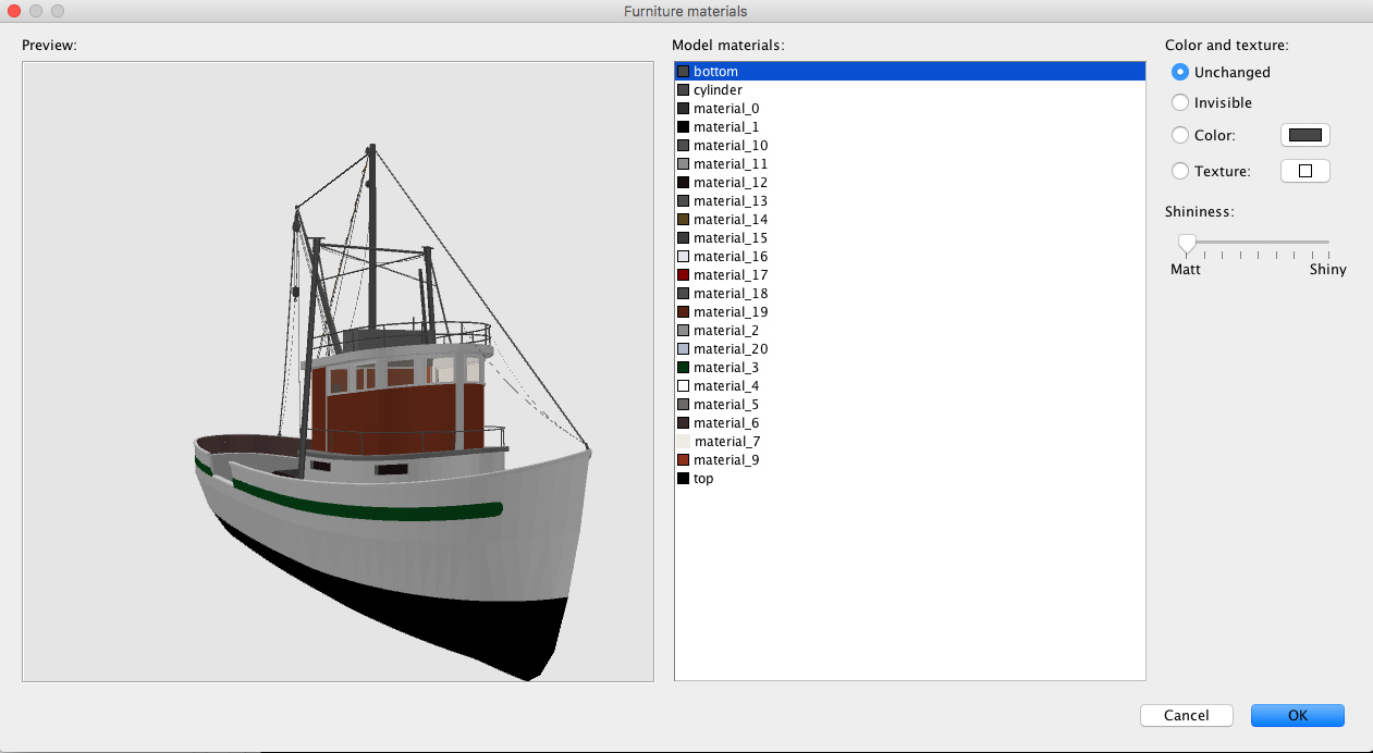

To get SH3D to render a water-like surface from this random-generated water model, I had to first get rid of the foam texture that came with Vue,
and then edit the mtl-file to give it a glass surface.
After some trying and failing I settled for this .mtl-file:
SEA 2
newmtl foam
Ka 0.0 0.0 0.0
Kd 1.0 1.0 1.0
Ks 0.33 0.33 0.33
Ns 10.0
d 0.86
illum 2
I’m aware that I’m missing the density, but this setting gives a good enough mixture of reflections and transparency for my use.
If someone has the time to rework these settings and make it more water-like, please share the result.
In the project file " Sea 1" is the same model as "Sea 2".
The difference is that "Sea 1" is textured with a semitransparent wave-texture and has a different mtl.
If the texture is replaced with a colour, Sea1 also becomes transparent and reflective like "Sea 2," but in a different way.

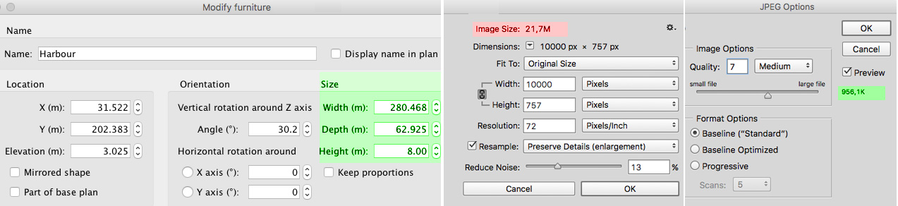

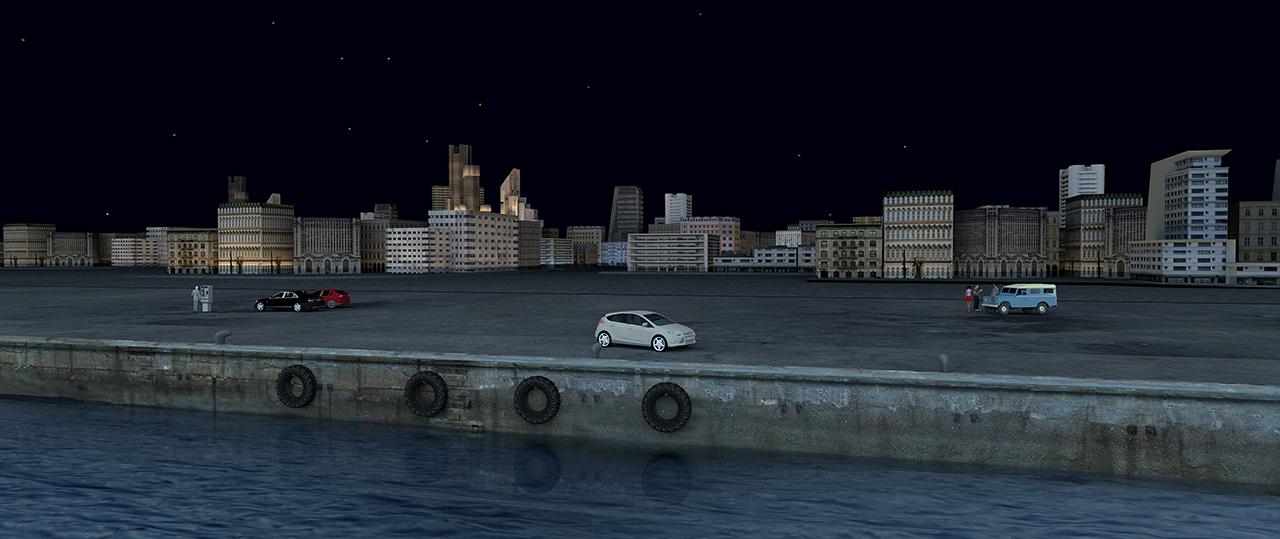

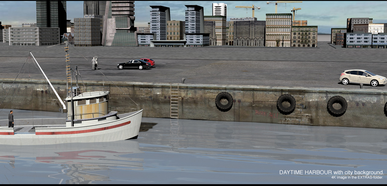

The pier is 280 meters long, sixty meters wide and 8 meters high, which means the texture has to be quite big if I want good renders.
But big doesn’t necessarily mean heavy. Big means keeping the size. High resolution and high compression render a much better result than low
resolution and low compression.
The texture file for the pier, which covers half the length of the pier and is repeated once, is 10000 x 750 px.
When texturing large constructions, I use 1 px = 1 cm for textures.
That means I can get a fairly good rendering from a “normal” distance.
For real close-ups I have to make the texture at least ten times bigger, or I can cheat by applying a higher resolution texture to only the part that’s in
the frame, a bit like I do with the water model; move it around to cover exactly what is needed.
I generally make textures that have the same dimensions as the object, meaning that if I use a rectangular box I make textures to proportionally fit all
sides so I don’t end up with images that are stretched or compressed.
This way the project file gets larger, but textures have little influence on the rendering time, and most modern computers can handle quite large projects.
The enhanced options for managing levels in V6 has made it very easy to hide / show levels we don’t need to see. This both speeds up the workflow and
makes it easier on the computer.
When I create something like this harbour, I often browse thru my old photo-collectors to look for inspiration.
The pier ( and the texture) were inspired by an old snapshot of a canal in Amsterdam.
It wasn’t good enough to rip any texture from it, but it gave me some ideas.
When making a texture as big as 10000 px, the first thing I do is to fill the bottom layer, creating a foundation for the different elements I will paint it with.
For the pier I chose a concrete foundation that I copied and pasted until it covered the whole length of the pier, and pasted different elements on top; some
drainpipes, some old bricks, some rusty leaking and some spots of dirt – trying to avoid making recognisable patterns. Finally I applied a grungy texture overlay
with lots of dirt.
It sounds easy, but it took me some hours to make this harbour look somewhat presentable.

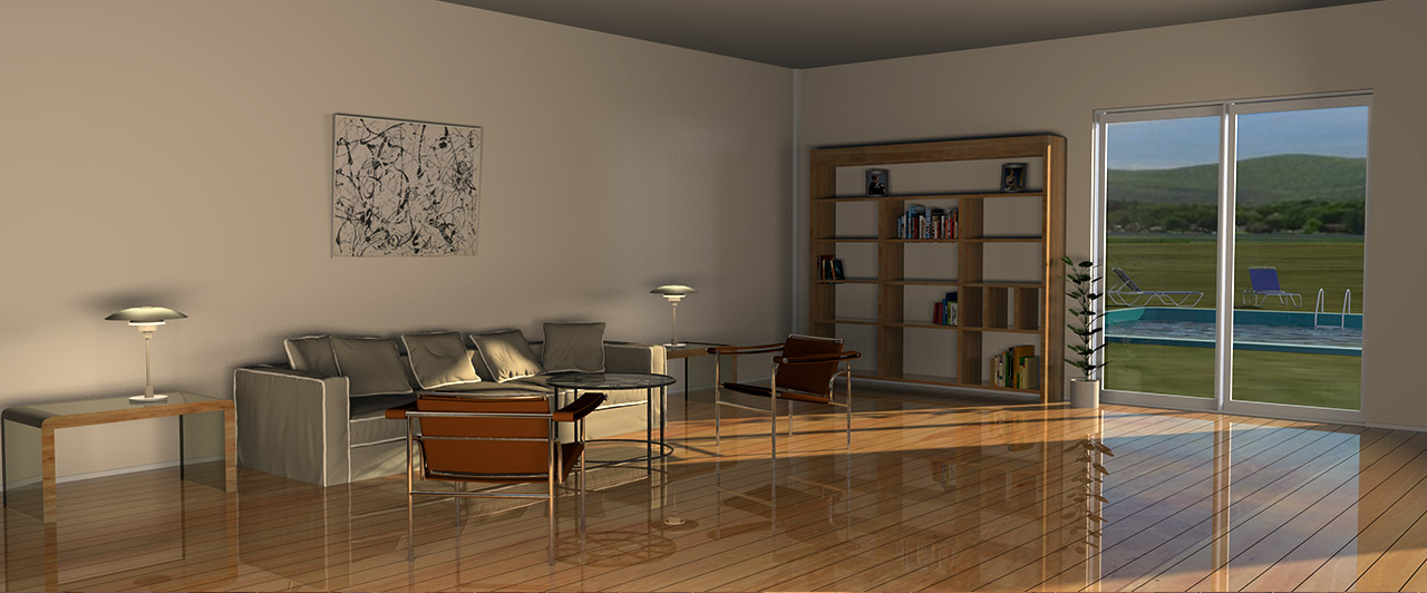

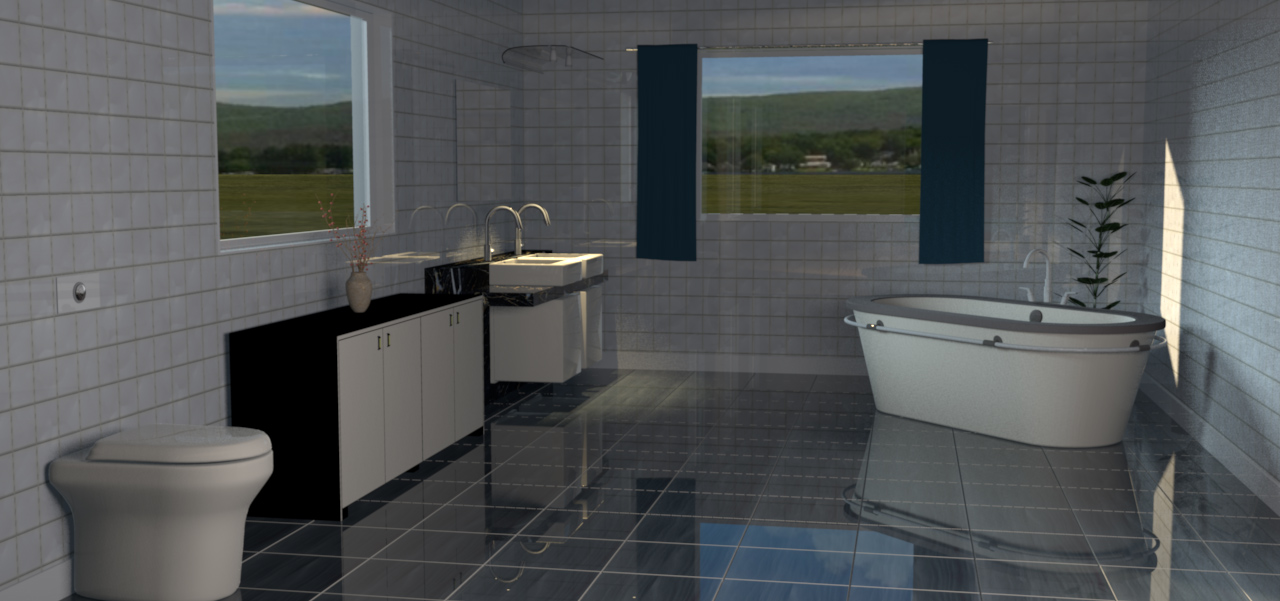

Floorboards and tiled floors can easily be made with Photoshop ( and maybe with Gimp?) using 3D extrusion.
A model can be textured with any kind of texture, or just coloured, without losing the structure.
Here is a project file: Flooring.sh3d.
I have made some example renderings.
Livingroom floors:
Bathroom floors:
(For shiny floors, give it a bit of shininess and set the ShininessShader to Glossy when rendering.)

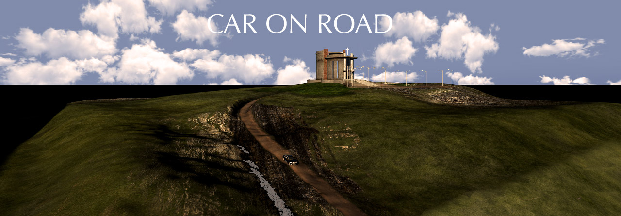

A short comment on texturing terrains ( answering some questions I have got on email):
Everything is easy when you know how to do it, but I know from experience that creating complex height field maps take a lot of trying and failing.
The easiest way to start is to use Verto Studio 3D as terrain generator, and to use Gimp, Photoshop or what have you, to start playing with gradients and grayscale.
Designing a correct height field map that perfectly reflects the real surroundings of a house, is more than I’m able to.
I know there’s a way to accomplish this by using Google maps
and a new plugin made for Photoshop, but I’m not familiar with that technique yet.
Answering a question about texturing a terrain:
If it’s a terrain created from a home-crafted height map, it’s quite easy; just enlarge the height map and start applying textures to the right places.
I will show an example on how I do it:
It’s a try and fail game, so be patient. This took some hours:

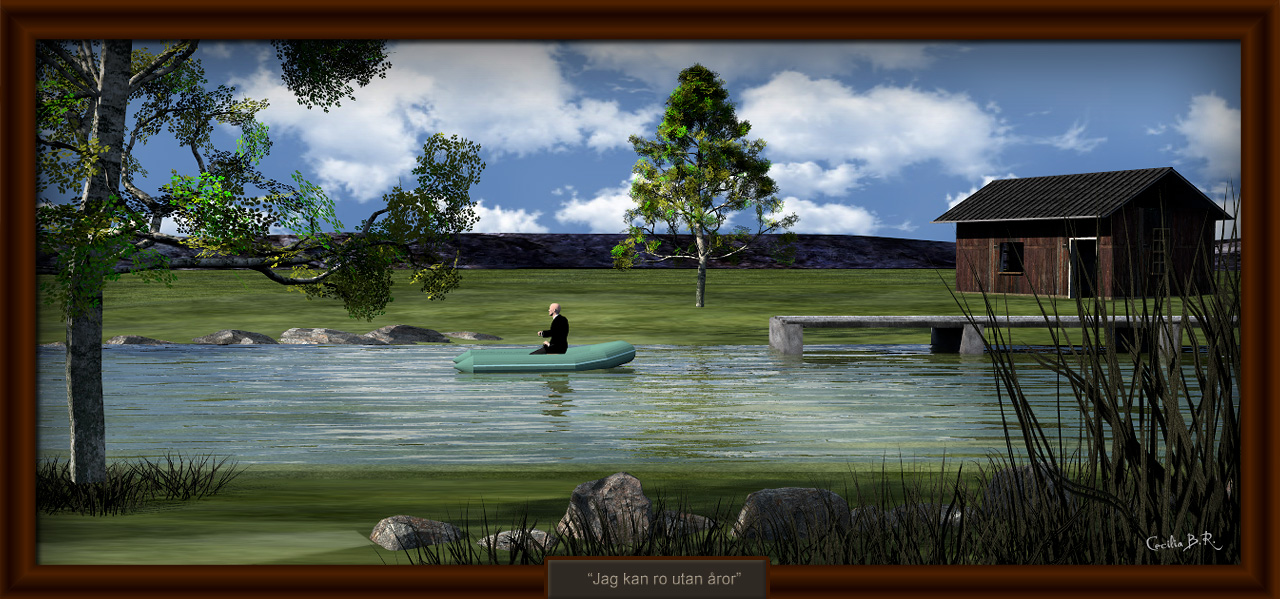

Just noticed the title of the last image: "Jag kan ro utan åror"
It's actually quite funny, meaning I can row without ores
The title is taken from a Swedish song, known all over Scandinavia.
