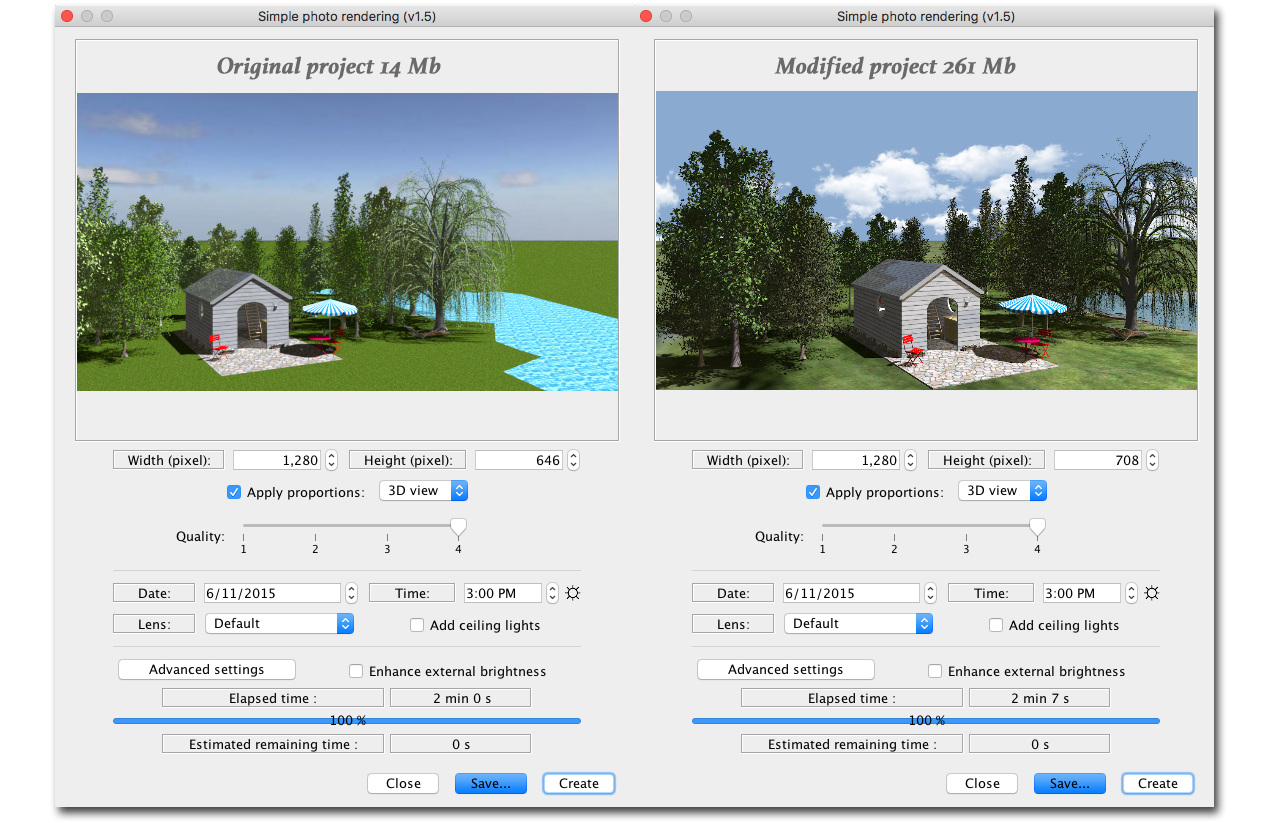

Here is a snapshot of the untouched original project file, rendered with the default render settings for Q4:
The plan is to make some nasty modifications to the project and create a file that is a lot bigger.
The first thing I will do is to delete the water and add a slightly sloped terrain with an immersed pond at the highest point. That will increase the file size with some 100 Mb.
Then I will add a ground texture and a sky texture, some gras, stones, plants and so on, plus a terrain to cover the horizon, which will add another 40 Mb.
Then I will work on the trees.
I will keep them at their current position, but I will add textures to the leaves and get rid of the shininess that's always present in these models.
There's a lot of trees, so that probably adds another 30 Mb to the file size.
I will also add two new levels: One for the terrain ( at ground level ), and one for things that shall stick up from the terrain, like stones and plants.
Then I will elevate the two original levels by what's necessary to make the house level match the height of the terrain.
At last I will add a high-res hemisphere to cover the entire construction, but I will keep it invisible until I need it.
After doing all this, the project file is 261.8 Mb : SweetHome3DExample9-WoodenShed-CEC.sh3d
This project is made with Version 6 beta 11. It might not render snapshots when opened with older versions.
Everything I have added is marked with a "Z" in front of the name, and will naturally come at the end of a list sorted by name.
The "Z"-marked models are my creations. Feel free to grab anything of interest.

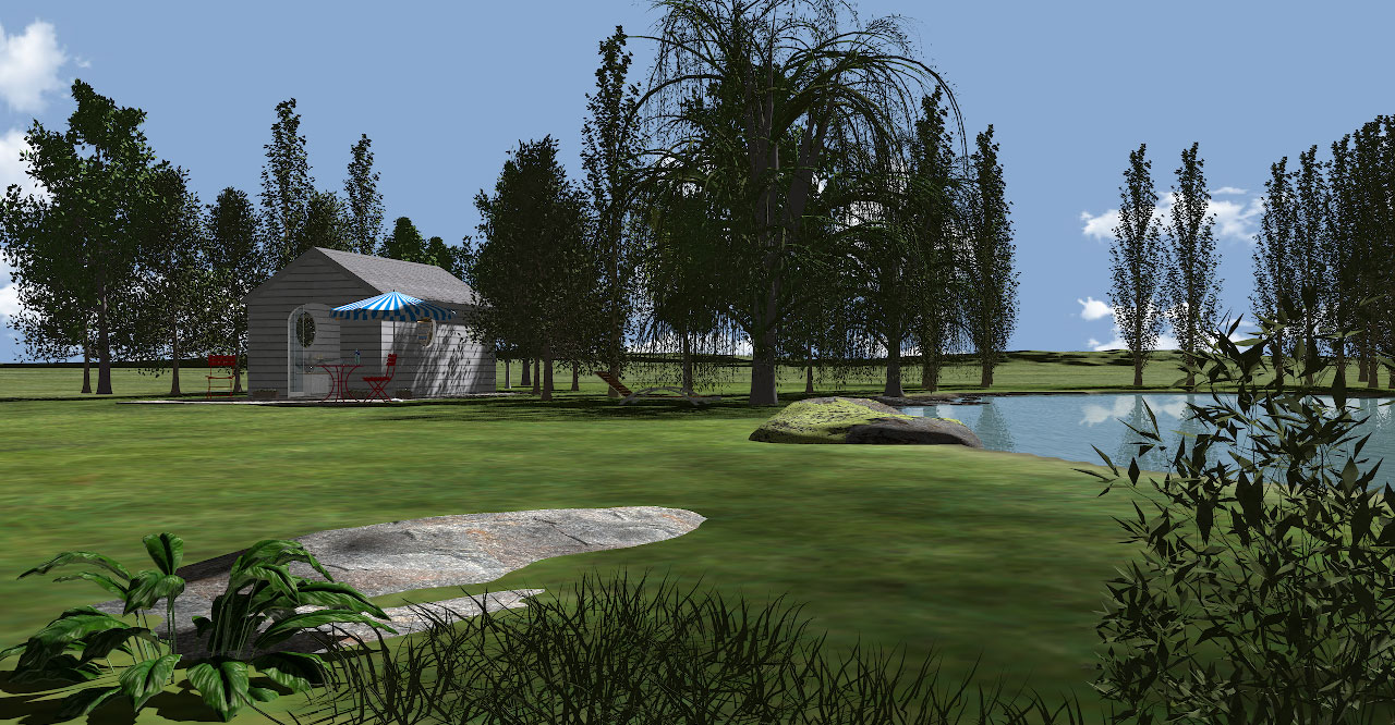

Here is a snapshot of the modified project, shot from the same angle and the same settings as the original:

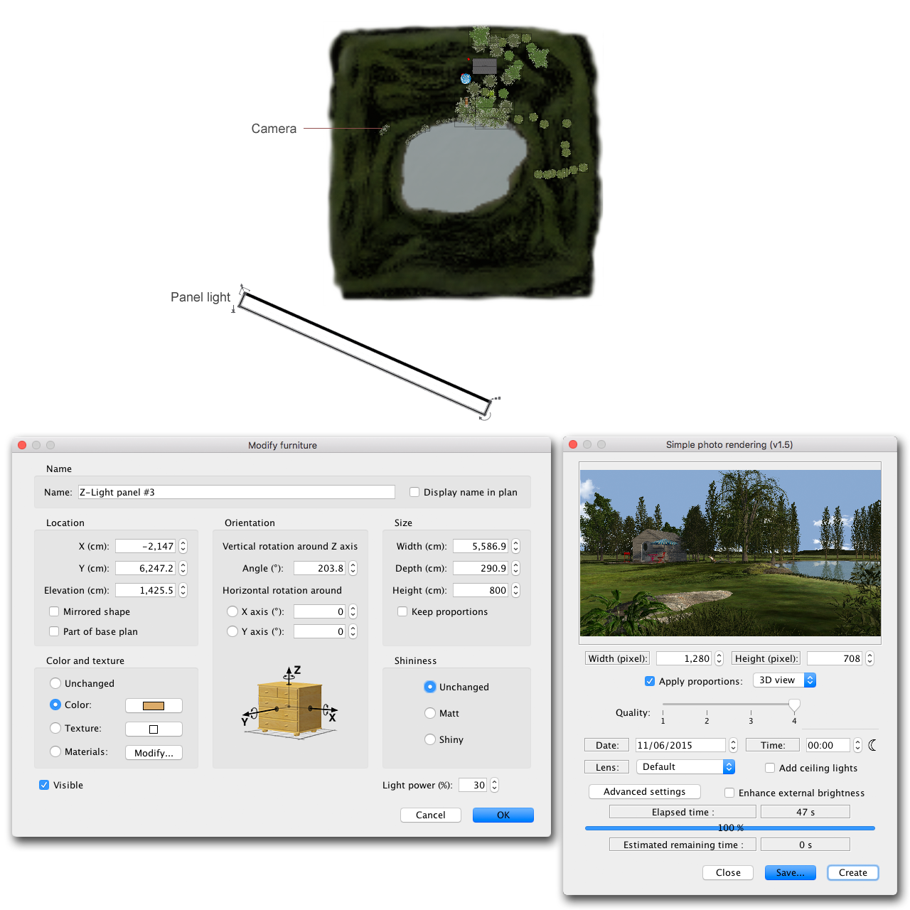

First I will add an orange panel light to substitute the sunlight, and set the time to midnight.
Here's the result:
Using a light panel to substitute the sun obviously gives a lot of new lighting options, but what if I place a hemisphere over the entire construction?
I can shine a light on it and use it as a sky image...
...and create moods and atmospheres that I sincerely doubt can be created this easily with any other 3D program.

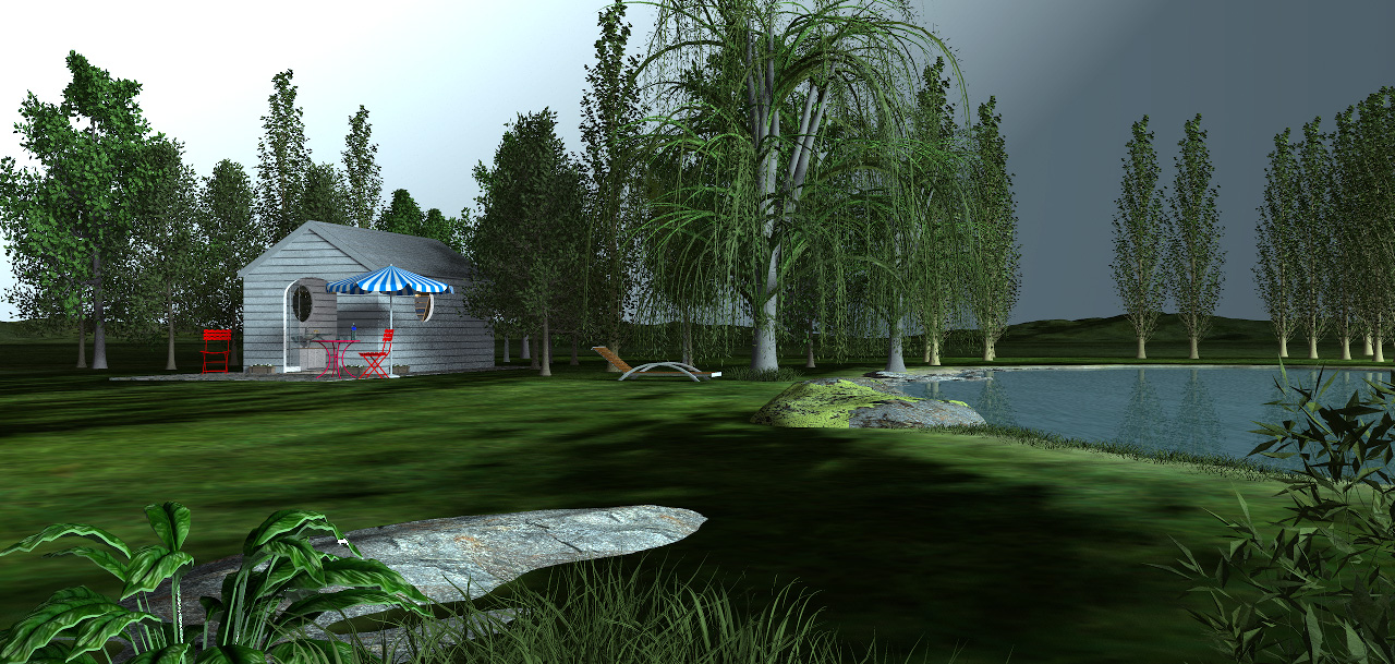

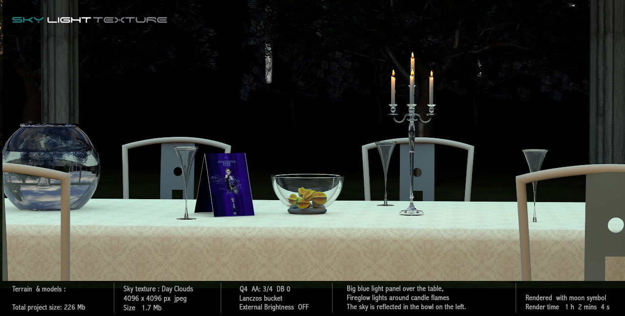

The following snapshots are results of my first experiment with the new light panels.
They are all rendered with no sunlight ( moon symbol), and I’m only using light panels.
