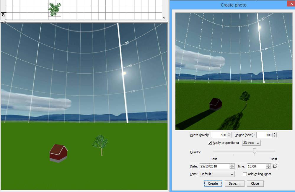

You may also have mentioned this, at least implicitly, but the sky texture starts and ends RIGHT in the SH3D view. I.e. if the SH3D compass points the default North, the panorama texture will begin at due East.
So far, so good - 4:1 (360×90) grid, vertical degrees compress towards zenith to adjust the panorama gives a general feel for the location with approximate views from around the house. Forgetting picture perfect for a second and thinking vertical accuracy: what is the best scale? Sure, I know there is a difference between 3D view and hq rendering (feature request 668). And as long as I can get a general idea what I will see from my favourite chair, I can live with inaccuracy (gave up on an accurate starry night sky smile ). But I have this unpleasant feeling that I am missing something with my 360×90 grid.
The image below is late October midday sun at 60° North(should be some 18° above horizon - placed on in image as illustration). But in addition to the 3D view showing more sky than the rendering, I cannot really make up my mind whether it looks (approximately) right.
Btw. and just for reference for anyone coming across this thread, there are some good tips in the blog too:

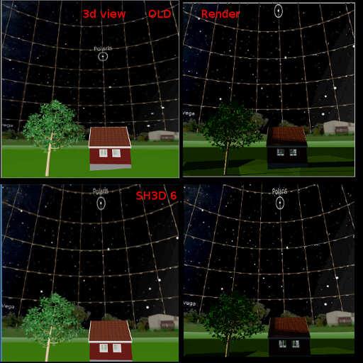

Note that the version 6.0 should also fix the frustum issues that remained.
[Sep 5, 2018, 9:50:01 AM] Show Printable Version of Post    View Member Profile    Send Private Message [Link] Report threatening or abusive post: please login first  Go to top
I'm going to try to fix the issue that shows a different mapping of a sky texture in the 3D view and in SunFlow...
Maybe, it is just me, but it would be a great help if 3D view and rendering were the same. And even better if I could understand the projection and manage to make a reasonably accurate template... smile
Sorry for messing with your thread Cec, but I could not help thinking about the vertical scale after more testing with your brilliant template. And although I am mathematically challenged, maybe it is as simple as calculating the sine of the angle to place the horizontal lines (???). I put it into an .svg template (which again can link to a panorama file for scaling, link is Inkscape compatible).
A matching view between the 3D preview and the rendered image would be great!
Tsk tsk tsk... isn't it just a 4 by 1 rectangle projected on a hemisphere? So all we have to do is make an attempt to invert the distortion... right?
Sounds easy... but I know it isn't.
Anyway, let's try a quick & dirty inversion-method:
Example rendering:
It seems I could have curved the sky image bit a bit more. Try and fail is the name of the game. But it seems to work – to a certain extent smile

fix in thread 8704 and SF-req 668. @Puybaret: Perfect. THANKS for the fix! The 3D sky now makes more sense.
Thanks for the many hints and alignment/distortions. Yet to find out how to save time with Hugin, but I remembered Stellarium (celestial software) which has customisable horizons and backgrounds and when viewing it is possible to use different projections. Testing default ground image (i.e. horizon panorama) + cylinder projection: a night sky for SH3D with grid match and correctly placed celestial objects (at N46.108° E4.78° at some time I cannot remember).
Using stellarium_horizon.jpg gives this render:
Works for my purposes and suggests that Stellarium could be of help when matching sky imagery, placing sun, but also, I guess for making distorts for alternative rendering perspectives as discussed by Cec above.

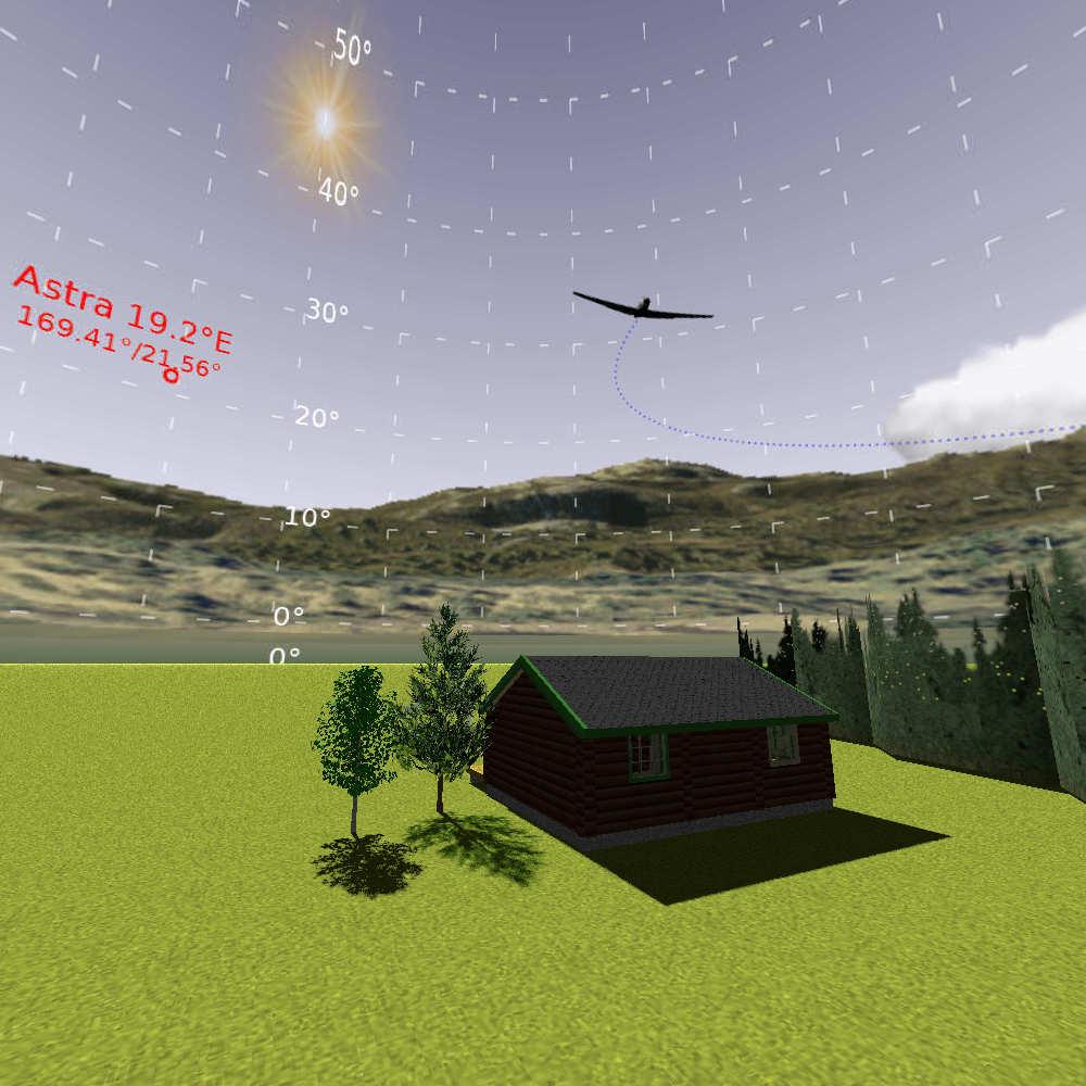

I love Cec' beautiful images, but as opposed to Cec' aesthetic approach, mine is simpler and just practical. Say you consider building a lodge in a given position.
- Use a panorama of the skyline (real or with online tool), place in grid template.
- Use some sun calculator to determine how high above the horizon the sun will be during normal holidays.
- Use a satellite calculator to determine the position of you favourite information provider.
- Check out other stuff, like nearby airports.
- Find direction(/distance) to various points, summits for hiking, GSM transmitters for broadband, etc etc.
Place all of the above in the template and use as a Sky texture (starting at 90° in the plan, due East when compass points North). Place terrain, trees, buildings and other close obstacles in the plan. You now can visualise several things. Where to point the dish and broadband antenna. Where to place solar panels. How to orient the plan for sun conditions. Which views you will be able to see from your favourite chair through which windows. Whether the airport flight path could be a problem. In addition to all other stuff, of course: grid/water/road access, meteorological statistics, ground condition etc. Arguably too geeky for most plans, the example is based on a real project. It turned out that it would be near impossible to get decent sun conditions in the winter, we needed a different GSM provider for broadband, terrestrial TV would be difficult, but satellite should be ok, airport might be a problem as afternoon flights would often pass just above. All of this could easily have been discovered without the sky texture, but having the visual while drawing proved very useful: once the lodge was oriented for perfect afternoon sun, it turned out it would be difficult to place solar and dish, and the entire lodge had to be mirrored to avoid getting the entrance blocked by snow in the winter.
A higher resolution of mountain_cabin_texture.jpg renders like this (wide angle virtual visitor gives a distortion, of course):
Sunlight simulation is a perfect way of playing with sun conditions at different times. Btw. rendering sunlight seems to consider (the silly concept of) daylight saving, but not equation of time I think. At least I think that is why there appears to be a very slight mismatch (<4°) certain times of the year - or it could just be me. But it makes absolutely no difference for my purposes. I suppose one could also consider elevation of viewpoint / plan and estimate distance to horizon for the template.
Cec' template is probably better and easier to use for most purposes and work with most graphic editors. However, for accuracy and editing I prefer an .svg template to position (and distort) elements on the sky texture. For instance a 360° panorama .svg file with a grid, sky- and ground gradients and with links to other files: skyline, clouds, sun. That way it is relatively easy to place (and transform/distort if need be) each item accurately (with manually/Inkscape). Like Cec, I use a 360×90 template, with a few degrees extra at the bottom to blend with ground texture. Once each item is placed (and grid removed), the image can be saved as .png/.jpg and used as a high resolution sky texture.
