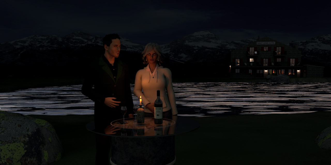

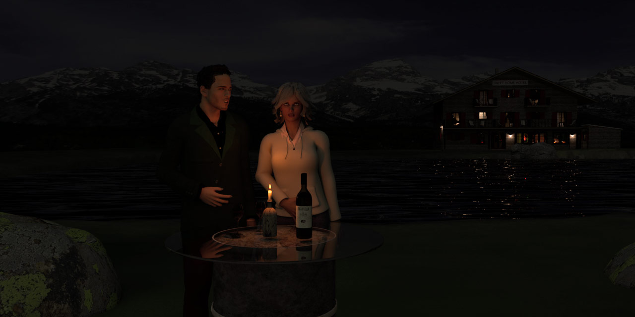

This imagae took me 72 hours to render.
I used 849 light sources for this image: 670 panel lights #3, 63 panel lights #1 and 104 incandescent light sorces + 12 opaque sphere lights.
To get the lights right, I used about 30 test renders in Q3, using the fast samplerAlgorithm, and even with the fast option, the rendering time was about 25 minutes, so it took some time to do this.
The project file is 4.62 Gb
Merry Christmas everyone!

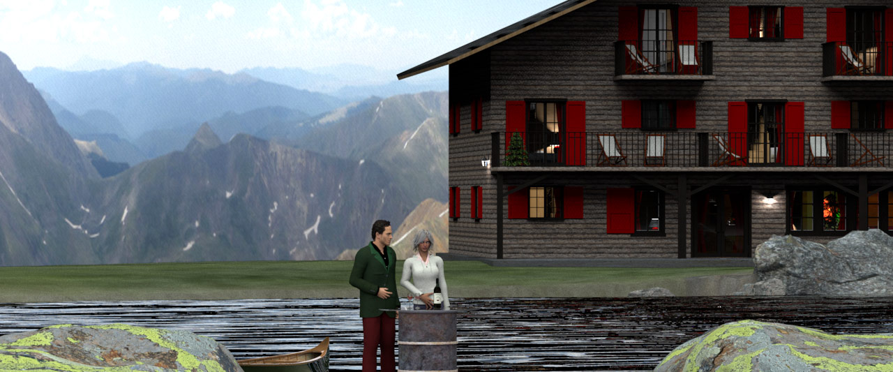

Textured sky vs. backdrop
The most obvious disadvantage with using a textured sky, is that it will always be rendered as it is, affected by neither our light sources, nor the time of day.
This means that the scene itself will have to be colour-matched to blend in with the sky.
Example of sky texture:
@ FoW = 63.
Another disadvantage with using textured skies is that when zooming in to a lower Field of View, the quality of a sky texture is reduced.
Here is a shot @ FoW = 25.
Good backdrops can be difficult to find.
Images will always have shadows that indicates the direction and angle of the sun, which can be a problem.
Backdrops will normally cover only a small sector of the sky. This can create some trouble with reflective surfaces ( like windows and water).
Since all reflective surfaces need something to reflect, we need to provide it.
A light source is not enough. Another backdrop can work, but a textured sky will always work.

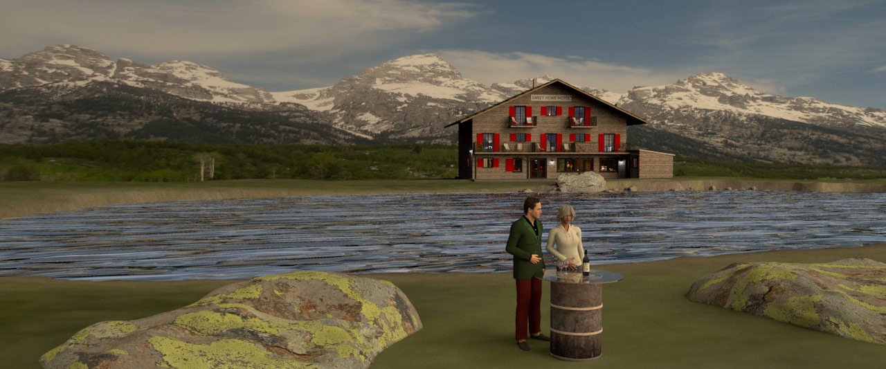

Using backdrops can give us several advantages on condition that we are willing to put some work into it.
One advantage is that a backdrop will be affected by the way we light it.
The project file shows one example of how to blend a backdrop with the rest of the scene.
This is the image you get when rendering the project file as it comes:
Changing the colours of the panel lights can create different ambiences.
Using white lights:
Using low intensity lights:
Of course a general tint can be applied in post production. There are hundreds of free luts that can be downloaded, and many of them can create amazing results.
Myself I find using Enkonyito’s panel lights to be a much more controllable and better solution.
Another advantage worth mentioning is that a backdrop is resizable so we can avoid loss of quality with lower FoW-settings.
Example: Resized backdrop for a closer view ( FoW=25 ):

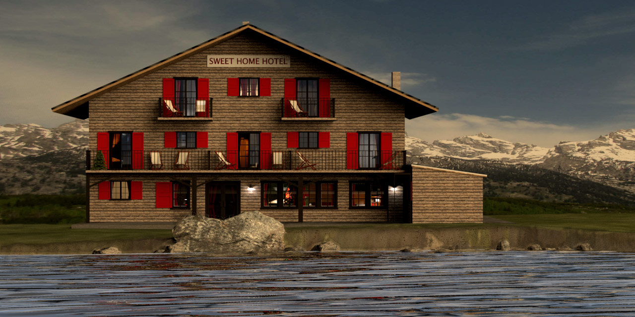

The Breakfast room.
The backdrop is moved and resized to be visible from both windows. (The best presentation of a room is a diagonal view.)
I’m using a combination of panel lights and sunlight ( 15:00 )
I have added some panel lights outside the windows. Intensity 50%. Default colour.
I have reduced the intensity of the pendant lamps to 5%.
Added a panel light at 270 degrees. Elevation 130 cm. Intensity 8%. Default colour.
Added a panel light at 90 degrees. Elevation 160 cm. Intensity 2%. Default colour.
Both panel lights are covering about 70 % of the floor surface and placed in the middle of the room.
I probably should have reduced the shininess of the pendant lamps to 0 in order to avoid the outline that draws attention to the low resolution.

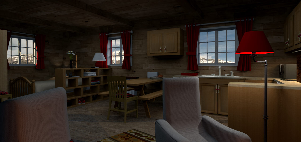

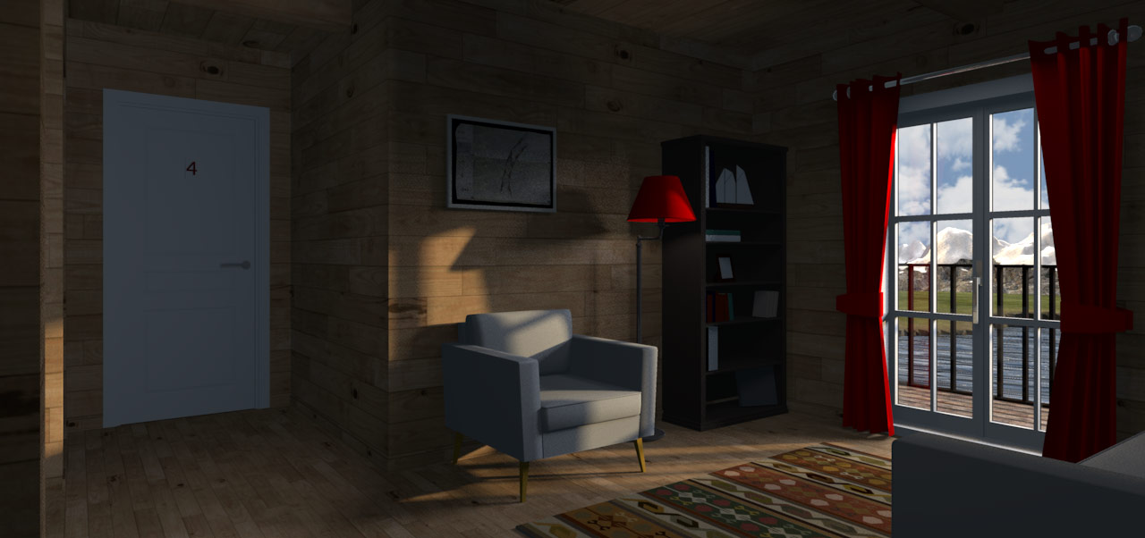

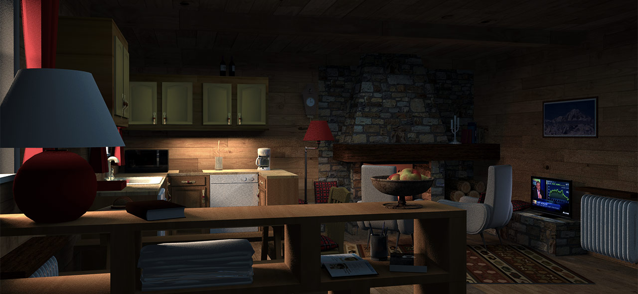

Small lounge outside room 4, 1st floor.
Removed the shininess from the filled bookshelf, and coloured it with a slightly darker colour to create a contrast to the walls.
Added a panel light at 270 degrees. Elevation 230 cm. Intensity 8%. Default colour.
Added a panel light outside the balcony door. 50% intensity. Default colour.
Sunlight 15:00.
(Forgot to remove shininess from the curtain rod.)

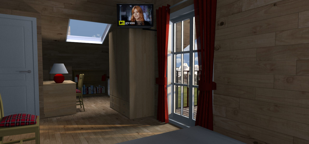

The attic room
Added an image to the TV.
Added a slightly transparent (opacity 90%) red fabric texture to the curtains.
Placed an overhead light panel at 90 degrees 50 meters above the window. 50% intensity. Default colour.
Placed a panel light outside the balcony door. 50% intensity. Default colour.
Sunlight 15:00.

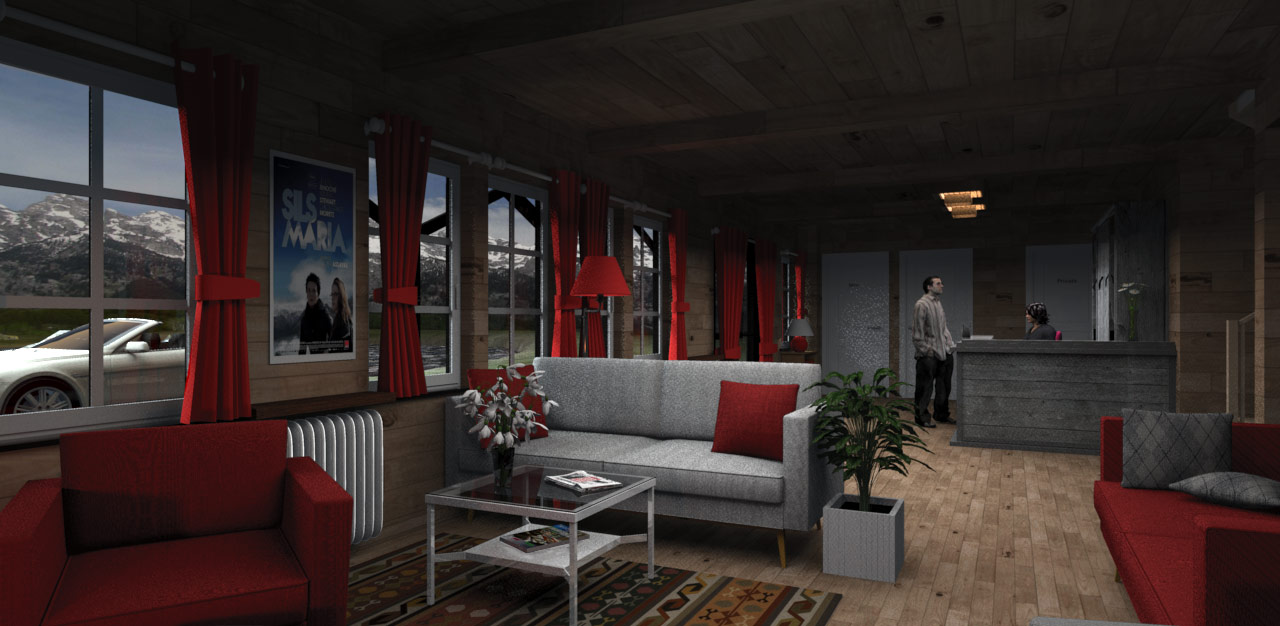

Reception.
Added texture to the sofas and the armchair.
Added a table, some flowers, a magazine and a newspaper.
Added a poster.
Added some light over the counter, and placed some people there.
Added panel lights outside the window.
Placed a BMW cabriolet outside.
Forgot to fix the shininess on the doors.
