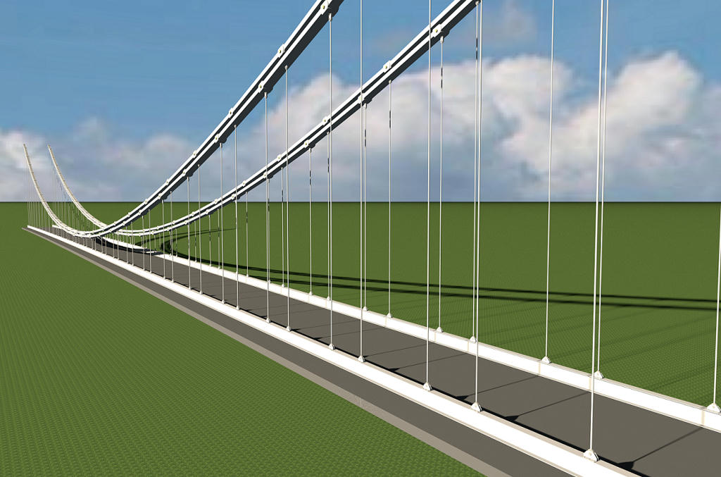

A few weeks ago i took my grand kids out for the day, and had, what i thought at the time, a good idea for a new project, now, after 5 weeks of positioning components, maybe not such a good idea, but certainly a challenge to both myself and SH3D, SH3D is doing much better than me.
Little of what i have achieved so for would not have been possible, or atleast, far more difficult, without Emmanuel's X and y modifications mod. wink.
Here is a link to what i am hoping to, eventually, achieve.

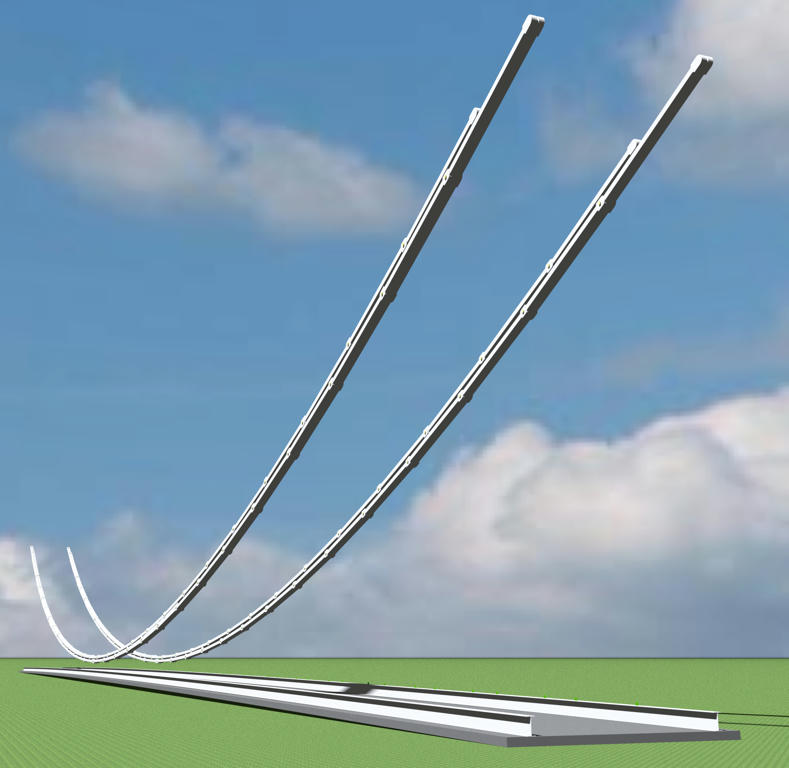

Each 8 meter link comprises 10 or 12 leaves, 10 for the inner link, 12 for the outer, each leaf is a room as is the nut.

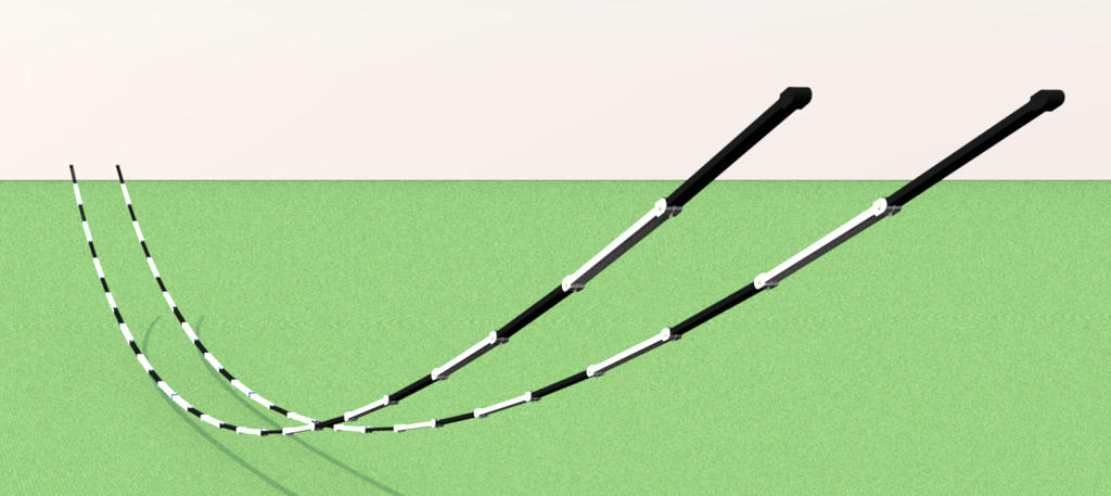

Here they are black and white to aid me lining them up and setting each ones elevation and angle.

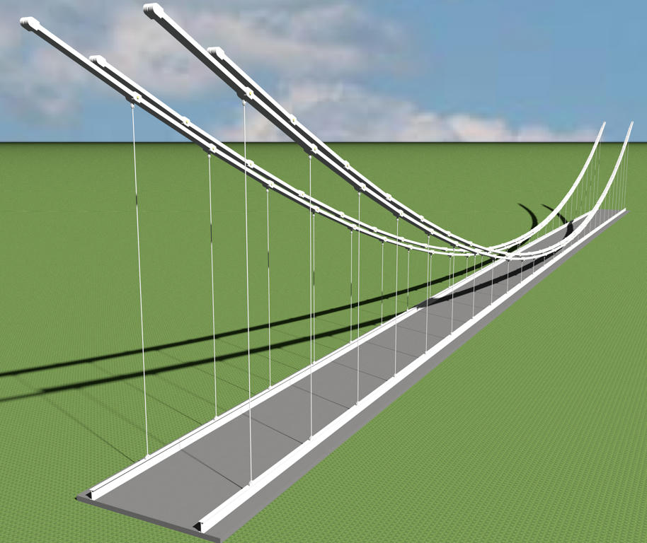

With 2 pairs of chains in position, there will be 3 pairs, you can see the offset of the links which will enable me to stagger the link arms down to the road evenly.
The link arms i have set up as groups, which comprise, a bottom bracket and its ball joint, these are a single object, the link arm and a top bracket with its ball joint, this means that i can position the whole group and set its elevation to the "I" beam, then elevate the top bracket, tweaking the groups position to locate on the chain and finally adjusting the height of the link arm.
For the 2nd chain the grouping is the same but the top bracket has longer hangers to fit through the lower chain, the 3rd chain will have its own top bracket to fit down through both the 1st and 2nd chains.

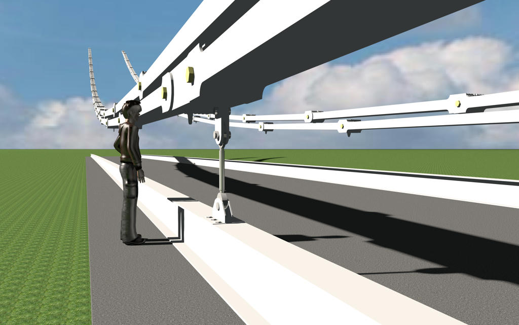

To give an idea of size i have positioned the Boy, with his height set at 1.8m , 6' in real money.

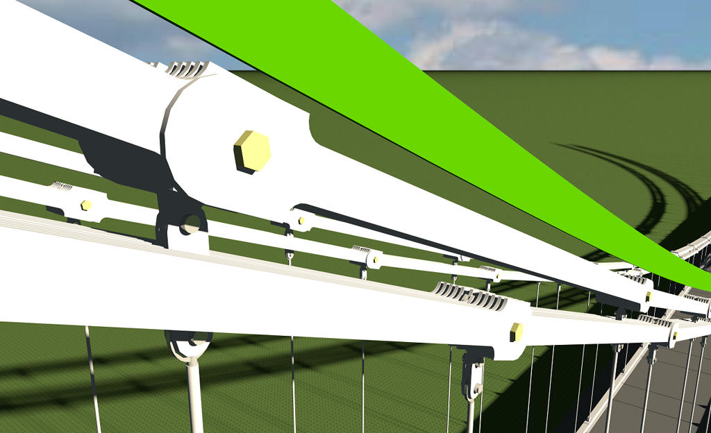

The last image shows a bit more detail for attaching the link arms to the 2 chains. The green arced object you can see was started life as an arced wall and is now the guide for me to position the individual links of the 3rd chain.
