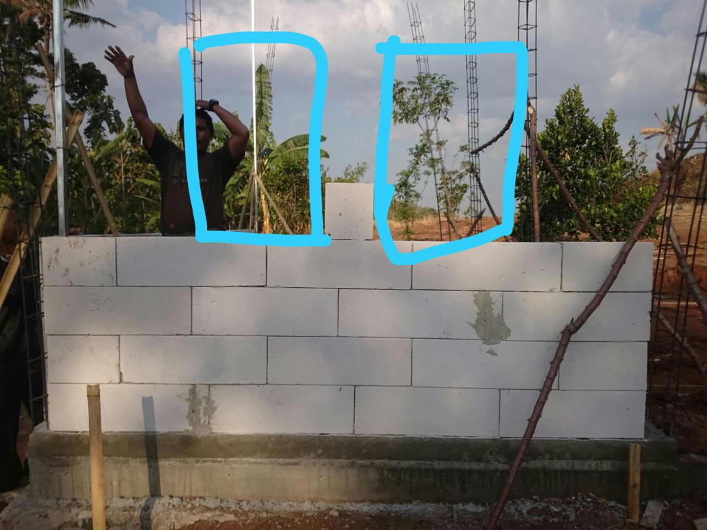

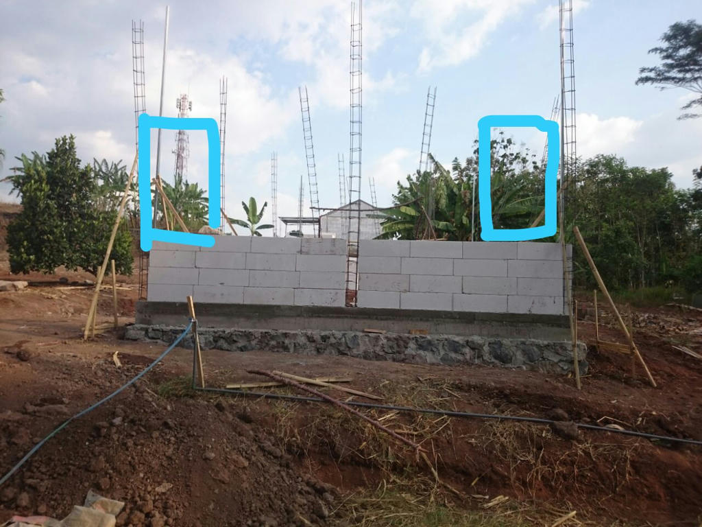

Now, the bricks will be laid out... I have to decide how the door and window will be constructed and the measurements of it.
I plan to use all metal doors and windows using hollow steel and steel sheets, if possible, but I should consult with the door builder first.
I plan to use pivot hinge for the door, without door frames.

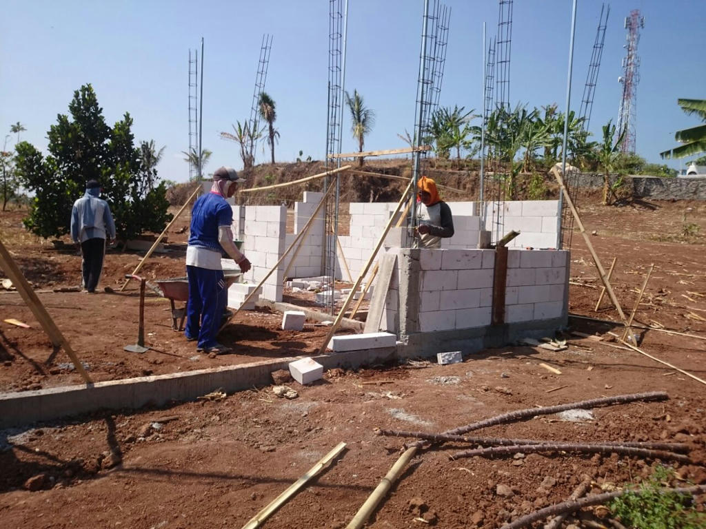

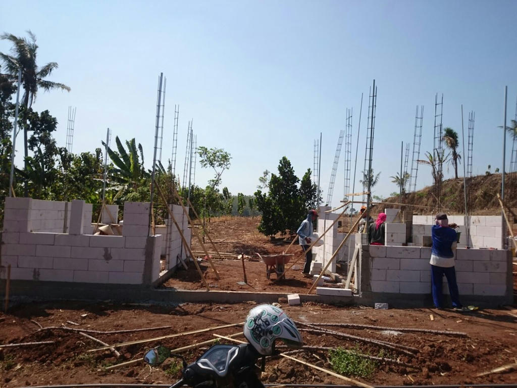

Aug 15, 2018 Some part of walls already laid with bricks (AAC bricks) up to the window's lower rail position (80cm from floor). First photo is from West side, kitchen window. Second photo is from North side.
The bricks is not so nicely layered, but it's OK, it will be covered with plasters.

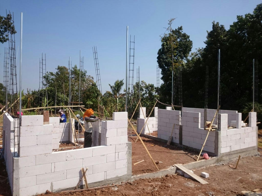

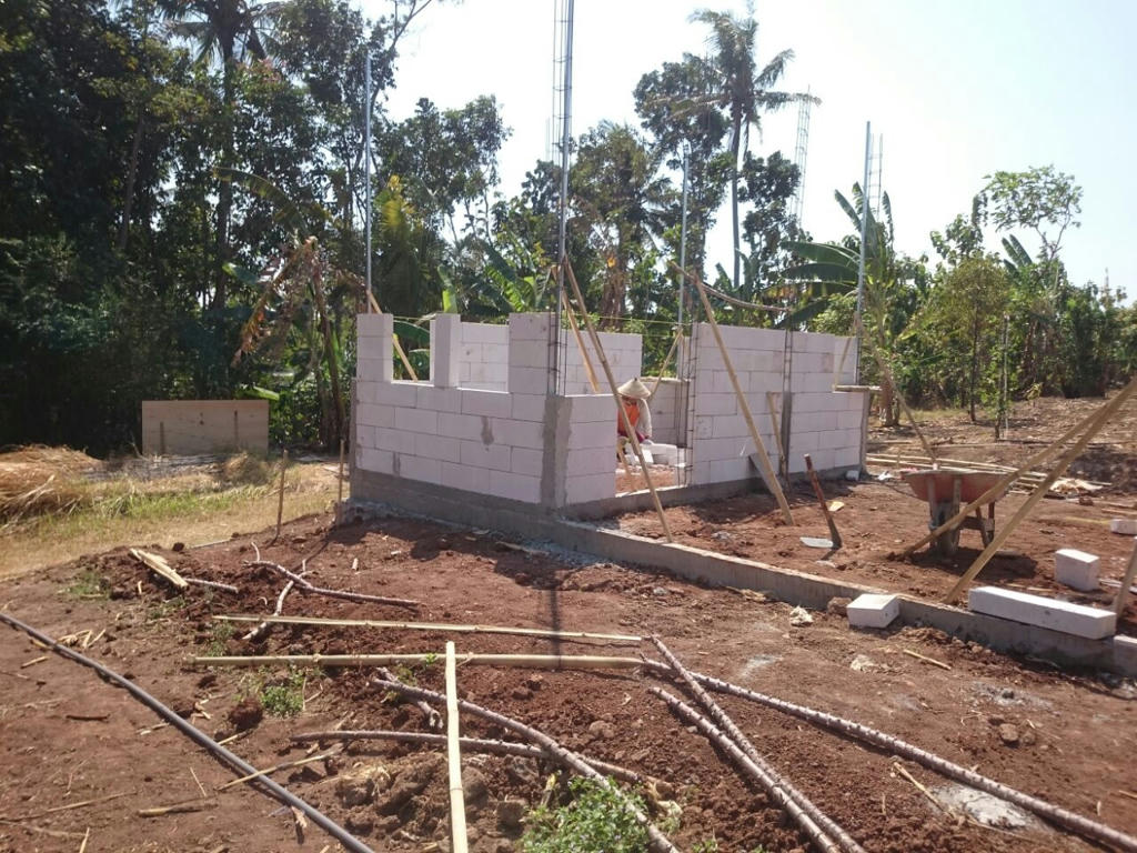

Aug 20, 2018
East (a bit south) side
West side
Bed room, toilet/shower room
Kitchen/living/work area
[Aug 20, 2018, 4:59:54 AM] Show Printable Version of Post    View Member Profile    Send Private Message [Link] Report threatening or abusive post: please login first  Go to top
