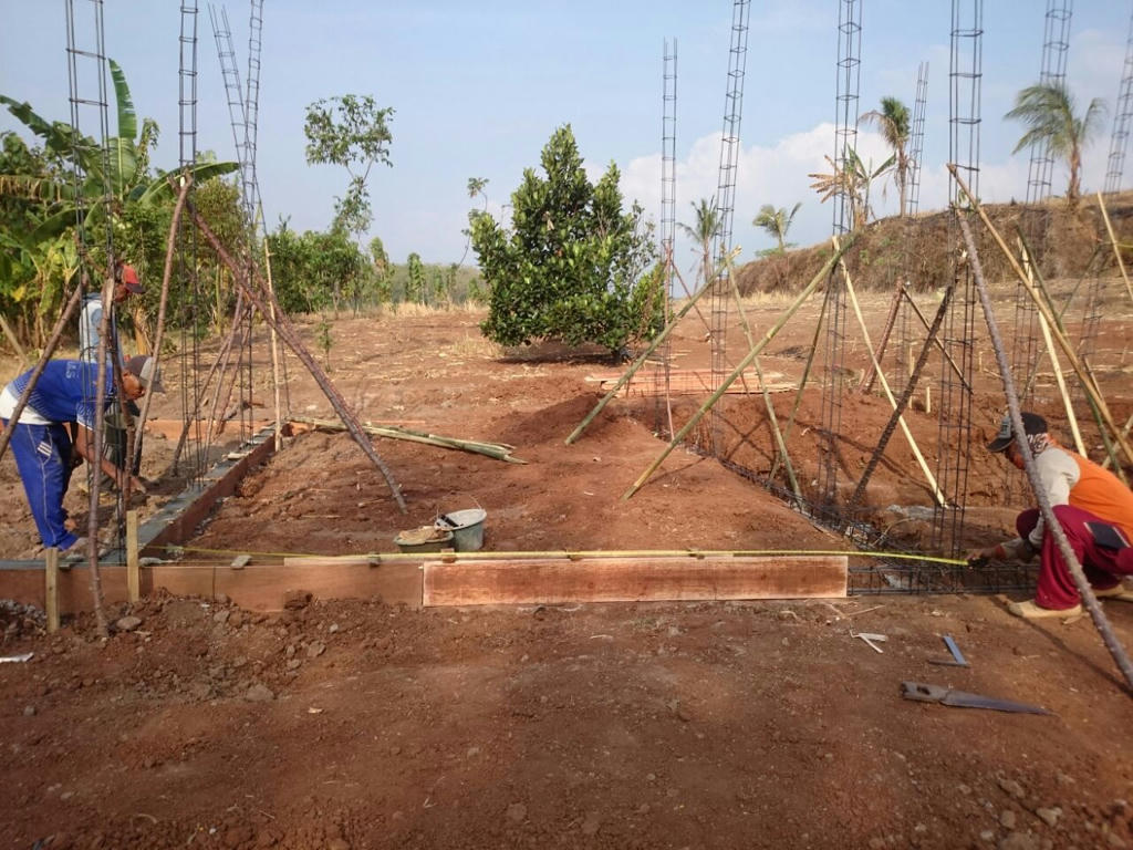

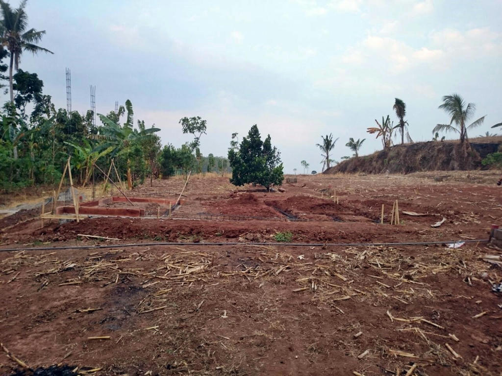

Realization progress:
Aug 1, 2018 (South view)
Aug 4, 2018 (West view)
Aug 7, 2018 (South-west view)
[Aug 9, 2018, 4:27:54 AM] Show Printable Version of Post    View Member Profile    Send Private Message [Link] Report threatening or abusive post: please login first  Go to top

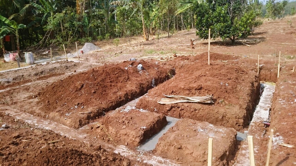

Aug 9, 2018
[Aug 9, 2018, 5:15:01 PM] Show Printable Version of Post    View Member Profile    Send Private Message [Link] Report threatening or abusive post: please login first  Go to top

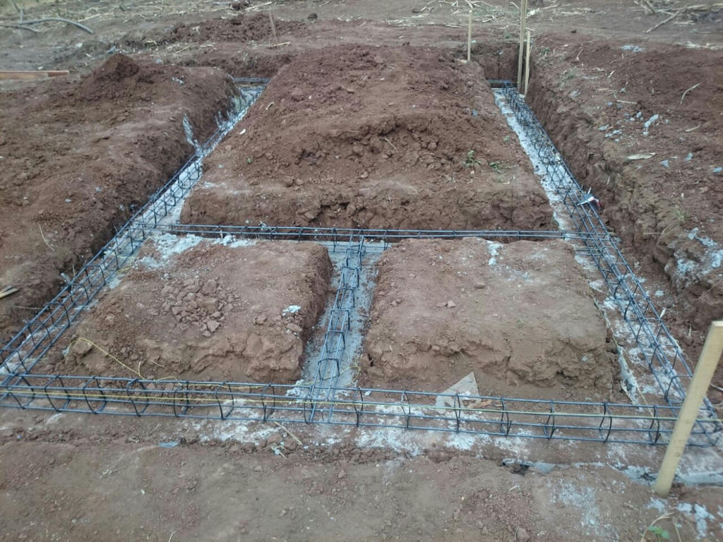

I'm very surprizing that we don't see steel from your concrete.
like this below :
I don't know how you build a house but how can the house stand up ?
more, in Indonesia, there are many earthquakes… sad
wink
[Aug 9, 2018, 6:22:10 PM] Show Printable Version of Post    View Member Profile    Send Private Message [Link] Report threatening or abusive post: please login first  Go to top

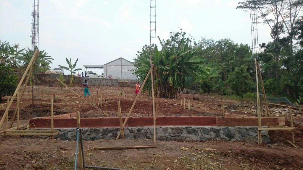

Hi bdfd,
Thanks for your concerns, the photo you see is a step before steel structures installation.
Basically, we do use steel structures to enhance walls, but some people use different techniques according to what type of walls is used, whether we use bricks, or all concrete walls, etc.
On the later pics, you can see that there are steel structures there.
Here are more pictures about it:
Steel structures
Cheers
[Aug 10, 2018, 2:13:49 AM] Show Printable Version of Post    View Member Profile    Send Private Message [Link] Report threatening or abusive post: please login first  Go to top

Hi bdfd,
Hi hinjo,
TY for your return.
I saw the principe and it is this which is amazing. biggrin
Why are not the steel structures in the first concrete ?
A second concrete will be put by over the first ?
If yes, How do the twice concrete hold together ?
You make yourself the house or the house is building by an enterprise ?
Good luck.
[Aug 10, 2018, 6:40:55 AM] Show Printable Version of Post    View Member Profile    Send Private Message [Link] Report threatening or abusive post: please login first  Go to top

Aug 10, 2018 More steels... wink
