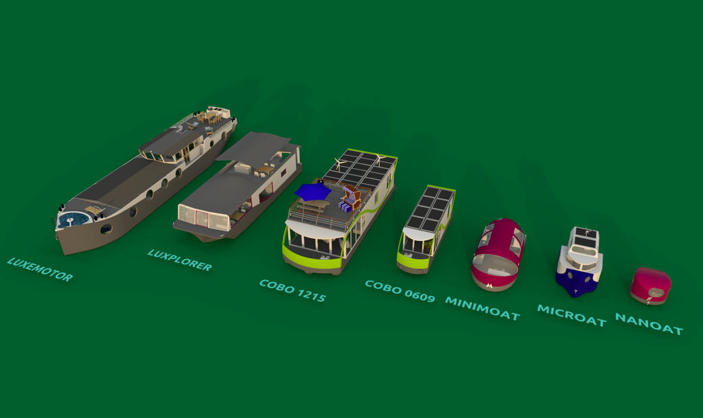

The idea about the pontoons is a good one, and it's a cheap one. That's why I already had it myselfe:
The COBO1215 and the COBO0609 are both based on a pontoon platform and the COBO1215 is even usable for coastal waters.
But they have oune big problem: they are much higher than the other boats, and that is a problem, if you have to pass low bridges. The COBO0609 is my try to fix this problem, but this boat is really small...
