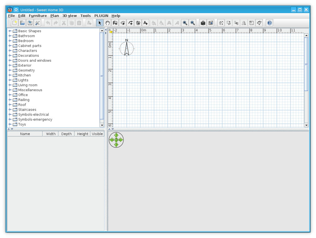

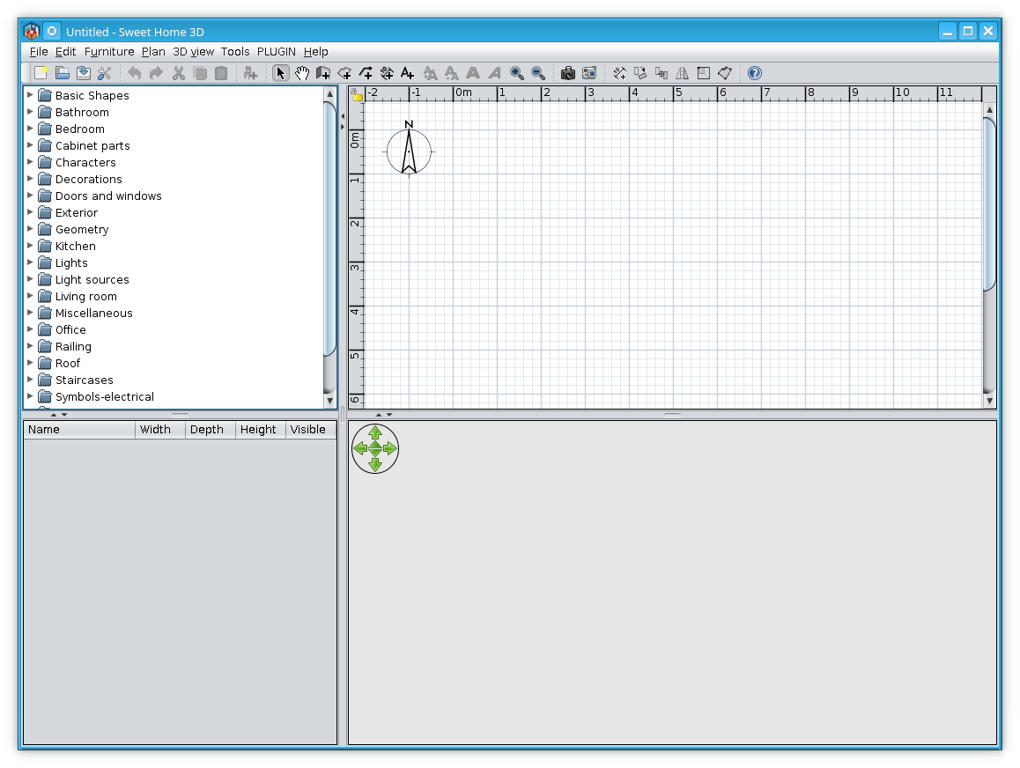

dorin
Romania
Joined: Apr 24, 2014
Post Count: 676
Re: Sweet Home 3D 6.0
Is not a big deal only look a little bit better
The standard:
The nimbus:
Remember the Warning: with this look-and-feel setting some function DON'T work. I've discover at this moment only the math formula issue but could be more other.
