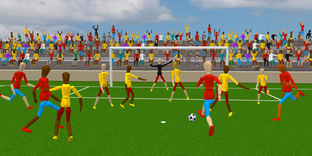

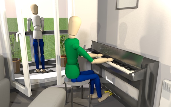

Among the new 3D models also shown in the following scene
the following models have special features:
- the picture surface of the Frame, the screen of the Laptop and the small frame in the Filled bookcase have texture coordinates to let you set the texture image you want.
- the Frame contains a mirror surface under the picture surface with the material named flltgrey, and if you make flltgrey material invisible, you'll get a mirror at the two best rendering qualities.

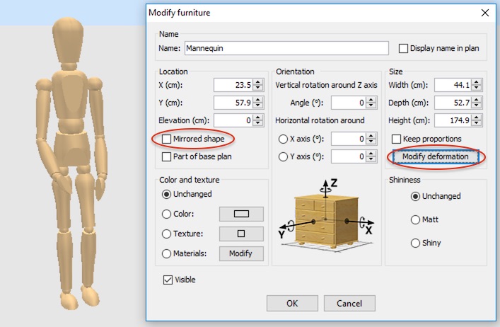

- the limbs of the mannequin / figure are articulated and you can completely change its posture with the new Modify deformation button available in the furniture modification pane (which pushed the Mirrored shape check box in the Location group):
When you click on this button, a dialog box will be shown to let you move the parts of the mannequin with the mouse:
I hope you'll find this ability useful, and that after a while, you'll understand how rotation works. I prefer to let you test this feature first before improving it from your feedback.
Note that this was programmed in such a way that it shouldn't be too hard to extend this feature to open doors and window sashes.

Just a quick test. No problems, hiccups or slowdowns. Interesting development. Congratulations - and thanks.
.. useful, and that after a while, you'll understand how rotation works. I prefer to let you test this feature first...
Yes, very useful. Especially to visualise the proportions of a room design. The mannequin will be put to work right away. No fancy figure needed for that. Modifying the mannequin is easy and consistent with rest of SH3D interface.

Perfect for footballers and just in time for World Cup round of 16!
[Jun 29, 2018, 9:26:33 PM] Show Printable Version of Post    View Member Profile    Send Private Message [Link] Report threatening or abusive post: please login first  Go to top
Re: Sweet Home 3D 6.0
And exactly which teams was that you were cheering for...? Of course, if you give the right answer the rendering is supercool showing the great new features. smile But yes, possibilities are great with mannequins (impressed with the details)... ok
[Jun 29, 2018, 10:42:06 PM] Show Printable Version of Post    View Member Profile    Send Private Message [Link] Report threatening or abusive post: please login first  Go to top
smile Winner? Sweet Home 3D team, of course!

So, it's now possible to open windows, doors, cabinets and other objects when their modification pane displays a button named Modify openings or Modify posture for mannequins. This is now the case for 32 models in the updated default catalog. I added the default tag (défaut in French) to the 100 models of this catalog to let you find these models more quickly if you installed more libraries.
When you click on the Modify openings button, a dialog box appears to let you rotate or slide some parts.
I added a Reset shape button to reset openings or mannequin to their initial position (i.e. the one in their 3D model file) and three buttons to let you quickly change the point of view on the edited model.
There's no limitations on the angles or translations, and you'll have to visually check if the 3D model will remain consistant or not. You can open sashes at a larger width than window's one and the drawing of the sashes in the plan will keep their size and location correctly. The selection rectangle in the plan will match the total width and depth of the 3D model like until now, even if this may lead to strange rectangles like in the following screenshot.
As soon as an object is deformed, its size can be changed only proportionally, otherwise this could lead to strange shapes. If ever you need a wider or deeper or higher object, first reset its shape, change the dimensions you want, and deform again its shape.

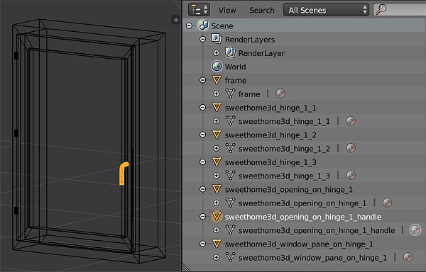

This new feature works thanks to naming conventions in the 3D model files where are described the various parts of the mannequin, the hinges and their openings, as well as the rails and their sliding parts. Remember the ability to declare a shape as a mirror thanks to sweethome3d_window_mirror prefix? Here, it's the same thing, but with more prefixes:
- Hinge parts are prefixed by sweethome3d_hinge_ followed by the order number of the hinge axis they describe, starting from 1 (for example, sweethome3d_hinge_1, sweethome3d_hinge_2,...). A given axis can be defined with more than one part, for example with 2 shapes named sweethome3d_hinge_1_top and sweethome3d_hinge_1_bottom.
- The parts of an opening able to turn around the hinge numbered x should be prefixed by sweethome3d_opening_on_hinge_ followed by the same number x. For example, sweethome3d_opening_on_hinge_1_door and sweethome3d_opening_on_hinge_1_handle will rotate around the axis defined by sweethome3d_hinge_1, or defined by sweethome3d_hinge_1_top and sweethome3d_hinge_1_bottom. If you want to define transparent panes directly without a transparent material, you can also use the prefix sweethome3d_window_pane_on_hinge_ followed by the hinge number.
The axis direction of the hinge x is guessed from the largest dimension of the global bounding box of the hinge parts. Thus, if the largest dimension of a hinge is its height, the axis will be vertical, if its largest dimension is its depth the axis will be horizontal in Y direction and if its largest dimension is its width the axis will be also horizontal but in X direction. Axes can only be parallel to X, Y or Z axes at the moment, but this looks largely enough. The axis may be defined with some dummy parts that are not visible (like in the kitchen cabinet).
- Straight rail parts are prefixed by sweethome3d_rail_ followed by the order number of the rail axis they describe, starting from 1 (for example, sweethome3d_rail_1, sweethome3d_rail_2,...). A given axis can be defined with more than one part too. If a 3D model has multiple openings translating along a unique rail, you may also use the prefix sweethome3d_unique_rail instead.
- The parts of an opening able to move along the rail numbered x should be prefixed by sweethome3d_opening_on_rail_ followed by the same number x. For example, sweethome3d_opening_on_rail_1_door and sweethome3d_opening_on_rail_1_handle will translate along the direction of the axis defined by sweethome3d_rail_1. If you want to define transparent panes directly without a transparent material, you can also use the prefix sweethome3d_window_pane_on_rail_ followed by the rail number. If a unique rail is used, you still have to number each opening to be able to distinguish the different openings that can be moved.
Similarly to hinges, the axis direction of the rail x is guessed from the largest dimension of the global bounding box of the rail parts. Thus, if the largest dimension of a rail is its height, the axis will be vertical, if its largest dimension is its depth the axis will be horizontal in Y direction and if its largest dimension is its width the axis will be in X direction. Axes can only be parallel to X, Y or Z axes at the moment.

How to use these prefixes in your own 3D model files?
In a file at OBJ format, it's quite easy because the parts of a 3D model are defined by lines starting by g or o, so you just have to look for these lines and add the good prefixes to make it work. If you want to visually identify these parts, you can import your 3D model in Blender, click and rename the different parts, and reexport them at OBJ format.
It's the way I used to rename (and improve) the hinges, rails and openings of the 32 following 3D models of the default catalog:
