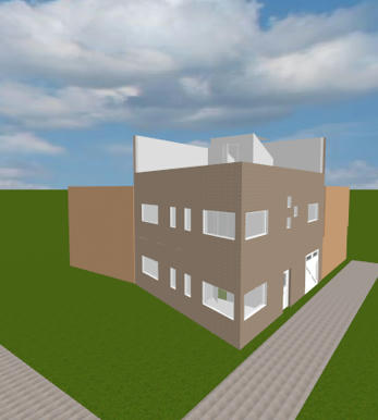

i'm new to SH3D world or even to anything related to this. I live in India and I'm planning to build my house.
I initially started out with different softwares as i wanted to design my home. but when i found this beauty called SH3D, i simply loved it and started using it.
Now here is what i have done so far. My plot area n all I have shown in this SH3D file.
My requirement is 3 Bed in total. 1 On GF ,2 on FF. Kitchen, Living and parking space.
I tried this design so far. I need suggestions and alterations from you guys who r experts with it.
Help me with suggestions. As i m no structural engineer i m surely going to visit architect too. but I need to have few designs before i go n meet him.
Hope i m not violating any Terms n Conditions of the forum.
Thanks in advance.

Hello and welcome,
Your project is interesting.
There are surely constraints related to your country.
Here are some remarks:
1. The toilets outside, why?
How do you do in bad weather?
2. I did not see the bathroom.
3. I do not see how the big balcony will fit.
You can not put a beam in the middle of the parking!
4. No window in "main bed".
no window in "bed small".
5. How will your roof be?
6. How will you heat your house?
7. What does OTS mean?
Regards,
bdfd.

Let me tell you some facts about weather and materials i m going to use.
Weather is quite habitate over here. Not so many challenges. Temprature is about 21-35 degree celc. whole year. Which includes winter about 18-23 degrees and also heaty summer about 35-39 degrees.
Rainy season here lasts about 4 months and it rains moderately here.
Wind breeze is from West Side ( thats why i opted this land).
Material for wall would be a 9" thick stone.
Roof I will make of concrete, Almost flat ( Will give some minor slop towards the sides as it will help keep rain water to flush away. )
Brother, My basic idea was just only to put plot size and ask for advise. But I thought it would be rude just ask for help without doing anything on a project.
If you wish, you can remove all the elements , all the walls and start fresh. I already mentioned my requirements. But again here it is.
We are family of three. Me , my wife and a kid (5 yrs boy).
We would be more then happy to have just 2 Bed , hall and kitchen all n all. But family and friends suggested one small bed room on the Ground floor.
Yes, I do need balcony, where I can put a Swing bed (small one) facing west.
I need main enterence on Ground floor facing West. Kitchen on South-East.
Thats it. so all n all , 3 bed , hall kitchen with a parking ( I need 10' x 15' for my current car.)
Oh forgot to mention OTS is for Open space for vents and air circulation.
Hope this helps.
Thanks again...
Regards,..

Well.
Here is little updates and an idea for the biggest balcony.
a) blue arrow, a beam (in red: 0.20 x 0.20 x 3.40 m reinforced concrete) to support the large balcony.
height of the toilet wall at 2.6 m
b) red '?' : what is the future function of this room?
c) green arrows: I add 2 windows
what do you think ?
