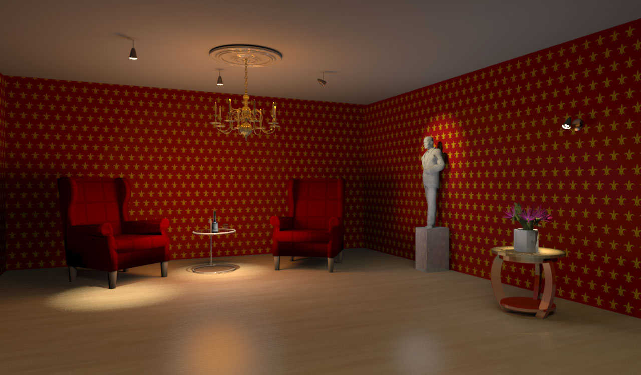

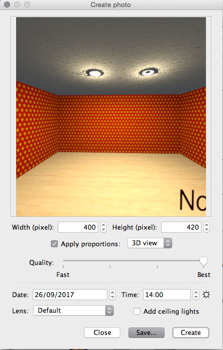

It seems the cutout is less important than I thought in terms of using lights placed above the ceiling.
With the entire light source above the ceiling, you definitely need a cut-out for the light to be visible.
I have taken the liberty to adjust the height of your light sources, and made some renderings:
Here is the original file, unchanged, but with a different camera angle, that allows us to se the ceiling. Notice the black dot in the middle of the right downlight. That means the light source is intersecting the ceiling, whereas the left downlight, with a cut-out, is perfect.
Here I have adjusted the height of the light source of the downlight with the cut-out ( and made it smaller in order to get a more focused light beam).
On the right rendering, both light sources are above the ceiling.

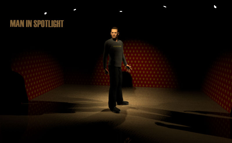

A downlight embedded in the ceiling must consist of minimum two elements:
A pipe (to perform the cut-out) plus a light source, since, as far I have understood it, a 3d model can't hold
both a cut-out and a built in light source at the same time.
But a reflector with a light source in it should be possible to make, and using a reflector formed as a spotlight
with a light source inside it, we will be able to easily rotate the light beam in any direction and almost any angle
we want, and not have to worry about the shape of the cut-out.
I thought it was worth a try.
Well, I gave up. My head wasn't working, so I ended up with a spotlight with no embedded light source.
But it works:
This is as far as I got: circle_cutout_with_spotlight.sh3d
Maybe you want to give it a try?

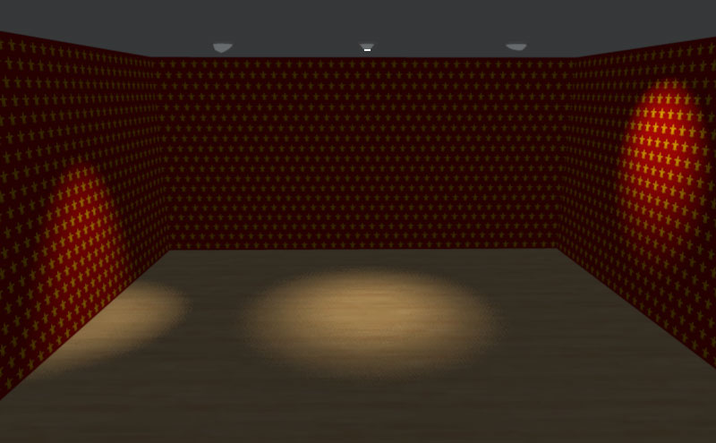

Two approaches tested and posted in SF 3D models 400.
First combining cutout and light in one model.
- Apparently not possible with FurnitureLibraryEditor / PluginFurnitureCatalog.properties.
- However in Home.xml (within the .sh3d file) a model with light is called <light ..>, while normal models are <pieceOfFurniture ..>.
- While a <pieceOfFurniture ..> cannot (I think) take light properties, a <light> seems to support staircaseCutOutShape
The downside is that a <light > model cannot be rotated along three axis as can a <pieceOfFurniture>
spot_light_cutout.sh3d
Second, spotlights with lightsource that can be rotated and pointed at different objects.
Simple model (no brackets, no textured glass), three different light-source locations:
- Spot: wide
- Spot_focus: medium
- Spot_beam: narrow
But this is where I am pretty useless. How best to place the lightsource within a model to get Cec quality renderings is Swedish to me.
spot_light_pivot.sh3d
Light-source relevant items in PluginFurnitureCatalog.properties for the three downlights (other properties snipped):
id#12=okh#spot7
name#12=Spot
width#12=8
depth#12=8
height#12=10
lightSourceX#12=4
lightSourceY#12=4
lightSourceZ#12=1.5
lightSourceColor#12=#BB9854
lightSourceDiameter#12=3
id#13=okh#spot7_focus
name#13=Spot_focus
width#13=8
depth#13=8
height#13=10
lightSourceX#13=4
lightSourceY#13=4
lightSourceZ#13=7
lightSourceColor#13=#BB9854
lightSourceDiameter#13=2.5
id#14=okh#spot7_beam
name#14=Spot_beam
width#14=8
depth#14=8
height#14=10
lightSourceX#14=4
lightSourceY#14=4
lightSourceZ#14=8.8
lightSourceColor#14=#BB9854
lightSourceDiameter#14=0.8

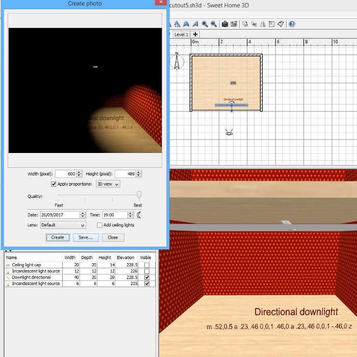

Last attempt of the day, a directional downlight with
<light catalogId='okh#spot_dir_cut' name='Spot_focus_dir' creator='okh' model='1/downlight_directional.obj' icon='0' x='69.5' y='290.55923' width='20.0' depth='10.0' height='10.0' modelSize='14936' staircaseCutOutShape='m .52,0.5 a .23,.46 0,0,1 .46,0 a .23,.46 0,0,1 -.46,0 z' power='0.4'>
<lightSource x='0.25' y='0.5' z='0.7' color='00BB9854' diameter='0.125'/>
</light>
Point is, concept works, but the two variables are hard to handle. For me, anyway. LightSource diameter, LightSource placement in model. Which is the better generic model?
All models in spot_light_cutout_dir.sh3d should be placed 0,5 cm below the ceiling for the cutout to work.
The Spot_focus_dir model can be adjusted in height to raise/lower the beam.
But is any of this useful? Not sure. Could it be with the right settings. Probably...

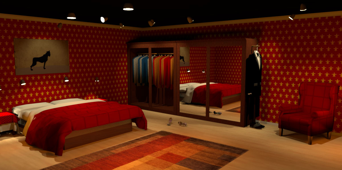

There is no need for any mounting bracket. The bracket is just make-up and at best only serves the purpose of creating an illusion.
There are other ways – and better ways – of creating an illusion, and, bluntly speaking; if the illusion breaks as a consequence of a missing mounting bracket, I'd say it wasn't
much of an illusion to begin with.
The illusion lies in the way we use lights. Light and shadow – the difference between a Q1 and a Q4 rendering. Maybe it's Swedish, but it isn't Mongolian.
Here is some Swedish:
My own 5 basic rules:
1) Never tick the "Add ceiling light"-box. It ruins every rendering.
2) Try to avoid lighting up the ceiling ( unless it's the Sistine Chapel or the lounge of the Berner's Hotel).
3) Use a lot of light sources, and keep the intensity low – very low!
4) Don't let walls obstruct the placement of the camera. It's better to temporarily remove or alter walls than to shoot at extreme wide angles.
5) Try different light settings and make A LOT of previews at low resolution ( Q3 - 400px) before rendering a high quality photo.
I took the liberty of substituting the wardrobe doors with mirrors. Hope you don't mind. And, as you can see, the male wardrobe now has got it's own spotlight.
No mounting brackets in use!
The SH3D project is HERE
