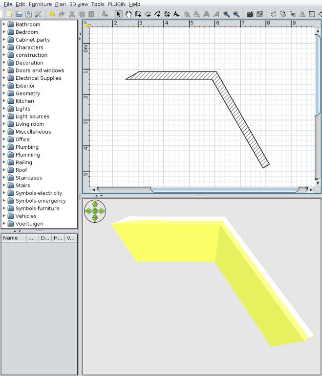

Hello,
I've just started to work with Sweet Home 3D and have a first question :
I have a thick wall that is attached to a stairway. The stairway is at an angle of approx 35 degrees to that wall. How can I create the wall so it completely touches the stairway and does not leave a triangled gap ? The ending of the wall is per default 90 degrees, but in my case it must be skewed to 35 degrees.
I hope I explained this understandable ? If not... see picture at : https://www.mediafire.com/?2t9bh9a8759p6qu[/img]
Thank you very much for your help in advance.
Benno

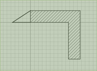

If I understood well, you must add a new wall to complete the hole.
See below :
Is it OK ?
See below :
Is it OK ?

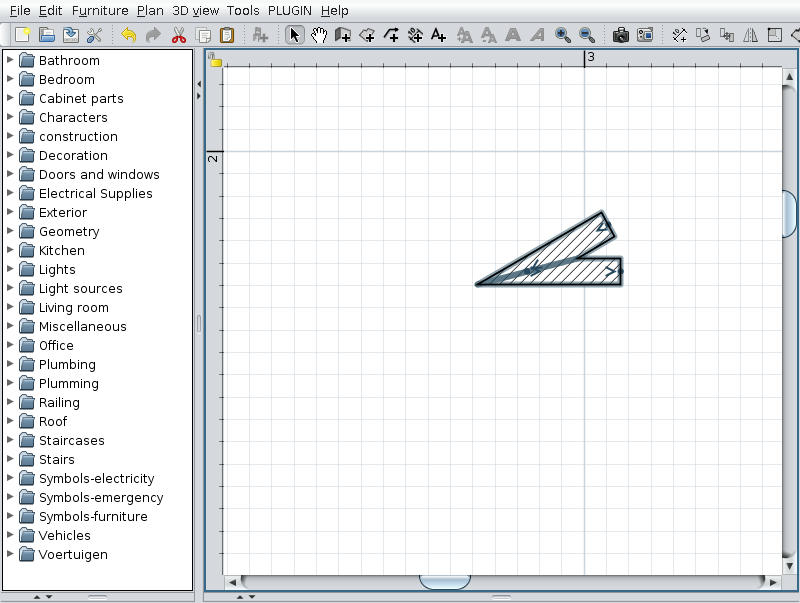

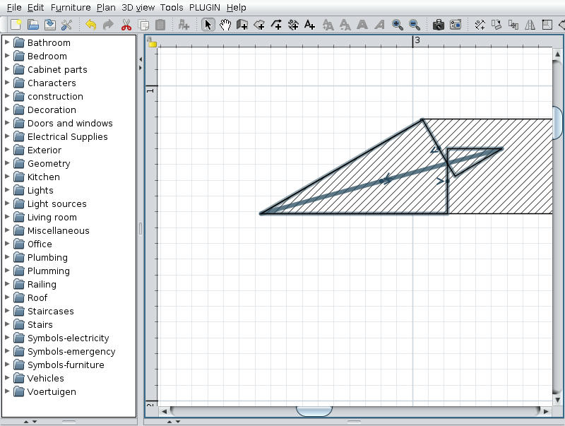

Maybe this is what You want.
I build like this
I start whit 2 walls at 6 cm thickness, move in the position and then I modify the thickness and position until fit.
I build like this

Re: Edge of wall-end different than 90 degree ?
Excellent dorin ! [=D>]
It was so simple ! [;)]
This is exactly what I was looking for
What an elegant solution it is !
Thank you very much for your help. You made my day
Benno
