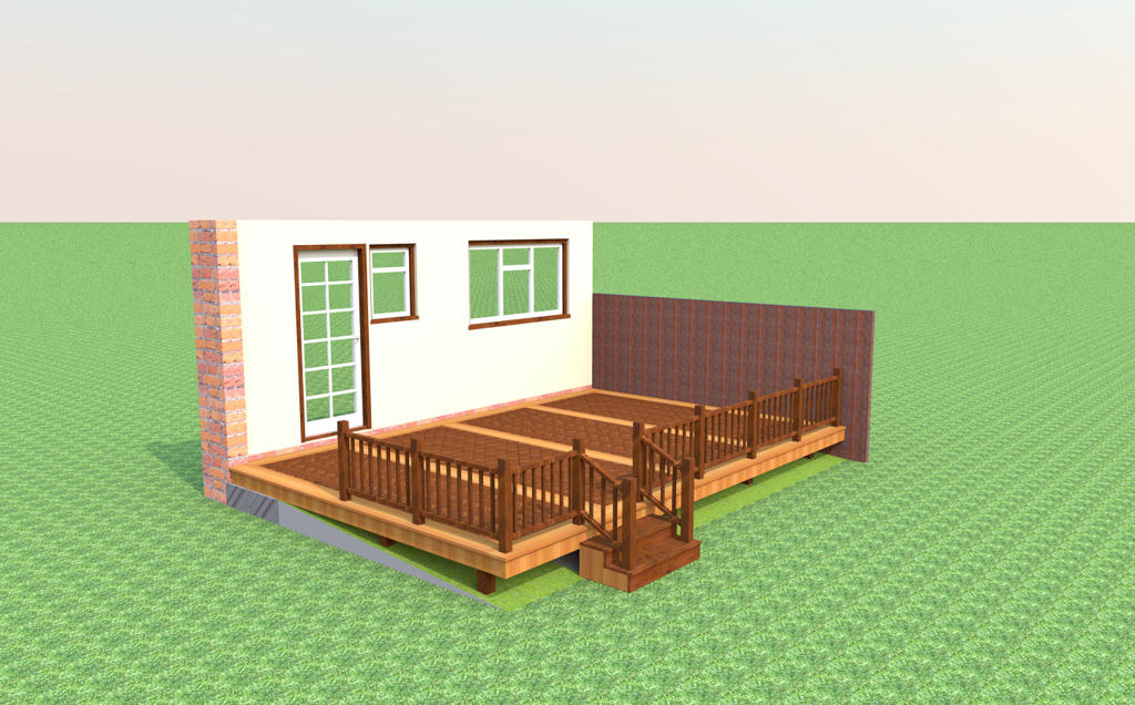

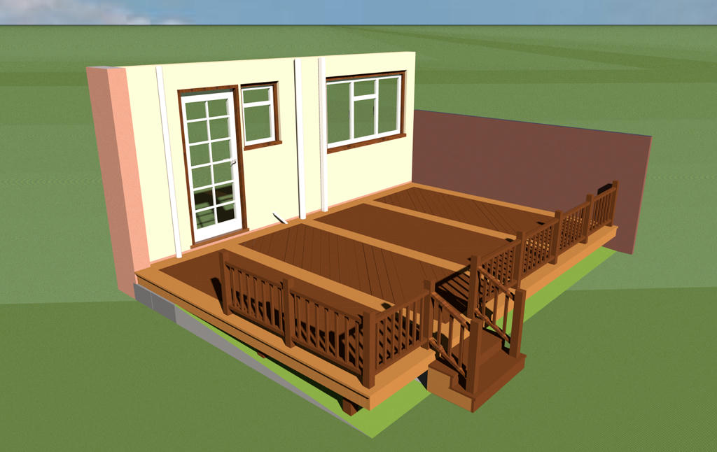

I have now noticed a fairly strange difference between virtual and aerial renders :-
Virtual ...... with wall colour but no textures
Aerial ....... with textures but no wall colour
All other settings remained exactly the same.
Any idea why this might be?

Very Strange ! crying
In second picture, the sky appears like aerial mode ???
We don't see the texture !
Can you test this project on an another PC ?
or
Can we download this project ?
