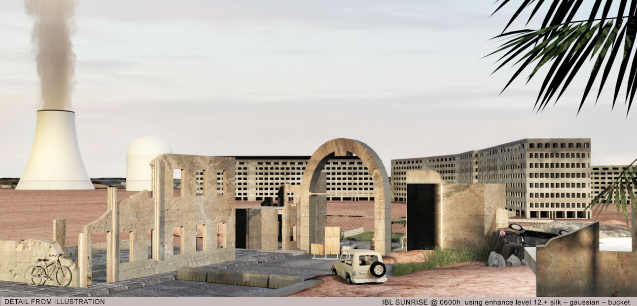

I have been testing a beta-version of Enkyonito's photo rendering plugin these last few days:
At first glance, these images might appear to be quite identical, but if you look closely you will see that there are in fact a few differences; the main difference being
that the shadows get softer as the enhancement level is increased. The other difference is the triangles that appear on the right hand wall when rendering with the 0 level setting
and also with levels 8 and 16, although different. It seems that the levels 4 and 12 for some reason are able to handle the textures better – but it might of course have
something to do with my model and my texture.
The way I see it, having four levels of brightness enhancement might solve some rendering problems.
Here is a bigger image (detail):
And one even bigger; Click for 2K image

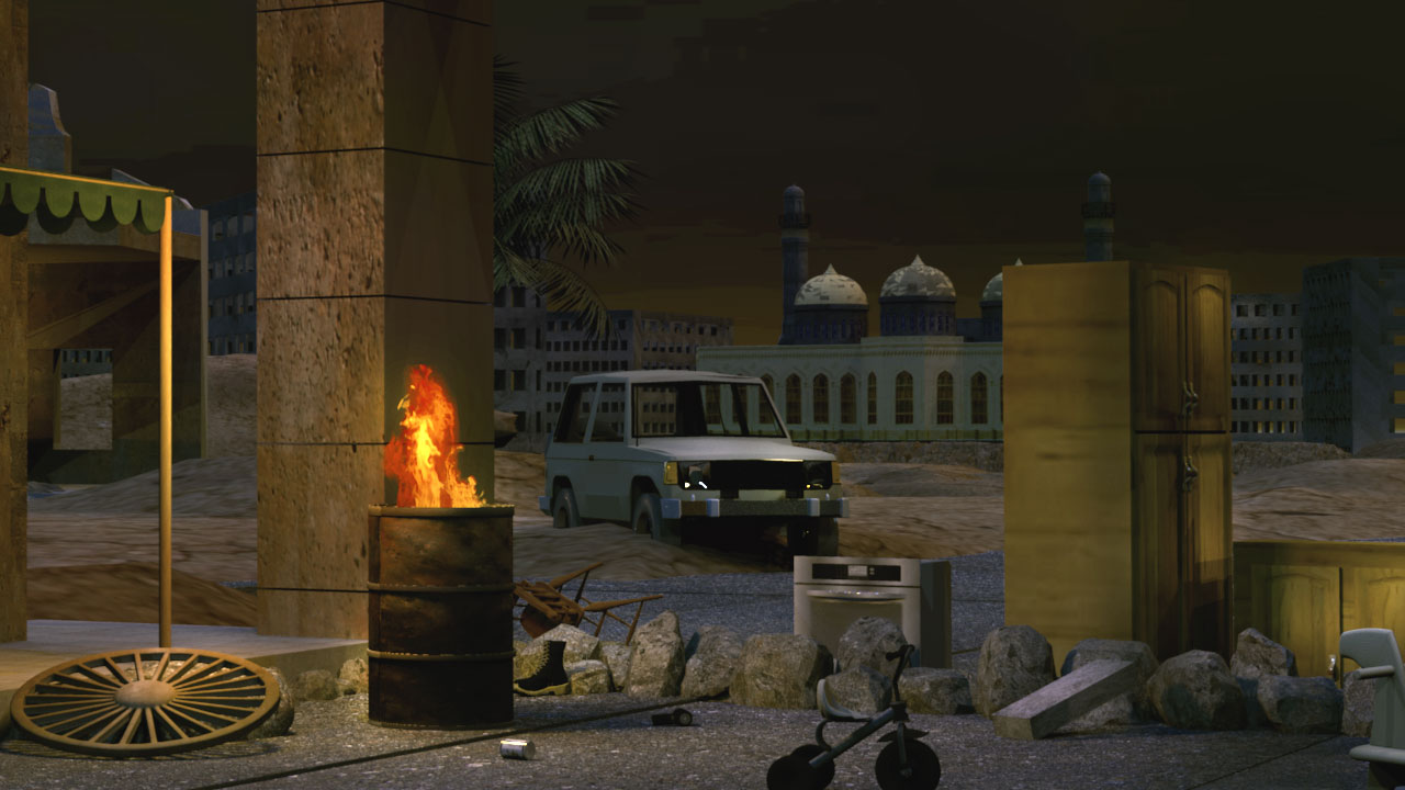

For me the real beauty of using IBL (the brightness enhancement) is that it gives me a possibility to control the overall lighting of a scene in a completely different way when I can use colours and intensity to create a sky image to achieve almost any kind of atmospheric mood I can dream of.
Madame Hussein's Café
1)
A dark blue sky with a blueish light grey top + 2 white lights creating the illumination from the fire:
Click for 2K image
2)
A dark orange sky with a light blue top, + 2 fireglow light sources creating the shine from the fire:
Click for 2K image

Interesting. Thanks. And rendering times?
Anyone else here experimenting with IBL?
I would love to see some examples.
Yours is a hard act to follow, but it would be useful to see more comparisons like this. Especially for those of us working on slower computers (and with limited artistic skill). Merry Christmas to you too, Cec.
I didn't actually time it, since I was mostly interested in testing the different levels of enhancement, but I guess an average of 20 mins for the 2K images.
The project is not as "heavy" as it looks.
I just now made a 1280x600 rendering of a total, using a 2013 iMac with a 3.4 GHz Intel Core I5 processor, which is comparable to a middle-of-the-road common home computer:
BTW: Using image based lighting, does not increase the rendering time:

So...I made some first very quick tests with very small pictures 250x133px on my Lenovo ideapad Y700 with intel core i7 6700HQ (2,6 GHz boosted to 3,1-3,6 GHz) and NVIDIA GEFORCE GTX 960M.... I am not able to describe visual differences due to very small picture size. But the problem is that the rendering time is at about 50-70% longer compare to standard 1.3.2 renderer. This is too much for the settings I use for my pictures /GI-path1 and standard picture size 2000-2500px + depth of field setting etc..../... My standard rendering time is 15-24 hours now... I am affraid that +50-70% to this time is unacceptable for interior rendering. But I am sure it will be great for desktops with faster graphic cards /like NVIDIA GTX980 or higher/...
