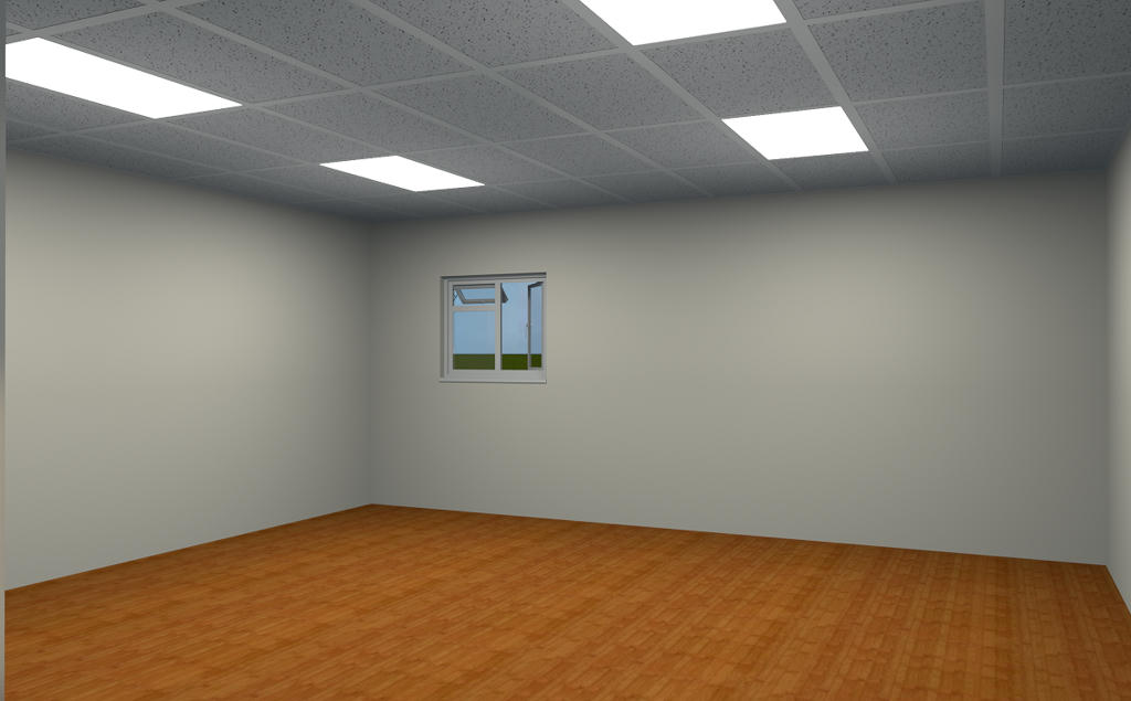

Have to say i found these light sources far more user friendly, thanks for the work you put into them and 1.6
Here i have used 4 opaque panels @ 25% and 4 "unviewable" panels, these are elevated to 1100mm, set to 10% and light the ceiling.
Thanks again
