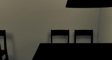

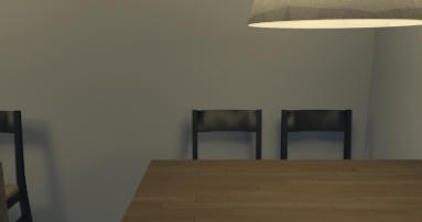

I downloaded and installed SH3D 6.5 under W10.
Using the Simple Photo Rendering v2.0a all results with Sunflow are VERY dark.
Should I no longer use this plugin?
I managed to reproduce the problem.
Yafaray Q4 - Simple Photo Rendering v2.0a
Sunflow Q4 - Simple Photo Rendering v2.0a
SH3D file

Hans,
Version 2.1 of the plug-in fixes this regression from version 2.0a.
