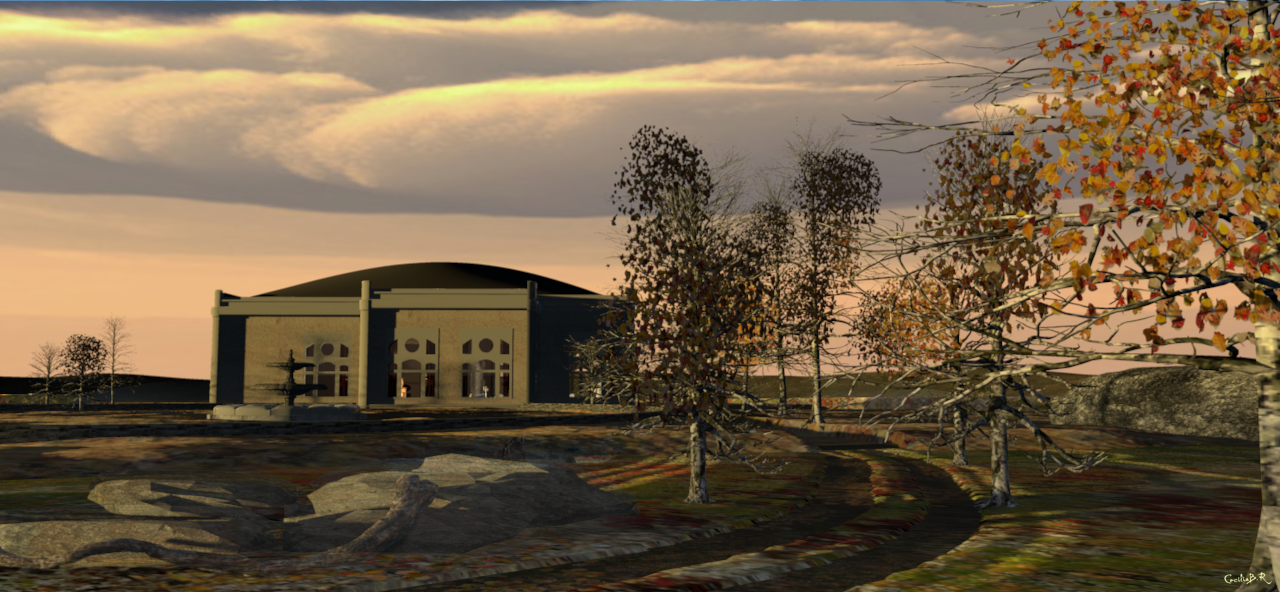

Autumn colours
A new morning.
Every morning, Lillith runs to the mirror, to see if her reflection is still there.
She likes the autumn. She likes the colours – but she doesen't really like mornings.
She spends her days waiting – often in front of the window.
Watching the leaves fall, and the rain. The puddles become like mirrors.
Water makes the colours brighter when the sun comes back.
-Watch out, cat! There are eagles here!
Soon it will be dark. Autumn is good.
The best thing about autumn is that the days get shorter, so the nights get longer.
It's time to turn the mirror … her dad will get up soon.

Re: Autumn colours
As usual, big realism in the rendering ! applause

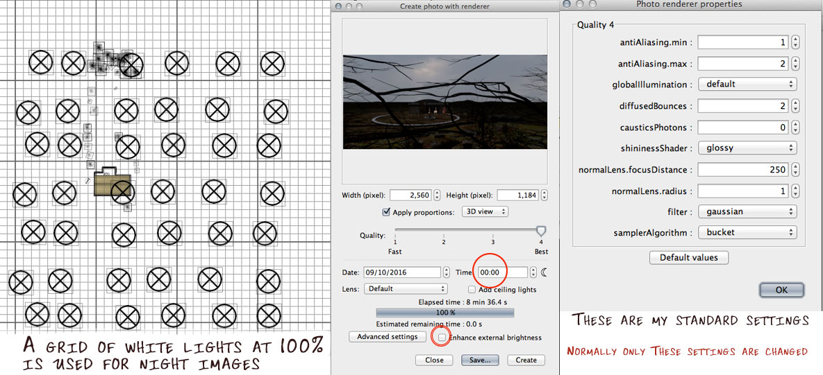

In order to make nice renderings of evening shots or shots of cloudy days without any directional shadows, I have until now lighted my scenes with a grid of white lights at 100% ,
placed some 15-20 meters above the surface, and I have used my standard settings which I have found to work best,
like this:

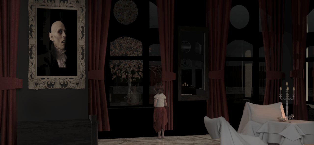

And then I made a discovery.

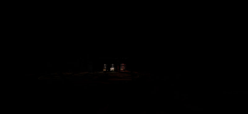

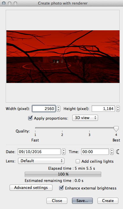

Using my standard settings, I made a test rendering to decide if the lighting was sufficient.
I got a result that was too dark.

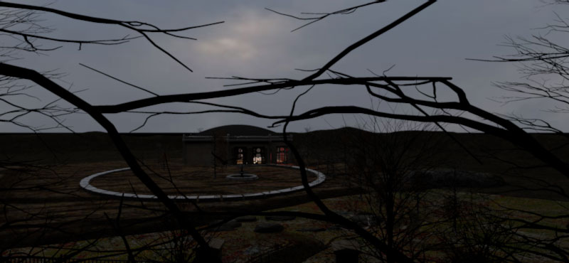

I have no idea what made me tick the Enhance external brightness button.

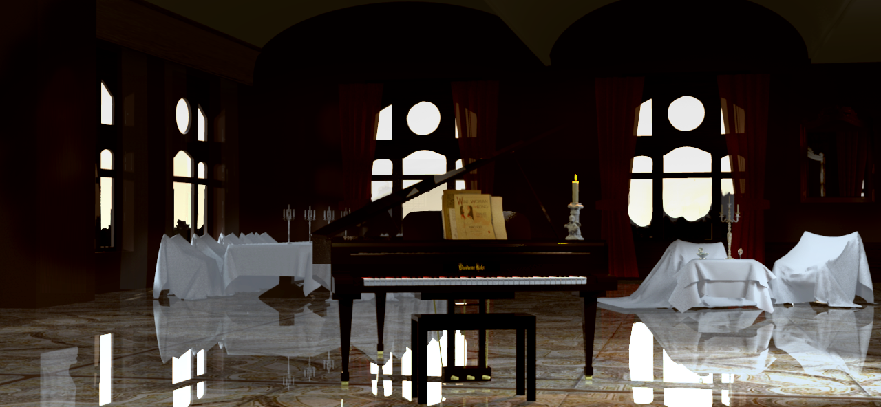

To my astonishment, the image rendered like this:
As it turns out, enhancing the external brightness works perfectly with textured skies,
in fact it works better than with non-textured skies.

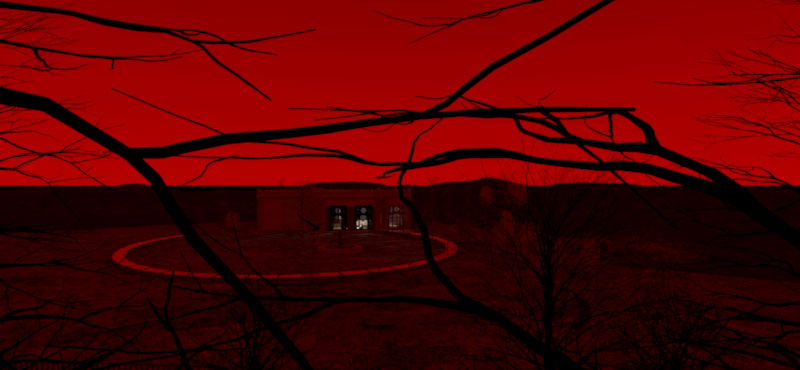

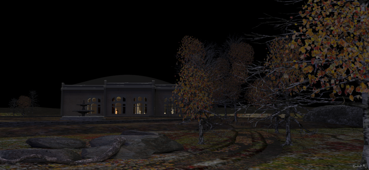

Rendered @ midnight with a non-textured sky, using the same settings:
Same settings, sky textured with a red gradient:
Now, this is interesting.
It seems to me that the enhancement is based upon the reflections coming from the sky,
and that the shadows are created based on the time of day.
For me, this is a very useful and uplifting discovery.

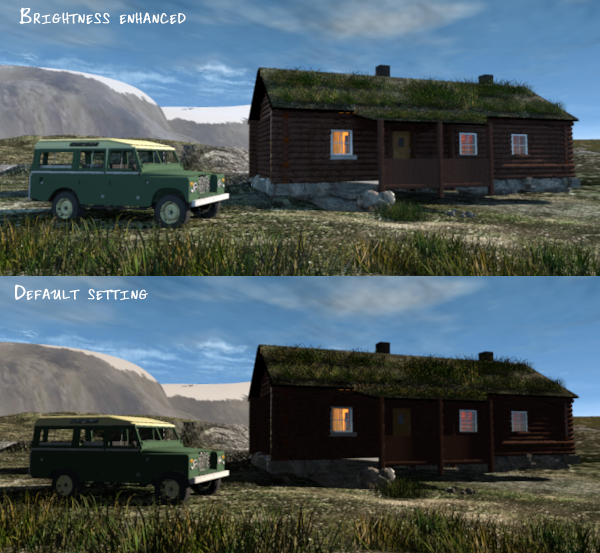

@Ceciliabr
As it turns out, enhancing the external brightness works perfectly with textured skies, in fact it works better than with non-textured skies.
For a sky with texture, the effect of the Enhance external brightness option depends on the used image.
Here are some images showing different versions of the photo plug-in.
Version 1.2 has an option to enhance the external brightness for a sky without texture.
Option disabled (default)
Option enabled

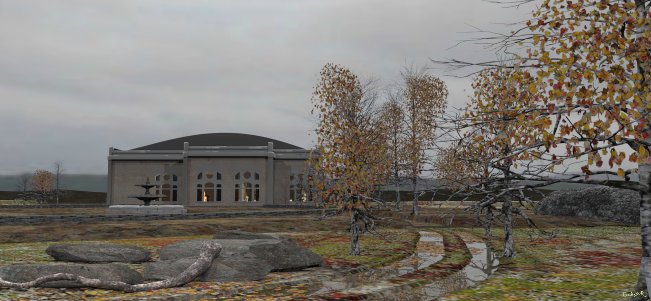

@enkonyito
Aha! Image based lighting, of course. That explains a lot.

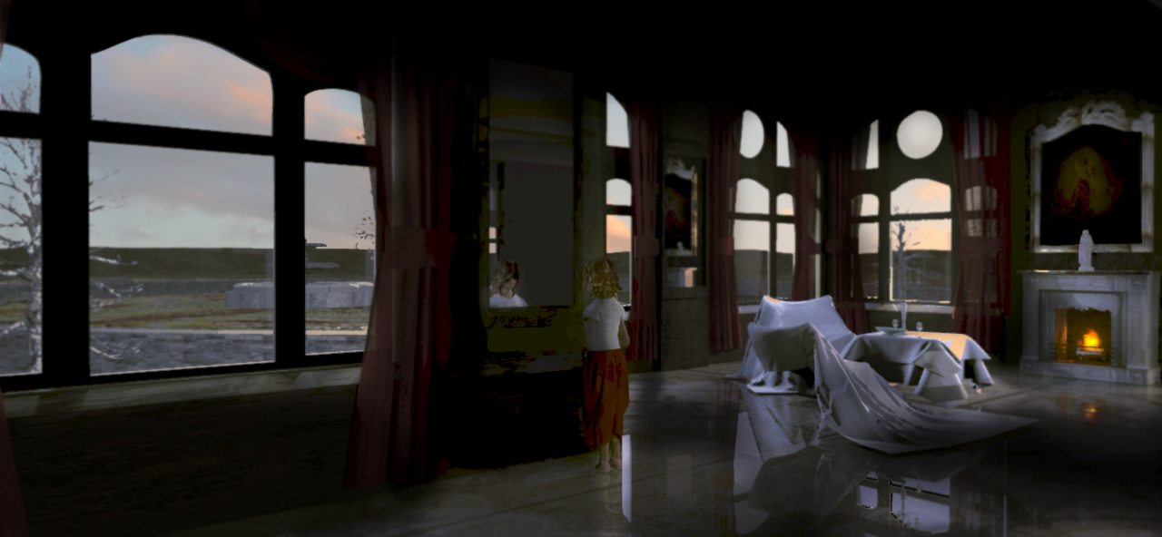

Here are two images, one with clouds and one with a completely white sky.
Both images rendered at midnight with enhanced brightness.
IBL-comparison in daylight (09PM)
This means that the colour and the intensity of the sky can be used to manipulate
both the tint and the exposure.
Good to know.
