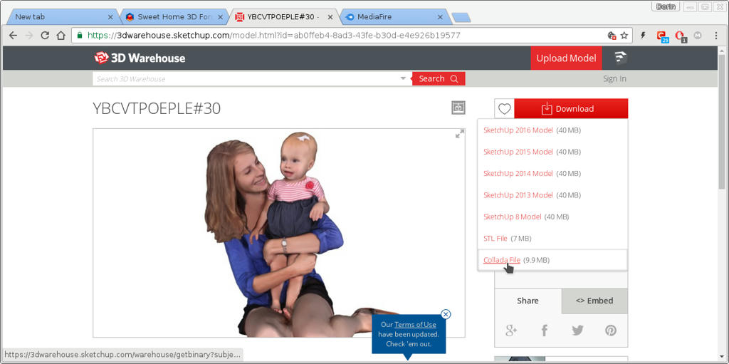

1. Download a model from 3DWarehouse (in my sample this ) BUT the Collada file format)

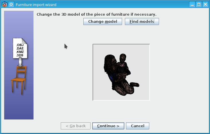

look ugly but continue
Change name and save

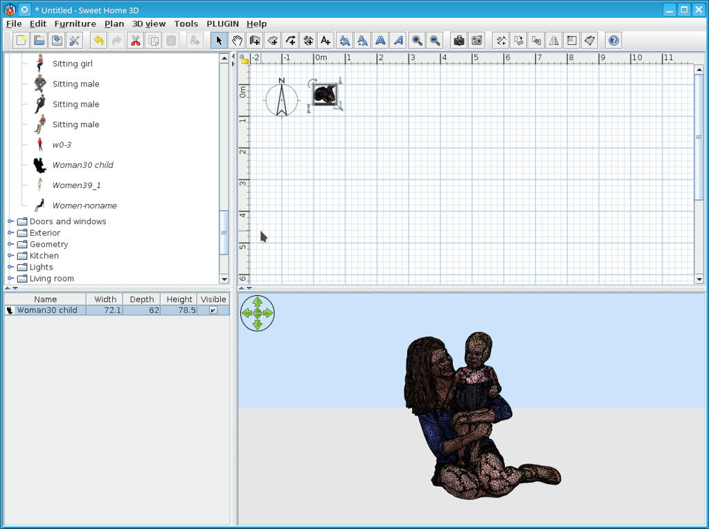

In SH3D will look like this (ugly)

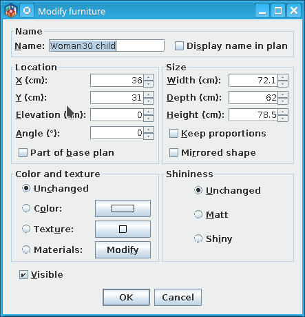

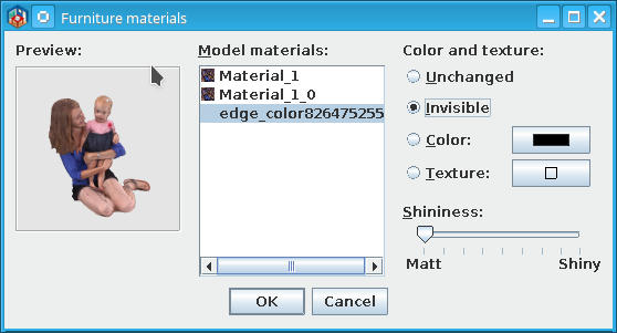

3.Select and right click to modify furniture -> Materials
Some of models have some edge components usually in black; select and mark as invisible and OK
4. Save the modified furniture:Menu->3D view->Export to OBJ format...->Selected furniture;

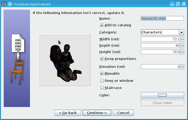

5.Open a new file or clean the previous and Menu ->Furniture->Import furniture
Select the saved furniture and import it under characters (or whatever)
Will look like this

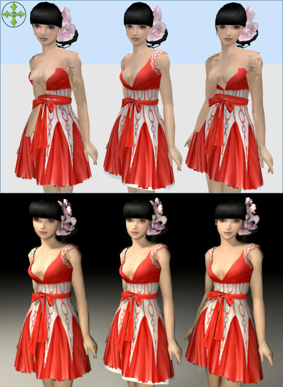

As you noted, when this model is loaded into SH3D, its textures do not display correctly in the 3D window. Seemingly, some areas of the model become mapped with an incorrect texture ― or at least an incorrectly positioned texture; at times, portions of the model seem to disappear. In addition, as the model's position changes relative to the user's viewpoint, the failure changes: Missing sections reappear, texture positioning changes, and the like. The problem is easily seen in the 3D window, but for the individual models of figures making up the collection, the problem can be seen in SH3D's furniture importer itself. (In the collection, the problematic textures are too small to detect.)

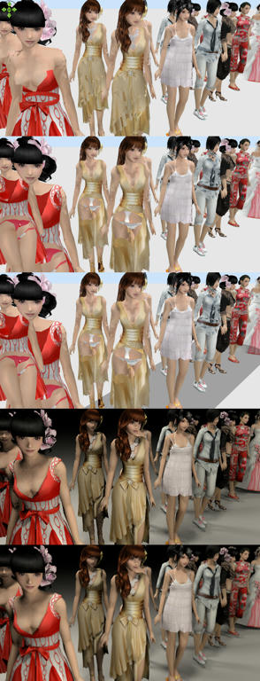

The problem doesn't just affect SH3D's loader and 3D window; as you can see from the following image, the problem is also found in renders at the two lowest quality levels, Q1 and Q2. (Interestingly, the Q1 and Q2 renders fail differently [and somewhat more rudely] than the 3D window does.) However, in scenes rendered using SH3D's high-quality, ray-traced mode ― Q3 and Q4 ― the glitch disappears. Since final renders are typically of high quality, it's likely this problem will have no real impact on your projects beyond minor annoyance during design creation.
[click here for full-sized]
That the problem is limited to the 3D window and Q1 and Q2 renders suggests this is a GPU-related issue. That the problem doesn't occur in high-quality renders suggests the model itself isn't seriously broken. We know this is an extremely rare occurrence ― it's the first incident of the sort I've ever seen, and a scan of problem reports doesn't turn up anything obviously related ― so SH3D's GPU code, if broken, doesn't appear to be badly broken.

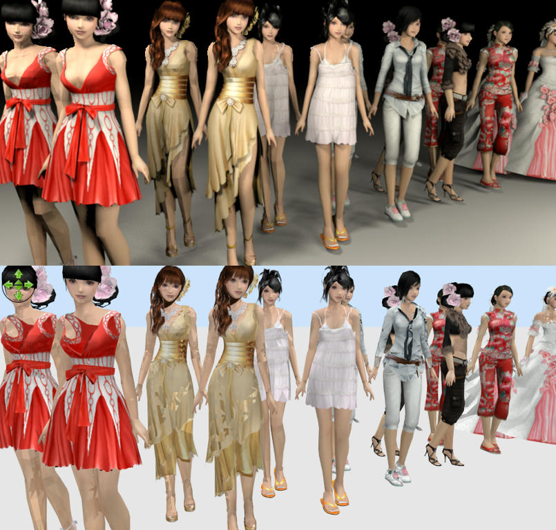

To test this hypothesis, I extracted one of the original texture files, removed its alpha channel, thus disabling transparency, and replaced the original image within the model with the now-transparency-less version. When this modified model was imported into SH3D, the affected areas of the model display correctly in the 3D window and in renders at all quality levels, as shown in the following screenshot of the 3D window. In it, the figure on the left is the original model, showing the texture issue, while in the figure in the center the texture file against which the dress is mapped has been replaced with one lacking transparency. As you can see, the image now displays correctly.
Unfortunately, this is a work-around of limited utility. SketchUp modelers often use transparency in textures as a way to display more finely defined details than would be practical using model geometry alone; as a result, removing transparency by necessity eliminates these details. For example, in the original model, the designer uses transparency to create the ragged hemline on the dress and the lightly fringed bangs and loose tendrils of hair along the hairline. When the dress texture file is replaced by a non-transparent version, the dress's full geometry becomes visible, with the previously invisible areas now filled with whichever color replaced the transparent areas in the file ― in this case, white.
The rightmost figure in the previous image shows one seeming compromise solution to be unworkable: In this version of the model, the dress texture image was replaced with one making use of transparency only where explicitly needed: namely, immediately beneath the hemline. (In the original texture file, all background areas are transparent, regardless of whether or not they are ever mapped against a polygon.) Unfortunately, the presence of transparency anywhere in the texture appears to be enough to trigger the display failure.

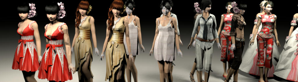

During this investigation, I discovered (or rediscovered) a few more interesting tidbits. First up is a rediscovery of a lesson I forget and relearn repeatedly: Namely, the importance of selecting 'Triangulate all faces' before exporting from SketchUp. In the following image, the row of figures nearest the camera was exported with triangulation selected; the row further away was exported without triangulation. The difference is immediately obvious ― and, as the second image illustrates, can be seen in the 3D window, as well.

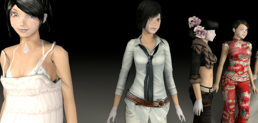

In the image below, the figures are from a model downloaded from 3DWarehouse in Collada format and imported, unchanged, into SH3D. As you can see, most notably in the hands and faces of some figures, object textures do not render correctly throughout. (Based on the way the failure behaves, I suspect the problems are ones that can be corrected by following the steps I lay out in my forthcoming guide to making use of SketchUp models in SH3D. Unfortunately, other issues with the model make this a more complicated process than usual ― especially when the version created by loading and exporting a native SketchUp object needs no modification to render correctly.)
Interestingly, when I attempted to import the 3DWarehouse's Collada model into SketchUp, a warning appeared saying the model could not be validated. The importation seemed to proceed without error; however, the resulting model retained no information regarding 'edge smoothing' (in practice, Gouraud shading), with the result you see in the following image: The model containing the nearest row of figures was created by importing the Collada-format model from the 3DWarehouse; immediately exporting it as, again, a Collada/DAE object; and importing this second Collada model into SH3D. During the initial importation into SketchUp, the model appears to lose all data influencing edge presentation, resulting in all edges being rendered visible, unsoftened, and unsmoothed.
This is presumably a SketchUp issue, as the same Collada file, when imported directedly into SH3D, retains edge smoothing ― as can aslo be seen in the preceding image, where the row of figures in the back belong to this directly imported Collada file.
Unfortunately, though, both models based on the 3DWarehouse's Collada-formatted object contain the surface rendering bugs mentioned earlier. Accordingly ― and supported further by the issues Dorin encountered ― it's probably safest to download objects from the warehouse as native SketchUp objects, load them into SketchUp, and export them in Collada format for later use in SH3D. Please note 'safest' here is a relative term: A vast number of models from the warehouse, on being imported into SH3D, will have textures fail in any of a number ways. Fortunately, virtually all of these failures can be prevented by a simple chain of processes implemented immediately prior to final export ― as documented in my upcoming white paper, "Using SketchUp-Originated Models in Sweet Home 3D," due imminently.
