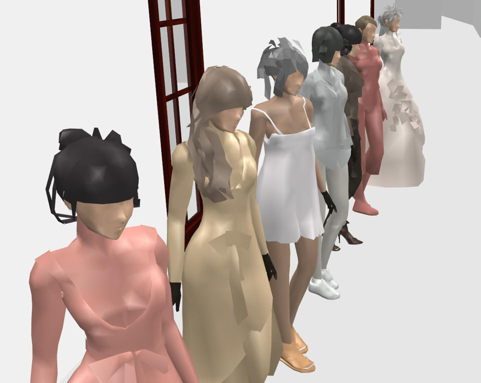

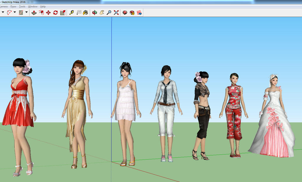

I downloaded a collection from the Sketchup Warehouse (I don't recall what the original name was).
I then opened up the collection in Sketchup (a demo of the current version).

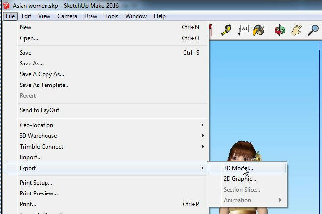

I then went to 'File > Export > 3D Model' and on the subsequent screen I selected the obj file type. I didn't change any of the default settings that are available under 'options'.
I figure I'm doing 'something wrong', I'm just not sure exactly what that might be.

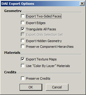

When I export to Collada (.DAE) format, these are the options I use:
You may want to check the texture map setting in particular and make sure 'export two-sided faces' is not checked. (I still run SU8 for a very good reason I currently can't recall, so I'm using the SU8 version of the model from the 3D Warehouse. I also couldn't locate a model containing all of the component models in a single scene, so I tested using a component model. You may want to test on a single model at a time, as well.)

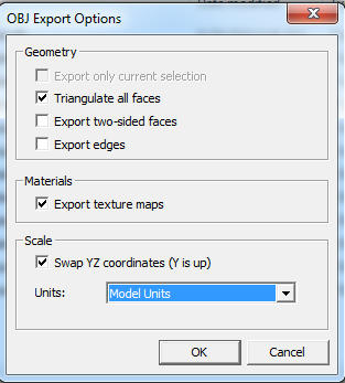

Below is how I have the options selected. Previously, "Triangulate all faces" was NOT checked. I checked it but it didn't seem to make any difference.
I exported using the .dae format as you showed in your post and it worked perfectly for the ones I was having problems with. I will try and stick to the .dae format for the other images and not use .obj anymore.

Your 3D models don't show any texture. Maybe you moved the .dae file without their textures files before importing it.
[Oct 3, 2016, 11:16:06 AM] Show Printable Version of Post    View Member Profile    Send Private Message [Link] Report threatening or abusive post: please login first  Go to top

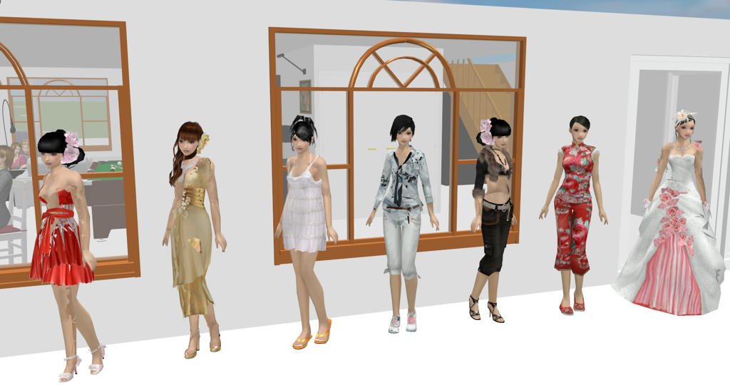

In my last post, I mentioned that the import using the .dae format worked perfectly. I just didn't upload a new screen shot for it.
Here is a screen shot showing the import from the .dae format. . .
I'm still learning Sweet Home 3d, but from what I have seen so far, I absolutely love it!

I guess I'm rather tired (it's 2:42am here). I just looked a little closer and the model on the far left didn't import as cleanly as I had thought. All of these were in a single collection and imported at the same time. I would have expected that they all have the same level of quality. However, the one on the far left and the one on the far right seem to have some texture issues if you look closely. I should try with some other character models and see how they do. Perhaps there is something 'odd' in the this character collection that is messing up the export from SketchUp? The export options I'm using are the same ones Mazoola suggested up above.
