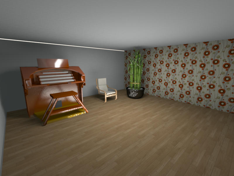

Post Count: 4000
Re: Photo rendering test
This is the result of a quick test of version 2. The level of illumination is now very usable as a kind of basic lighting.
Unfortunately there is a white line along the ceiling.
I think a way to set the lighting level is needed, preferably numerical (1-100?).
H
[Mar 16, 2019, 8:21:41 AM] Show Printable Version of Post    View Member Profile    Send Private Message [Link] Report threatening or abusive post: please login first  Go to top
