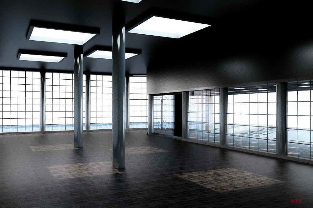

Here I have an image of my new project what I am working on... Heh... It's a little joke,because it looks like indirect light,but it's not true. My settings were PATH-0...but ENHANCED EXTERNAL BRIGHT...and in combination with sS-SILK and shining walls it looks like this... Sometimes you have to be a little liar if you want to have an image looking like indirect light... biggrin
and @Mike...your pics looks still better and better... I see you enjoy it.. I am happy.
Martin

@martin
Beautiful image yet again, i can see how an outside light source would "shine" through the large windows and onto the floor, but on the area just outside the main room the "shine" also appears square, i cannot figure that out sad

Hi miker.
There is nothimg spetial with that shining squares. There are upper windows there and its a normal sun shining through The results are...shinimg squares. It is not final picture. Just only experimnental rendering during the creative process.

Re: Photo rendering test
Thats me over thinking it again, mistook the roof windows for ceiling lights.
There will be roog windos there and on the lower rloor I want to give lights there
