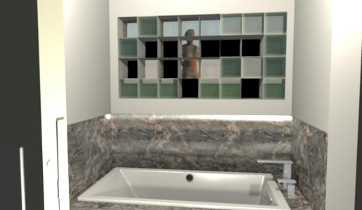

Actually, I probably could have lived with a chaotic upheaval of the basic rules of existence had I only been able to get them to fail dependably. Instead, the outcome of the render was incredibly variable, based on a range of factors I could never identify. For instance, when I took the texture used in the previous example and applied it to individual bricks in this 8 x 4 glass brick bathroom wall[2], this was the result:[3]
Ultimately, I threw in the towel and tried to find another way to fake it.
