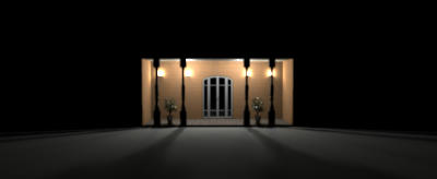

So, just to clarify, here is an image i made at 12:63 on monturday the 32/13/2017, beutiful clear weather and i was in the garden facing due south north standing on my head.
Mike smile

As my illustrations show, AM and PM gave the opposite results of what I wanted. The reason for that, was that my coordinates were set to China ( the bungalow-project), and I forgot to change the coordinates when I changed the time-zone to Oslo. I was thinking someone would point that out for me, although I already knew this when I posted, you know, presenting a problem and creating a discussion.
