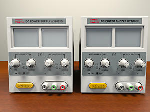

As you can see from the following Q4 render, the effects of downsizing the texture image are quite apparent in the finished model. In the render, the model on the left was imported using my hand-converted POT texture images, while the model on the right uses SH3D's default POT resizing. The loss of vertical information causes the distorted or missing horizontal lines.
